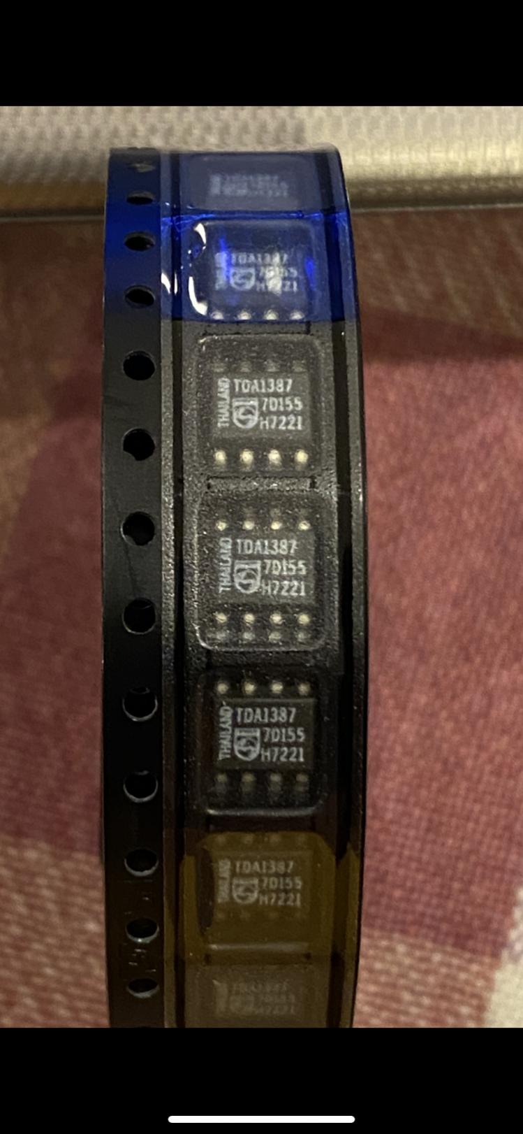

I'll need to order some more chips some time soon, we just have to take our chances
I haven't so far found any chips I suspect to be fakes but not every single chip works perfectly. I always check pin7 voltage with just power (pin4/5) connected - this weeds out many faulty chips (but not all).
They don't look dissimilar to the ones I have, looking promising.

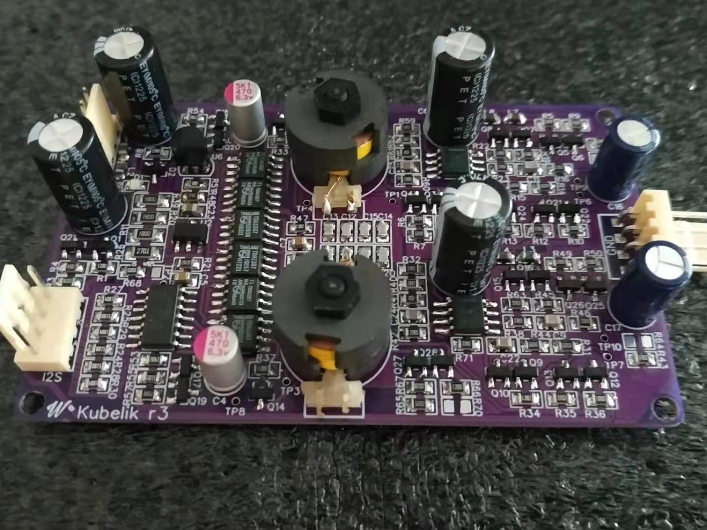

Built-up Kubelik

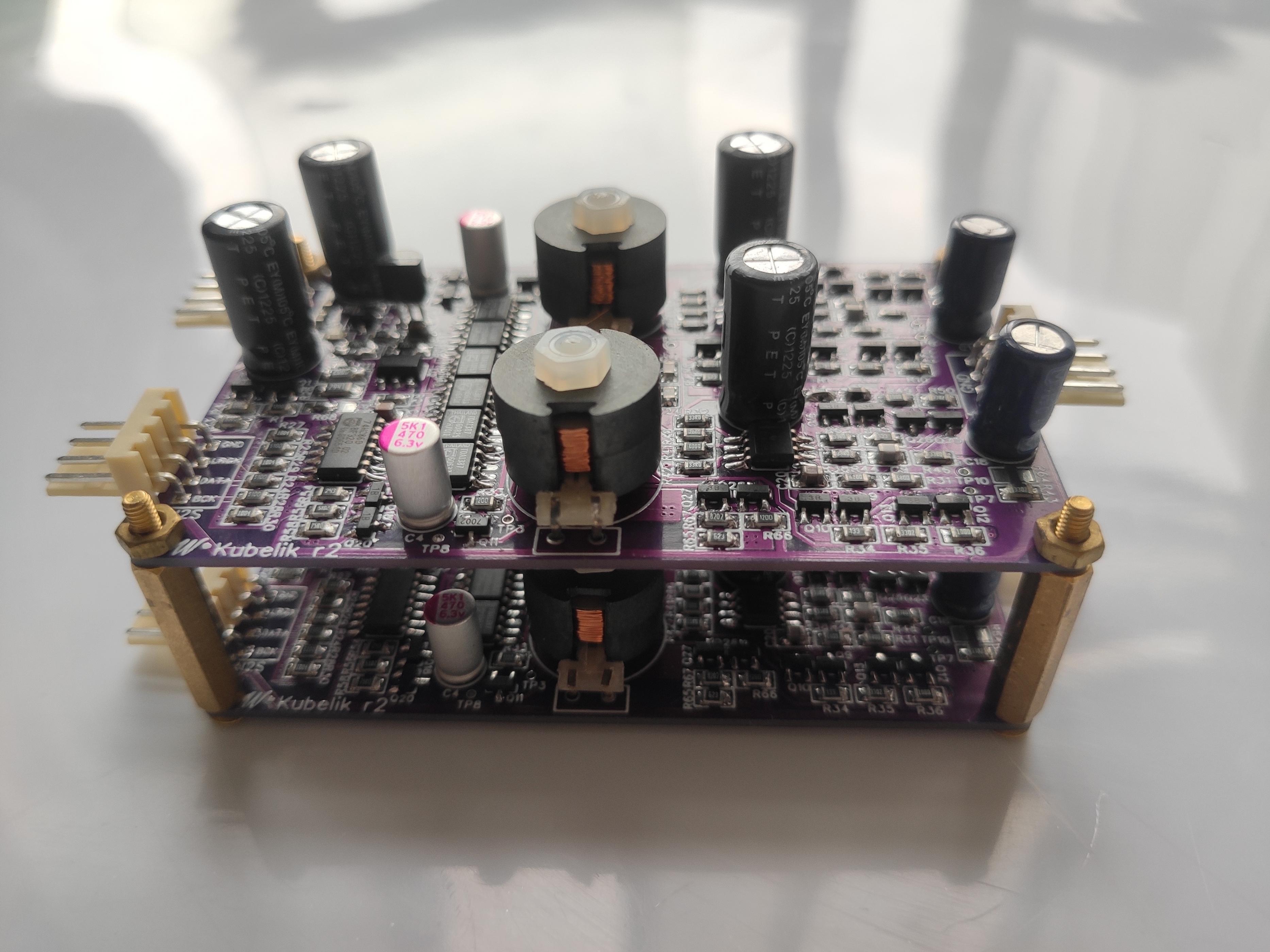

Here's the first r3 Kubelik built up which is the PCB revision for the kits. The height is 19mm which I've tried to keep as low as possible so they can be stacked. That way a balanced Kubelik is going to be under 40mm tall, with the right choice of spacers. As you can see in the 2nd image, which is made out of r2 PCBs.

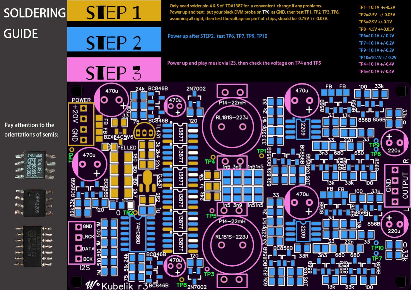

Kubelik soldering guide
Here's a graphic with TP target voltages to guide you through the build and test process for Kubelik.
You'll need a 20VDC power supply with at least 100mA capability.
In step1 (gold coloured) you put down the shunt regulators for the I2S logic and DAC chips, along with the mid-rail reference. Solder the 6 DAC chips last and only connect their power pins (4,5) at first because its possible you'll find a faulty one and it'll be easier to remove with only two pins soldered. Power up and verify the supplies for logic, DAC and mid-rail voltages. Then check pin7 voltage on each DAC chip, a faulty chip will have a large discrepancy from the target value. To complete step1, power down and solder remaining DAC chip pins.
Step2 (blue) consists of the rest of the SMD components. Only fit the 0R resistors at the outputs if you plan to use off-board coupling caps. SOT resistors aren't fitted. Fit the 2N7002 MOSFETs last as they're quite sensitive to static discharge. Power up and measure the 4 TPs on the right side which should be at mid-rail.
Step3 (pink) is the through-hole components - caps and inductors. The caps and inductors (if you have P14s) do need to be mounted the right way round. For the P14 inductors only two of the four pins are connected to the coil and those soldered pins should be innermost on the PCB. Mouser sourced inductors only have two pins and aren't directional.
Having completed step3, power up with an I2S signal playing and verify the offset voltages at TP4, TP5. If you want to gild the lily the offset can be trimmed closer to mid-rail with the SOT resistors.

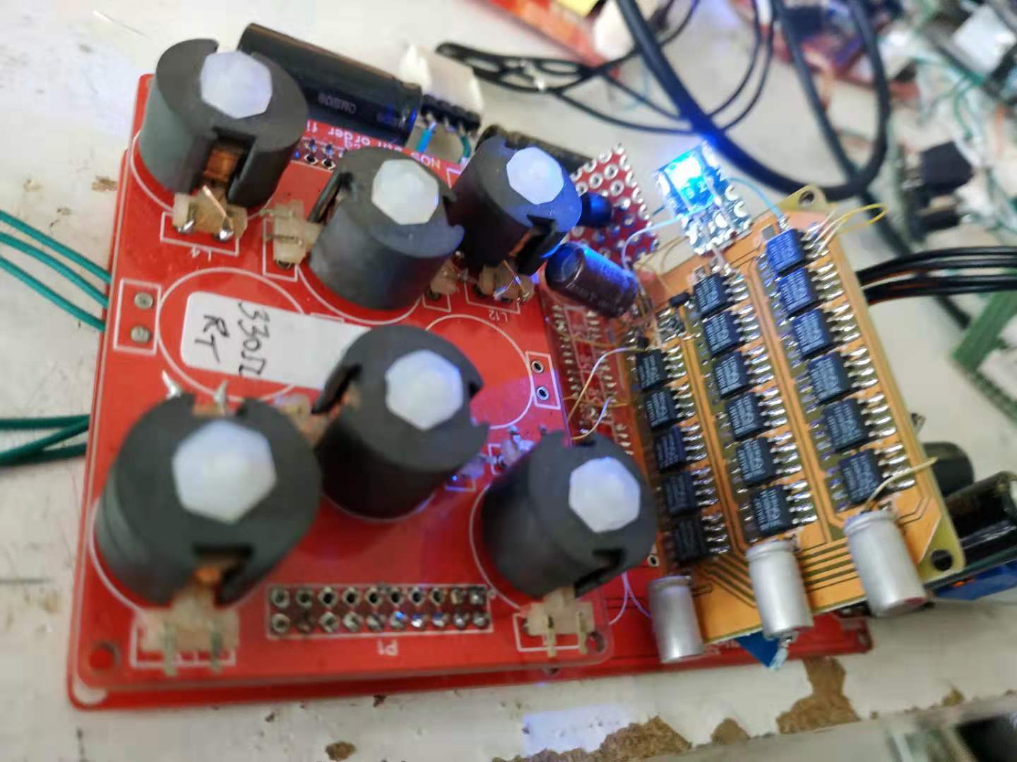

I think a better upgrade (though a bit wild to implement) would be to stack another 6 TDA1387s on top of the 6 already there and substitute lower noise opamps (maybe OPA1612?). This would also need an inductor change but should give a higher SNR.
To piggyback another 6 TDA1387 on the 6 that are on the R3 Kubelik, is there any change needed to the power supply rail parts on the board? The inductor change you are referring to is the P14? Any recommended parts for that?
Piggy-backing 6 chips will require quite extensive mods - the filter inductors and capacitors will need changing for example. I'm happy to work out all the new component values if you can get replacement inductors - they'd need to be 10mH.
It will be easier to start out just piggy-backing 3 extra chips and see if there's any change apparent. The mods then can be done without changing the inductors. For 3 extra TDA1387s you will need to increase the current feeding the DAC supply shunt regulator (U2, TL431). At present the DAC supply comes via the series combination of R11,R20 & R39 - these will need to be reduced in value so as to provide the extra current needed. But they'll then get rather too hot so probably better to change all 3 of them to a single through-hole resistor rated at 2W, 330R.
Next is to uprate the current sources which provide a bipolar current output from the unipolar DACs. The resistors which will need changing are R57,R58,R2 & R66. I need to run LTSpice to get the new values so will post these up in a while.
The other change is to reduce the I/V stage gain. This is set by R41,R61 - the new value for these is 750R.

The only downside I can think of for doing the 3 chip piggy-back is you'll lose the headroom for intersample overs. The 6 extra chip mod won't have that disadvantage because the inductors are changing.
Computer says R57,R58 change to 56R ; R2,R66 change to 91R.
