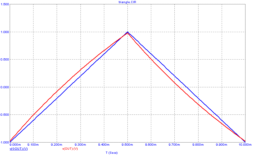

A CRO is an oscilloscope (Cathode Ray Oscilloscope).
The triangle waveform generator is a good idea. And it is easy to build a fairly good one. (Do a search at national.com for "tri-wave generator".)
To check linearity, you would want to make sure that vout/vin is constant, for all expected values of vin.
Checking linearity with a triangle waveform for vin is easy: If vout is also a triangle shape, the system is linear versus input voltage. But if the rise or fall portion of the output waveform is curved, or worse, then the system is not linear.
You would probably want to check that that is also true when vin is changing, for all expected rates of change of vin. The triangle generator would also handle that, if it had variable frequency as well as amplitude.

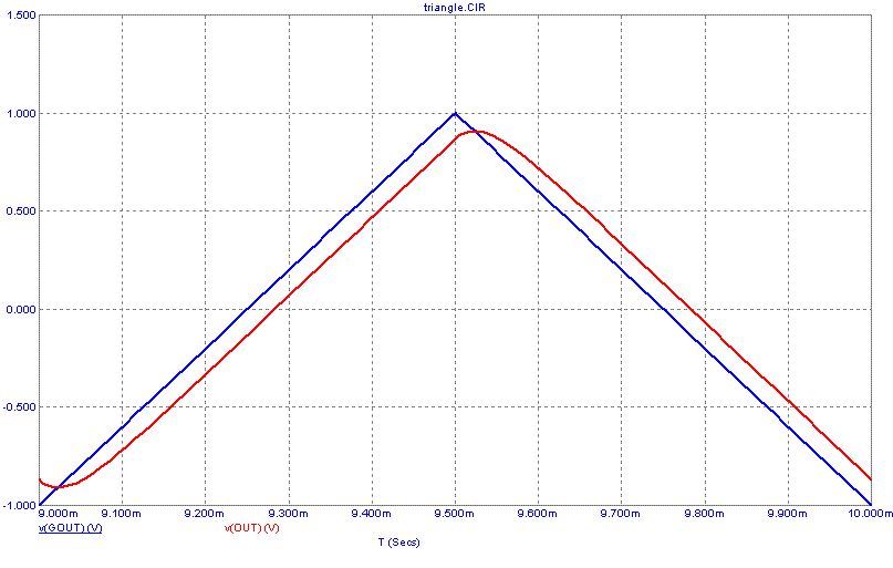

Should be said that depending on repetition frequency, the triangle may be distorted in shape, as no audio circuit works from DC to infinity. HF corner results in triangle corner rounding, LF corner results in a "bow" shape of triangle. It will work only for repetition freq. in the midband.
