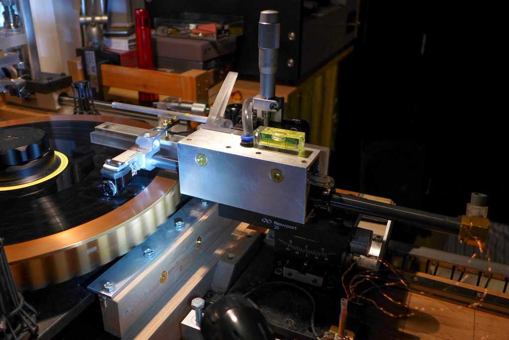

the captive air bearing is to the right in the metal block and the tube which the tonearm is attached to slides in the air bearing.

This seems like a 13 mm New Way air bearing. It is about $200 each in the States. However, the design in the video is not well implemented.
could you elaborate on that please.This seems like a 13 mm New Way air bearing. It is about $200 each in the States. However, the design in the video is not well implemented.
The arm in the video uses only one air bearing. It is not enough. The length of air bearing is 2 inch. 2 inch length may not be long enough to hold the shaft straight from most outer groove to most inner groove. I was told by manufactory that the pressure is evenly distributed inside of air bearing. But I always suspect that the pressure in middle of air bearing is higher than that at both ends of air bearing. Therefore, it makes things even worse.
The counter weight should be on the opposite side of shaft. However, this could be design dependent. To my experience, it is not desirable.
A damping mechanism is a must for all air bearing arms. There is no damping mechanism on this arm.

The main benefit of an air bearing arm is NOT frictionless, but it is controllable friction ( damping). Due to almost frictionless of an air bearing, you can control the damping to fit the compliance of a cartridge, moving mass and force interaction. For air bearing arm, frictionless is not a complete story.
For a mechanical linear arm, for example, ball bearing arm, it starts with certain level of friction. In other words, it sets a base level of damping already. You have to design all other elements, such as mass, weight distribution and force interactions to fit the base level of damping caused by ball bearing. It is a black box. The only way to get it right is trial and error. Even you finally get the optimal carriage design, it may still change. For example, the VTF changes on the Cantus arm. The difference of VTF can be as much as 2 grams. You loose control again. Bearing shatter is another problem. It causes irregularity of damping. Not to mention that all ball bearing designs can’t hold stiff pivot point while ball bearings travel. Air bearing can hold the pivot point so stiff but frictionless while it travels. Is there any medium better than that? I don’t think so. A silicone though can provide a consist and controllable damping force for air bearing.
Air bearing is the best medium, but it comes with a burden, i.e. noisy air compressor which keeps a lot of people away from air bearing arm.

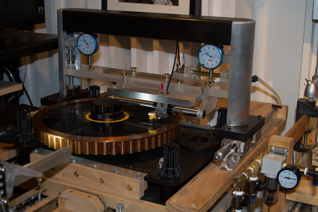

They don’t have hollow shaft. I use two 1/2” air bushings and bought a 12” long 1/2” aluminum shaft from
McMaster-Carr
I found a local machine shop to drill a 1/4” hole all way through along the shaft. The tolerance of aluminum shaft is not ideal but it works.
In fact, I built two air bearing arms. One is moving bearing(i.e. the shaft is stationary). The other one is moving shaft(i. e. bearing is stationary). I keep updating the arms. It has been two years since I built first version of air bearing arm.
If you want to build a air bearing arm, the first thing you need to think about is air compressor. Noise is the main issue. You can’t put the compressor in the same room you listen. I put mine in the closet. Also, if you want to build a moving shaft kind of arm. The compressor has to be at least 1/2 hp such as Silentaire, Super Silent 50-TC to have enough flow to supply to two bearings. This is the one I am using now.
