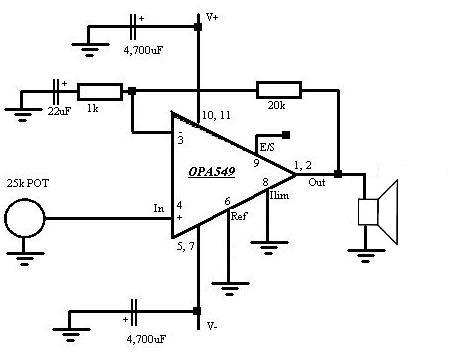

i want to build a gainclone with the opa549 chip. i did read a lot of threads. so it is
a basic nigc that i want to build. the gain is 21. i want to use a 25k pot.
i think i can leave the pin 9, it is the e/s pin, open.
i am not sure about pin 6 and pin 9, it is the ref and the Ilim pin. according to figure 1
in the opa549 datasheet (you can find it on page 8), i simply have to connect both pins to ground. right?
i hope that you can see my schematic.

If you use the inverting circuit you can use a SMD resistor in the feedback loop - quite easy to solder. I have this configuration with 220K. Input is 10K.
I am working now on a discrete regulated PSU for it, as described in Pedja's site, to see how it works. But 1000uF on each rail will do.
Ground the 6 and 9 pins to get it working.
