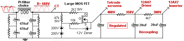

Hi folks. Does anyone have experience with this zener contolled MOSFET regulator?
I was wondering if this regulator works. I see all kinds of elaborate regulators like the Maida and Aikido, claiming low noise.

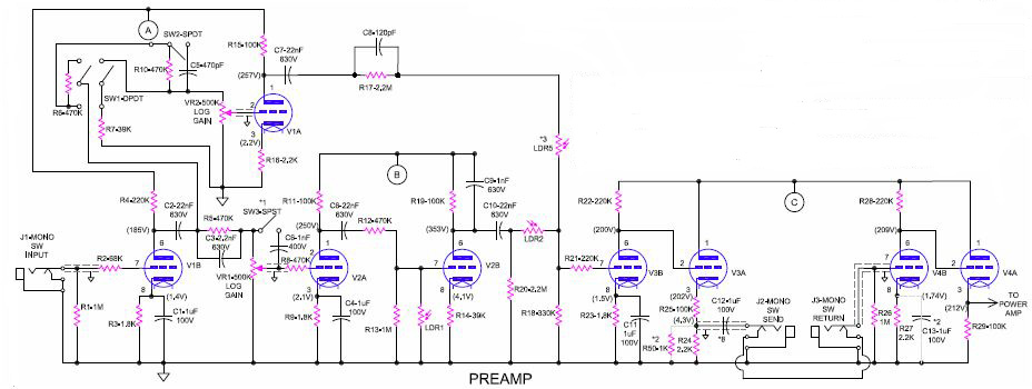

Also, my application is just 4 preamp tubes, so I wonder if that 2.2k resistor should be increased. Here is my preamp:

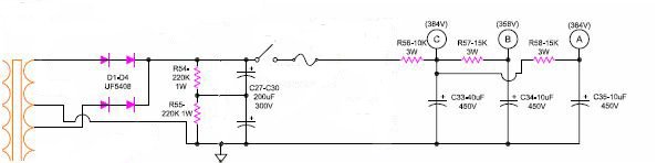

The unregulated power supply:
I had planned on a massive overkill 10A MOSFET, to eliminate heatsink, and also the lack of heat would keep thermal noise low.
Any comments welcome. Thanks.

Yeah, it works reasonably well and is rather reliable. Of course, with such a simple scheme, you mustn't expect miracles: regulation and ripple rejection will not be of the highest standard, but are probably sufficient for the application you have in mind.I was wondering if this regulator works.
With unbypassed zeners, the noise performance will be moderate; you could improve this aspect by adding a parallel capacitor, but then the circuit will not forgive any short at the output, even very short.
If you split the 47K and add a capacitor at the junction, you will greatly increase the ripple rejection without adding a safety penalty
You have to figure out the total current drawn by your preamp and see if the regulator still has enough regulation room.Also, my application is just 4 preamp tubes, so I wonder if that 2.2k resistor
The best method is to build it and decide later, by measuring the actual dropout voltage
A small or big MOS doesn't change the amount of heat generated. The temperature will depend on the Rthj-a, that's allI had planned on a massive overkill 10A MOSFET, to eliminate heatsink, and also the lack of heat would keep thermal noise low.

I got you on the series drop resistor, but not completely on the thermal situation. I am concerned with thermal noise, but not sure if its a factor since all the resistors are metal oxide. They are over-rated and the reservior capacity is liberal.
Like this?If you split the 47K and add a capacitor at the junction,

YesThank you so much.
Like this?
On thermal noise, I don't think it will make any difference compared to background noise, but this is an informal opinion not based on any quantitative aspect, even back of an envelope calculations so I may be wrong.I got you on the series drop resistor, but not completely on the thermal situation. I am concerned with thermal noise, but not sure if its a factor since all the resistors are metal oxide. They are over-rated and the reservior capacity is liberal.
Metal oxide resistors are not particularly good for noise. I know they are favored by many audiophiles, but from a purely objective perspective, they are now rather low-end.
Anyway, relying on purely passive means for ultimate filtering is probably the best option whenever possible.
Good capacitors generate no noise, non-linearities or other funny artifacts, unlike active circuits even the best ones.
