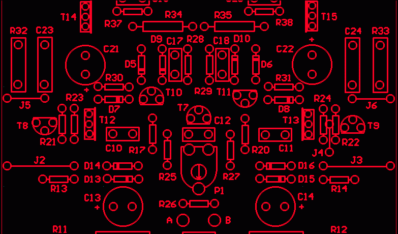

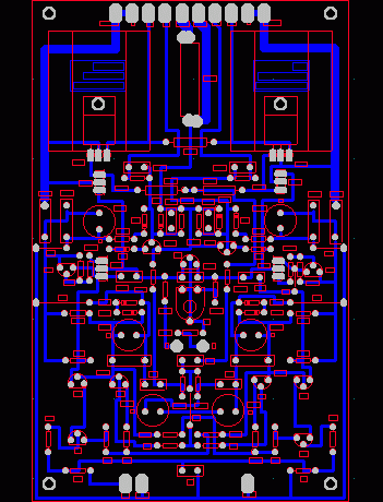

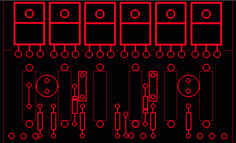

Hello,
I designed the main board.
I will not make the boards for the Leach amp,
but I have the PCB layout for it.
Here it is if it can to help someone.
It is main board.
It is finished, but there is no partlist.
Don't e-mail me as I also don't have it.
Try to use schematic to locate each part.
It is no hard to do this, but is little time consuming.
Also, take attention about e,b,c on the TO-220 / TO-126 cases.

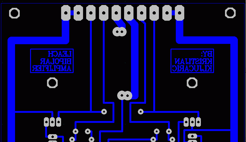

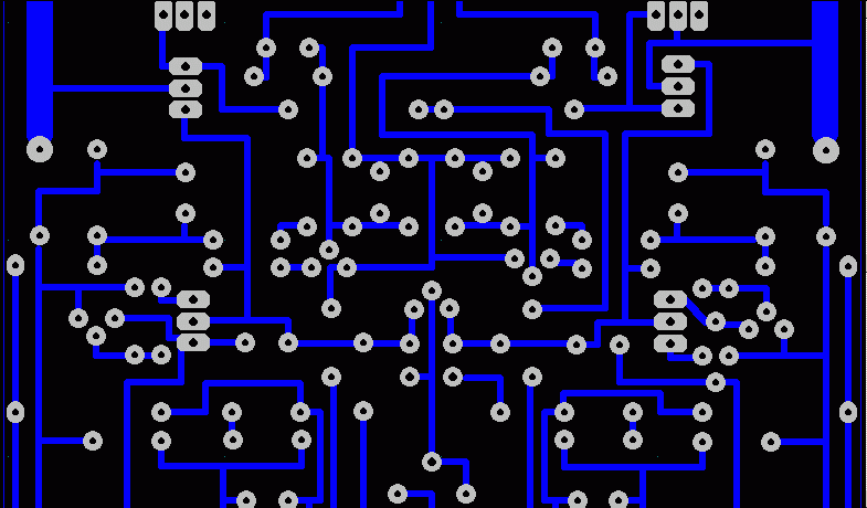

For those that can't read the Protel, here are the pics:
Note that the ALL pics are taken from the TOP WIEW of the PCB !
Best regards,
Kristijan Kljucaric
http://web.vip.hr/pcb-design.vip
Top + Bottom layer :

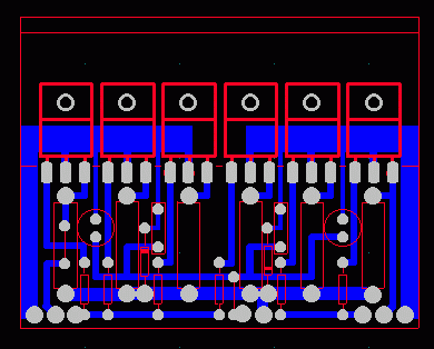

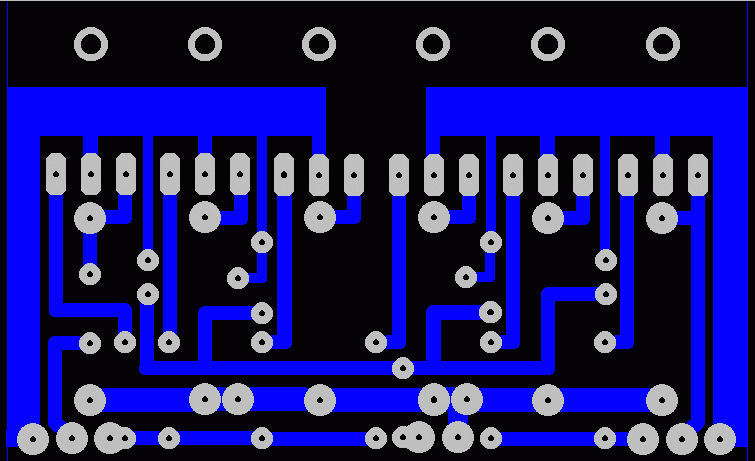

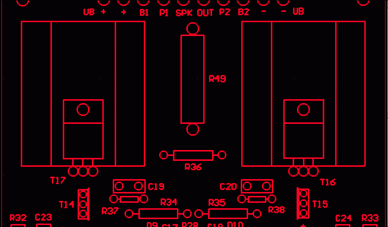

And here is Protel .PCB file of the output board :
