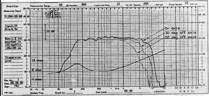

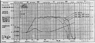

TBH, Erik, I always read Marshall Leach with interest. He belonged to the old-fashioned school which said that even the lousiest driver could be equalised into shape.
I'm not sure it's true. The Vifa P17WJ is occasionally still available. But I don't much like 6" bass.
Once upon a time Vifa produced a driver (The P13WH) which was flat and musical. Lynn Olson grew a reputation on employing it in an MTM, aka The Ariel.
I give you the FR below. But really, if I lived in the States, I'd use the Aurum Cantus 5 1/4".
We just have to find a tweeter (or two) to match.
