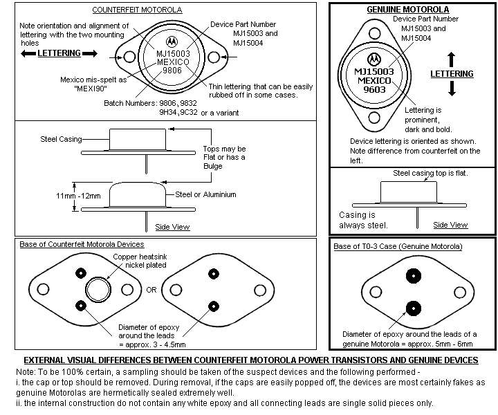

Counterfeit parts?
Sounds like what happened to my Leach Amp when I used (unknowingly) counterfeit MJ15003/4 output devices! Check the output and driver (Mj15030/31) stages.
After I've replaced my output stage to real MJ15003/4 devices, I can powercycle as many times as I like without problems...... except the dimming of the lights when the transformer powers up and charges the input caps......
Hi Magnus. Yes, counterfeit (ie fake!) devices. Check out the thread on counterfeit transistors. My counterfeit MJ15003/4 devices have printing that can be easily rubbed off (with a rough cloth), thicker base etc. See attached file that I've obtained from Dick Smith Elec., Australia.
Oops...... too large....here's the image, Magnus...
