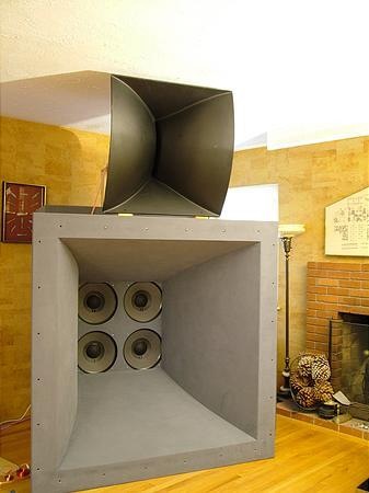

Hi guys,
Mssr. Serenechaos, yes I love them. Every day I hear more to like. The dynamics are astonishing. I will definitely see you at RMAF, and I hope yo ucan here /critique this setup after the show. I would love to hear your Tannoys!
GM, yowie, that is a big baffle. So those drivers need to be -low- Qts? Not high Qts? It definitely makes the bass horn options look compact by comparison 🙂
It's all about PRaT: pace, rhythm and timing. A horn adds acoustic loading, lowering the driver's effective Qts, or if a pure WG, it at least maintains whatever it is and since whatever it's mating to needs to match to preserve PRaT, the OB driver must have the same or correspondingly lower Qts.

Hi guys,
GM, that is fascinating. I have never heard that before. I would be psyched to try 4 low Fs, low Qts woofers per side. But as you say, at a certain point, a bass horn starts to make sense in terms of cost and size.
CLS, thank you very much! Your horns are really stunning. I saw your full system on the Multi-Way forum and it looks incredible.
These FLH's are really amazing. I thought "dynamics == loud" but what's striking about these horns is that they sort of "whisper" at you with very quiet sounds that get lost on my other speakers. I think I am listening at a lower volume these days, because the Azura's put out so much (detailed, clean, eerily realistic) sound that I don't seem to feel the need to crank them as loud.

Mightym!
I'm psyched you like the system. It sounds good but with some caveats.
The LeCleach fronthorn is unimpeachable. But everything else could use improvement. For example, the bass bins obviously require corner placement, so I'm in the process of switching them out for LaScala bins, so I can pull them closer together.
Also, I'm switching out the active EQ for first-order passive. But even then, the bass bins (and to an extent, the AER's) still require a healthy dose of digital EQ to get a flat, extended response (using a computer as the source). Still, it's worth the trouble and good to have EQ as an option.
So thumbs up on the front horn, but I'm also trying to design a BLH to get back to simplicity. It's hard to find that balance of simplicity and performance. Also, it's hard to -really- get a flat response without a measurement kit (obviously).

Hi bear,
I am in perfect agreement with your advice! Alas, the room is a shoebox and the Khorns can only go on the long side, and the seating is not ideal. So I'm doing the LaScala "ported mod" where you cut open the interior "doghouse" and then seal up the top chamber (where the squawker and tweeter used to be), then adding two ports.
I agree that nothing sounds quite as good as a horn. But my room is not great. The Khorns will go live down the hall 🙂

Hi Mightym!
I switched out the FE206E for the AER's. Very different sound. However, while the AER is brighter and crisper, I probably should have just tried rolling off the 206 and then using a horn tweeter. It probably would have been overall better in the upper octaves. But the AER with the stiffer cone has a certain crispness which is nice. Worth the extra money? I got them used so maybe 🙂
The only big defect in my system is that it's not all that horn-loaded, really. I'm depending on the Azura's clever trick of horn-loading just so much as to flatten the 8" (pretty much) so the upper octaves are just firing out of the horn (getting some attenuation). As Mssr. Serenechaos says, a horn is just "mechanical EQ".
The ported LaScala has been really popular and so I thought I'd give it a spin. In the old days, all I cared about was tone, but now, I really want dynamite imaging (in a very imperfect room). So I'm compromising in order to get the imaging, and while it will still go down into the 30's, obviously it's far, far less horn-loading than the K-horn type of bin. But at least it's still huge, ha ha.
Dang, your plans sound phenomenal and rather epic! And (unlike my random horsing around, your plans sound well-informed!) With the 200Hz size, perhaps you could do the full rollback? I wonder if Serenechaos will chime in (he's building a 5-way). He got a measurement system from Parts Express.
I am -super- psyched to hear about your Dallas progress as well!
