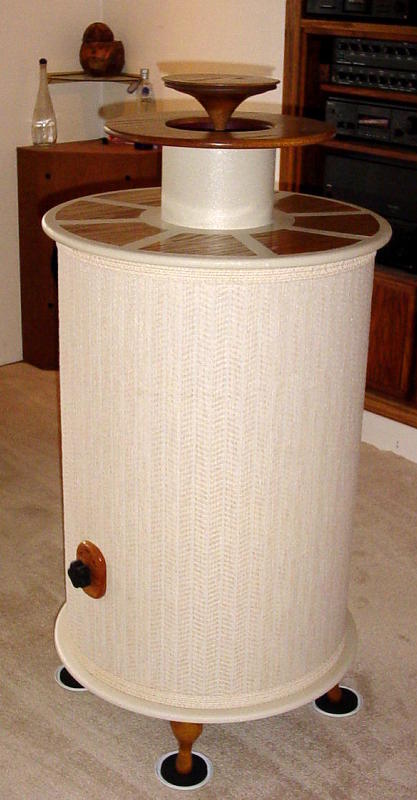

I used a 8" X 23" port for a Maelstrom Sonosub, needed that to keep the port noise down. The larger diameter the port the longer it needs to be for the same Fb. I like the sound of larger ports, they seem disappear better.
