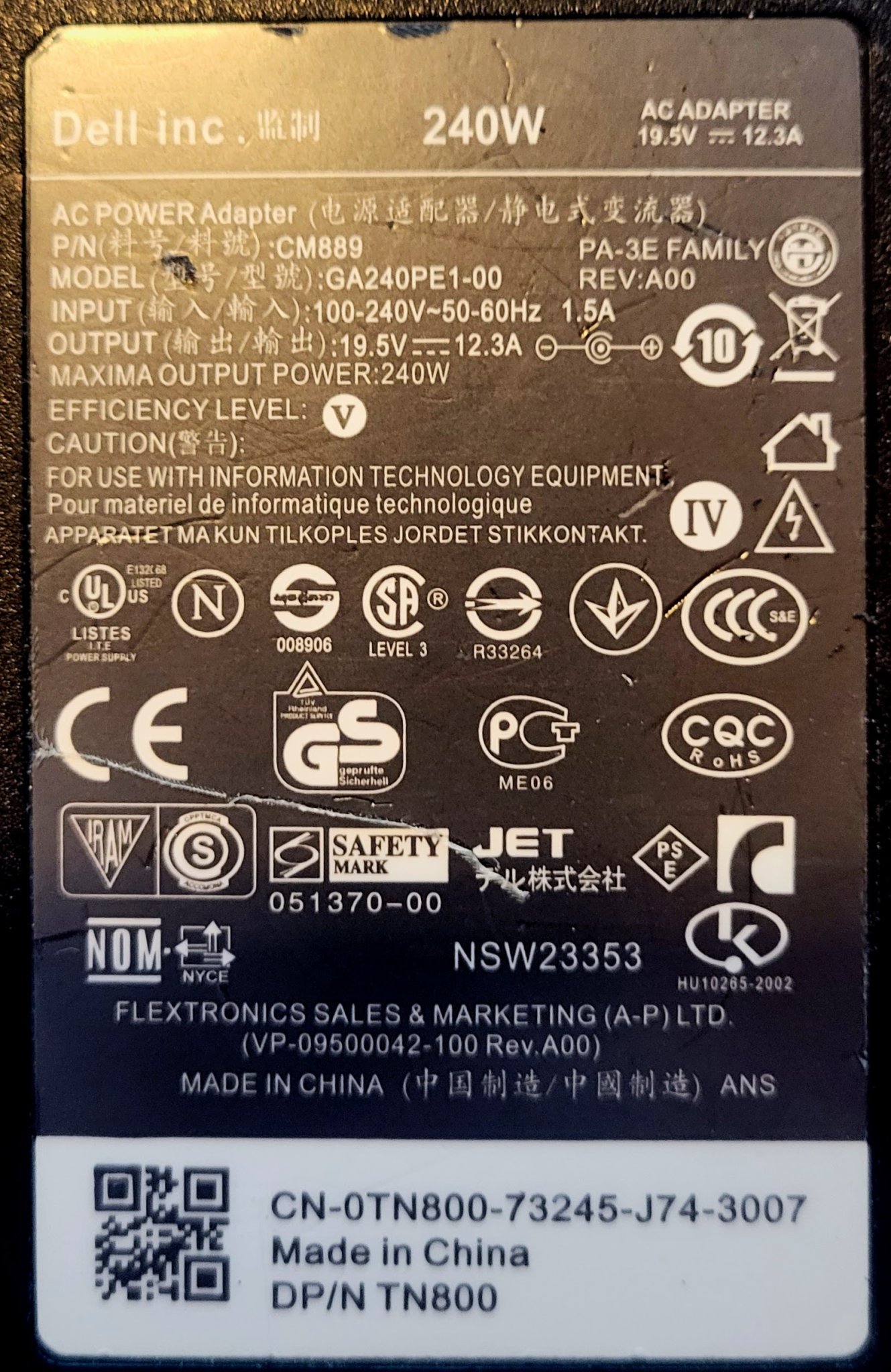

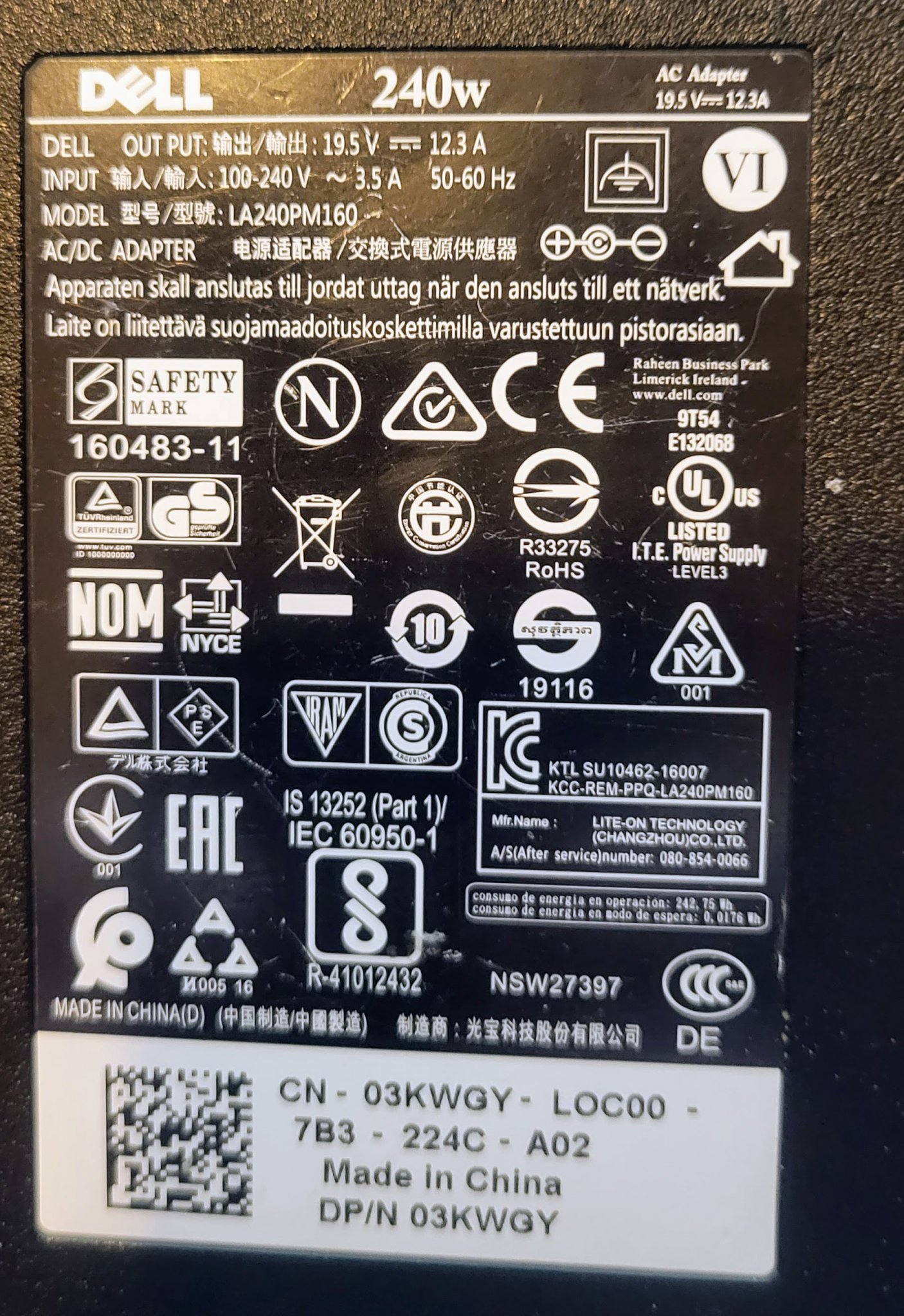

Your comment got me looking more closely at the labels. I have 4 of these power supplies, and was assuming they were all the same. It turns out that two of them, but not the one I opened up, have a Class II with ground symbol, upper right:The more likely reason in my view is that it was too expensive to build the supply to meet electrical safety Class II (double insulation), so grounding any metal the end user could touch became required. I would not simply cut the ground wire.
See if you can find a pair of Class II switching bricks instead. Mean Well makes some good ones.
Tom
And I measured no continuity from earth ground to negative! Looks like a viable negative supply.

The one that I was thinking of altering is different. It doesn't claim to satisfy IEC 60950-1.If the power supply indeed satisfies IEC 60950-1 (attached below) as claimed...
Though without opening it up, I don't see how you could shock yourself with it. 19.5 V is touch safe. A pair of these connected in an enclosure, one grounded only through the other, in combination with a GFCI, looks pretty safe to me. That said, an unaltered Class II supply is both easier and safer.
Yes, in that case, it may be better to use the IEC ones for the negative rail. Sorry for not following the story properly.The one that I was thinking of altering is different......an unaltered Class II supply is both easier and safer.
