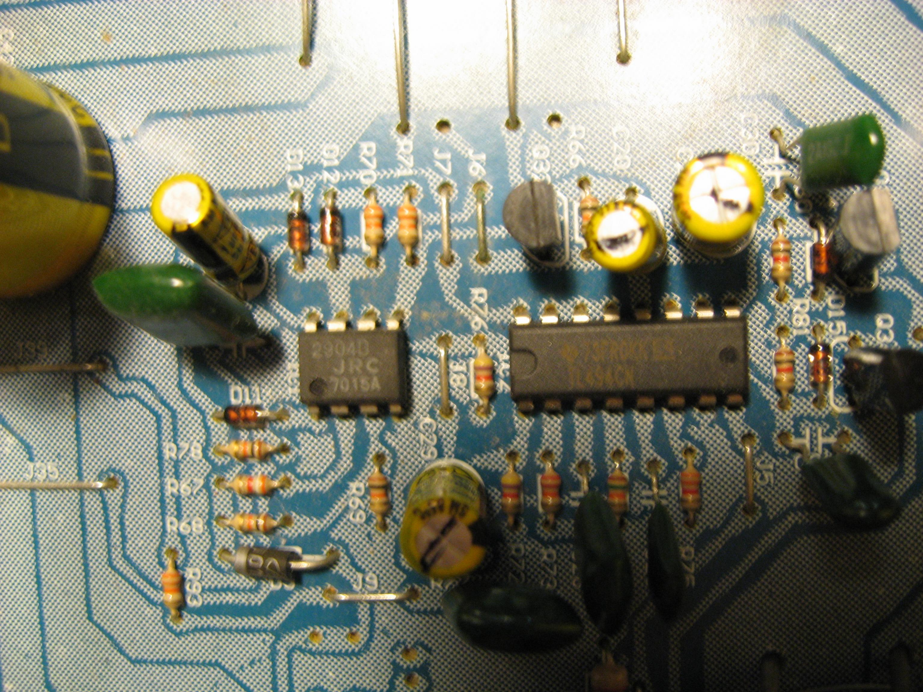

Post a good quality photo of the area around these two ICs.
Is pin 7 of the 2904 driving pin 16 of the 494?
Lifting D13 should defeat the protection circuit which should allow you to determine what's causing the amp to go into protection.

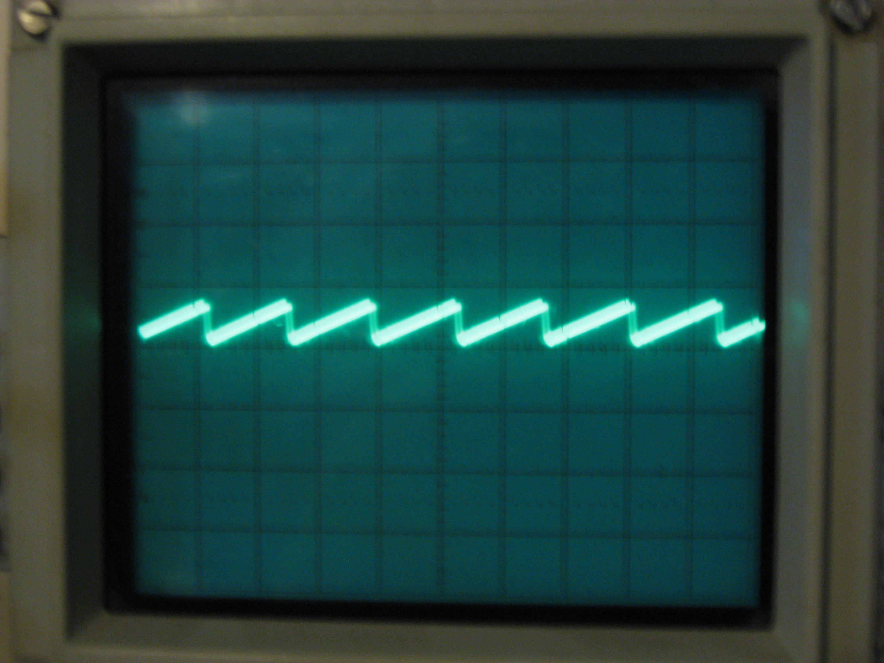

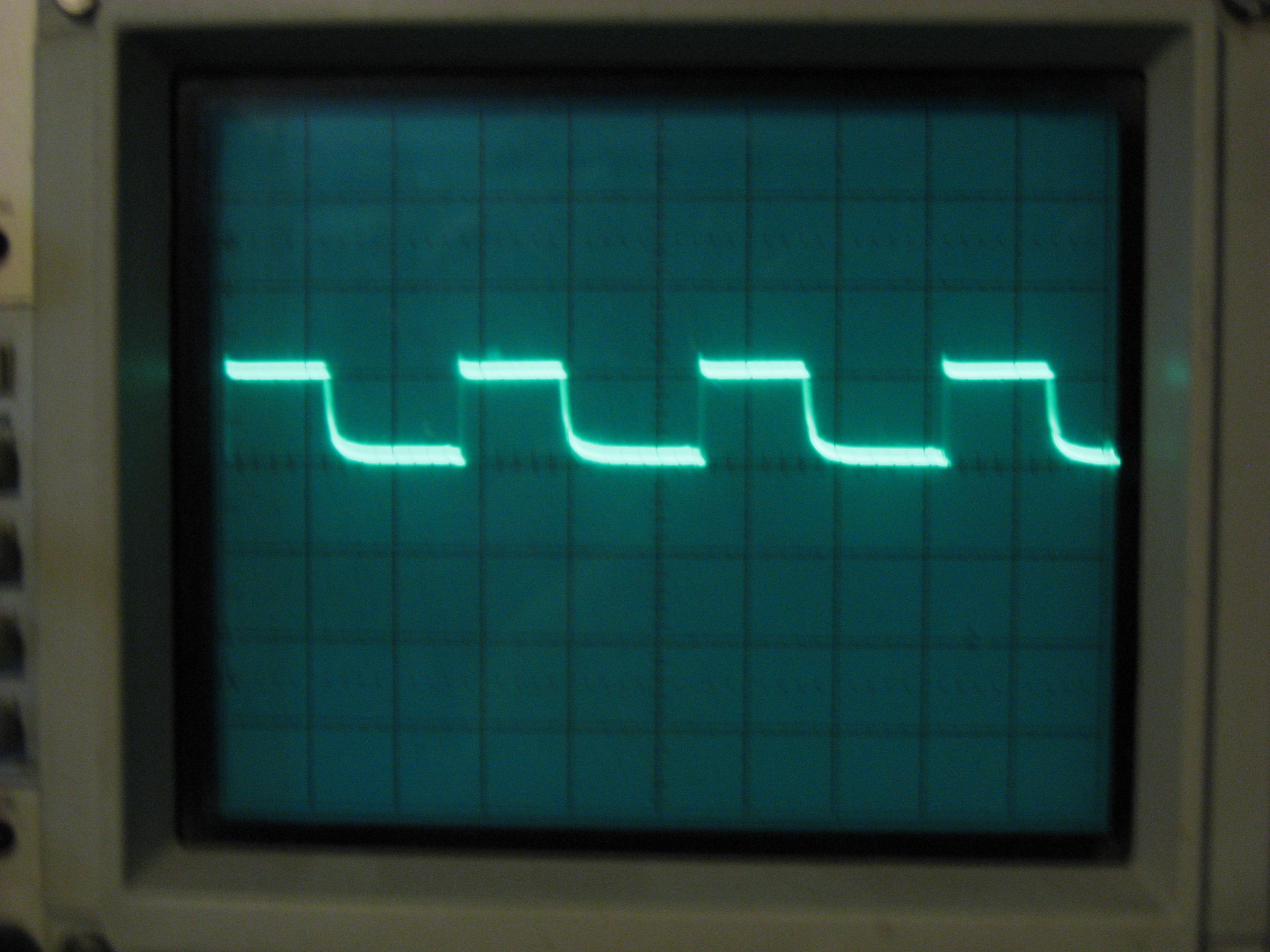

I now have both square wave on ps transistors and a clean sawtooth pattern. Pics attached.
I did check all the outputs in circuit. They def have high ohms and don't have any broken legs. Should I pull them all and check out of the circuit?

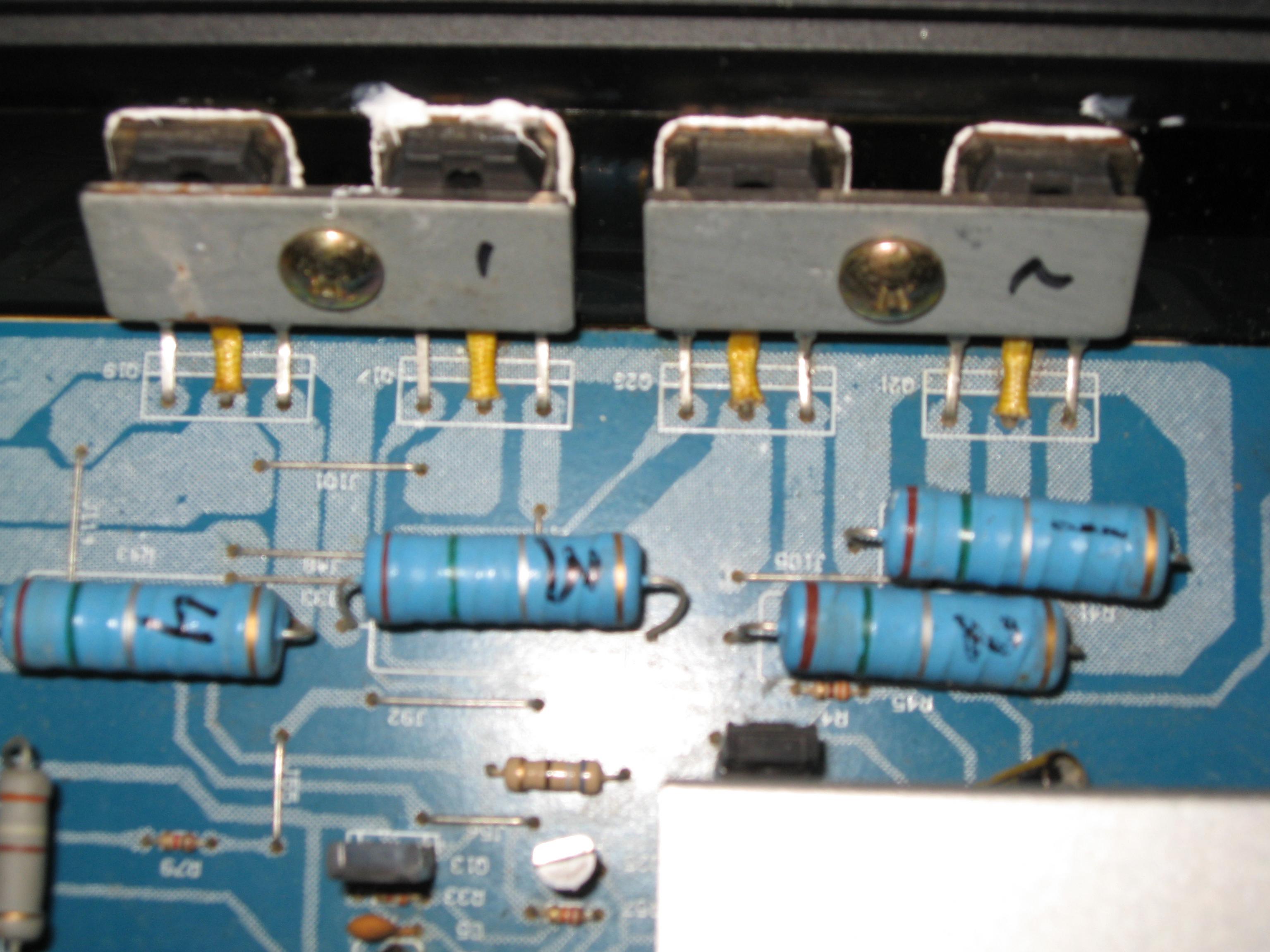

Can I use 3watt dale resistors for these? Or are these ones (please see pic) 5watt? These are the largest output resistors I've seen in an amp.
I use the FJA4313 and FJA4213 as subs for all transistors in this style case.
Are they defective?
The TIP transistors often require modification to the bias circuit to prevent thermal avalanche.
If the resistors are within tolerance, there's no point in replacing them.
They appear to be 5w.
Are they defective?
