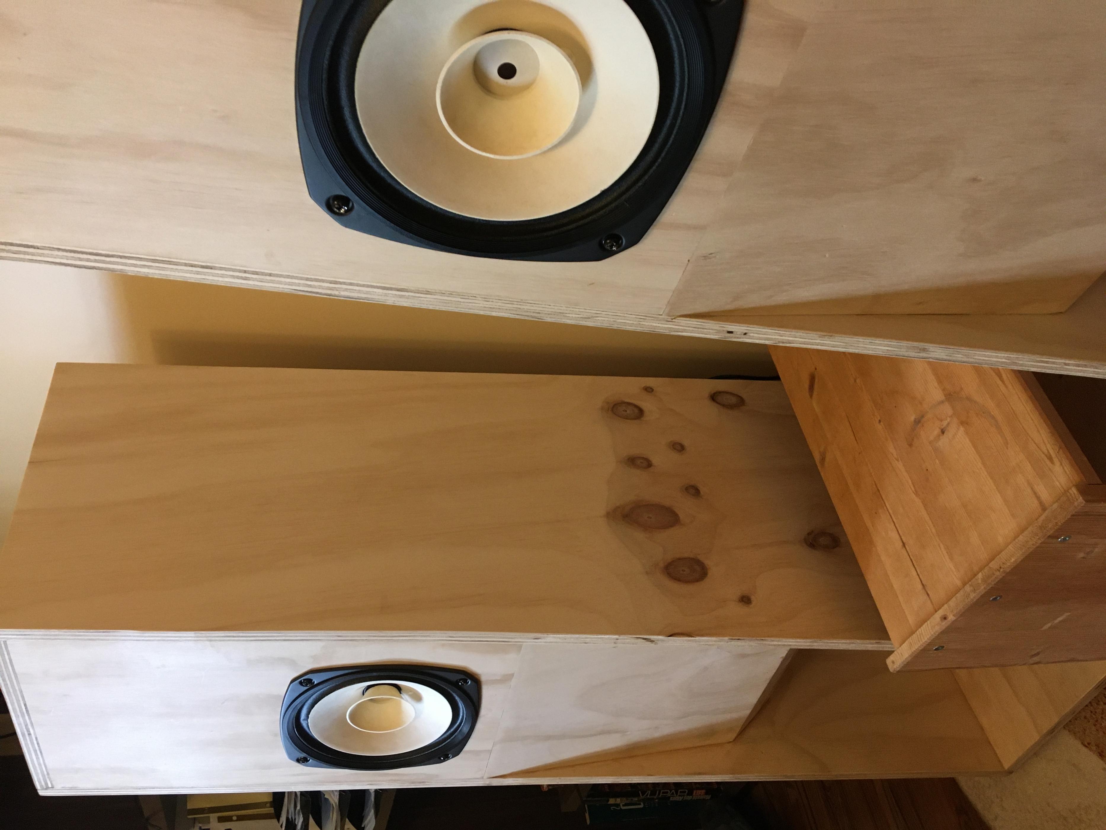

I have finished constructing a pair of the aforementioned horns and notice a lack of the low end.
I suspect it is due to one or several mistakes:
The front is angled while the back is straight (evident in the picture)
Perhaps, this directs sound from the speaker upwards and decreases the opening of the rear horn.
Fir instead of birch plywood
Terminals are duct taped, as I have lost the screws
P.S what is the ideal positioning of these speakers in a small room?
Thank you in advance,

Minor changes in the flare should not affect bass response.
Are your expectation realistic? A basshorn has less bass than a bassreflex box of similiar size. Leakage can lead to problems...

The Advent woofers & the alignment are completely different beasts and the speaker a 2-way with a crossover. An 8” is not that much smaller than the 10” Advent and the Advent woofer is MIA above about 2k.
The enclosure is a major element in getting bass gain needed to deal with the low Q and small linear excursion. But it is still a small horn and low bass will be very room and room placement dependent.
A couple questions: 1/ How many hrs on the drivers? 2/ What amp are you using.
A leak in the horn can have significant impact.
And fir is probably not as stiff as good plywood, but likely better than MDF.

This may be my first full range speaker, nonetheless I am hoping for a bit more bass.Minor changes in the flare should not affect bass response.
I thought the terminals to be air tight with duct tape...
Thank you,
About 50 hours
I am currently using a Raspberry Pi Digi Amp - 35 watts per channel
Not enough break-in hours for the FE166? And a digital amp isn't the best match (IMHO) for those drivers. You want something with a higher output impedance to warm up the mid-bass a little. Like a single ended tube amp.

OK. That is very likely a problem. The FExx6 drivers prefer an amplifier with higher output impedance than your amp does. If used with a low output impedance (as i strongly suspect yours does — no specs here Pi-DigiAMP+ - IQaudIO Limited). It will over damp the LF with the net result of lean bass.
The typical target amp for these are single ended tube amplifiers, but there are some SS amps that your speakers would be happier with.
You can fake it somewhat by using very skinny highish R speaker cables. Start with a pair of wires (24g) pulled from a solid core CAT5/6 cable. If that is not enuff try 30g wirewrapwire (it is kinda fragile). Worst case you could add a series resistor.

I have lined the speaker chamber with 1/8 inch (3.2 mm) wool felt, would this have implications on bass?

You need something behind to kill stuff coming back thru the cone. It is possible to put too much. Make sure the entrance to the horn is clear.

Just one more question to ask: does the sloping front side and the straight back side make a notable difference to the sound?
I thought that angling the driver up would direct mid and highs away from the listener, and the straight back side does not increasing the opening of the back horn as much as if it were sloped
PS. This way a oversight and the angle is 4 degrees.

Keep a 1" piece of wood or a book at the back edge of speaker box to tilt it forward
So that the driver fires parallel to the floor.
Then you could check your doubt about its 4' angle of the box.

Hello,
I am using a Fostex 206 En,
I am sure that the angle is 4 degrees.
Since the back side is straight, opening of the horn is not as profound as the schemes called for.
Thanks for the advice, I’m using spike feet so it may be difficult to rest a piece of wood or book.
