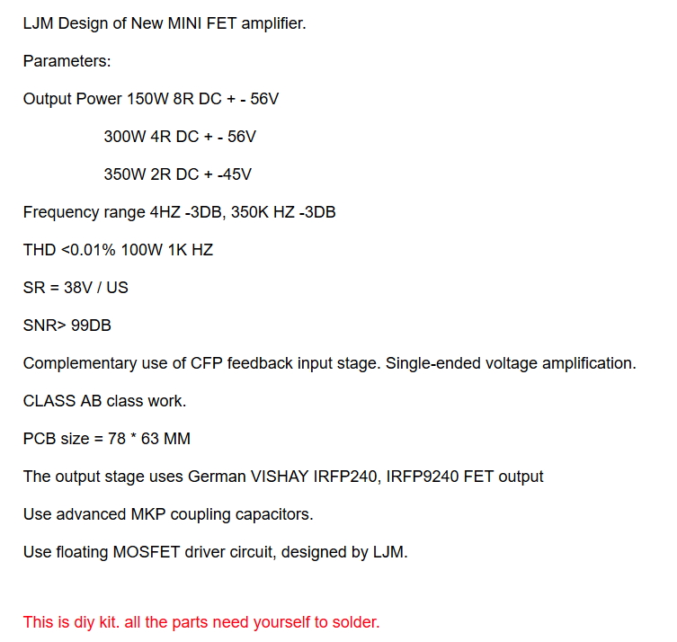

Very few hifi amps can survive 50W into 4ohms for an extended period of time , let alone with a single output pair and 55v rails. Just saying.
I can only agree.
Pls. see in the attachment what'sclaimed by the seller.
That's why I checked.

Measurements on the L7 0.3 % distortion by 50 w output.
Are you sure? I thought it was THD <0.01% 100W 1kHz?
With Output Power 150W 8R DC + - 56V, 300W 4R DC + - 56V, 350W 2R DC + -45V?
It reminds me of when I was younger and I bought a car audio amplifier which was rated at something like 300W on the glossy box. I took it apart and it contained two little 5 pin TO-220 chip amps.

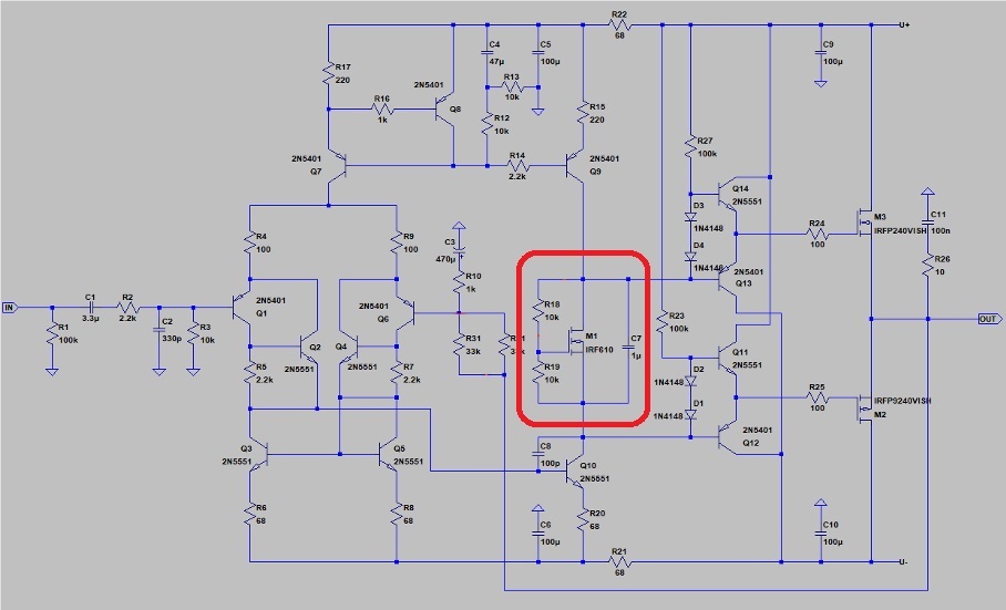

I have modified the L20.5 and MX50x2 to adjustable bias and that was easy.
For the L7 I suggest you find someone who has successfully modified it. With the reports of failures I am hesitant to just say "adjust the resistors on the MOSFET 'Vbe Multiplier'".
I have enclosed a schematic with the MOSFET 'Vbe Multiplier' marked. But I am not sure you should just replace the lower resistor with one size larger multi-turn (Bourns 3296W) trimmer. (Without first discussing with someone else who has done this on the L7 safely.)
When I replaced the lower bias resistors (on L20.5 and MX50x2) with a trimmer I used one size larger (2k to replace 1k, for example) and I started with the trimmer set to maximum (2k). Note that I soldered the wiper to one end of the trimmer resulting in a two terminal variable resistor. Others use a combination of a fixed resistor and a trimmer. I found one 3296W multiturn fit the PCB well and provided sufficient adjustment resolution.
I think I read somewhere that someone suggested a bipolar Vbe multiplier for better (thermal) stability but you need to discuss with someone with more experience. I have not gotten to my L7 yet. It is assembled but I am busy with the others especially after one of the MX50x2 boards incinerated. (The rebuilt one with very carefully matched components sounds very nice.)
I don't want to give you wrong advice so please search for someone who has figured the L7. When you do figure it out please post since I will need to adjust the bias on my L7 also.
