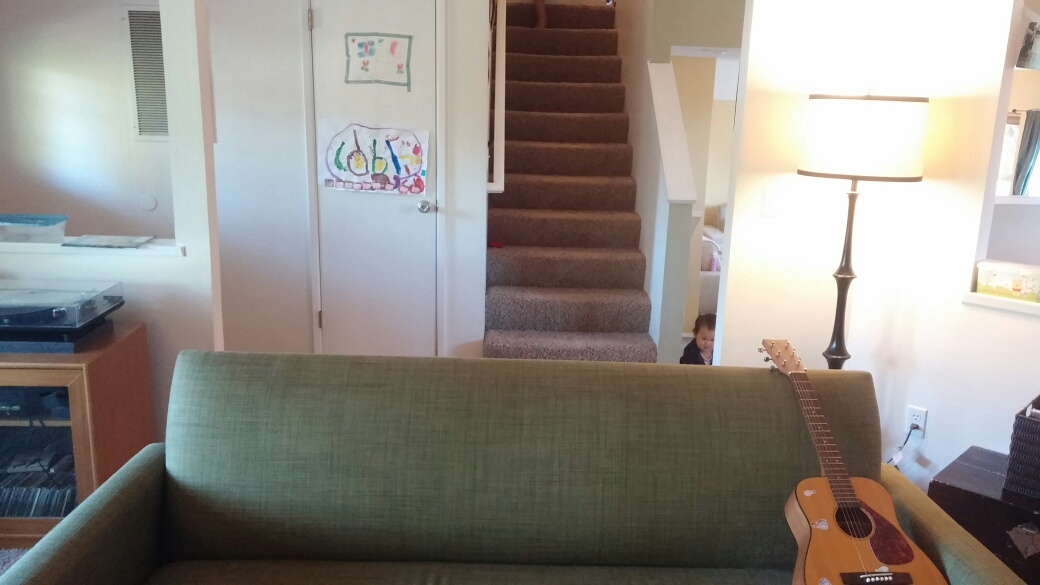

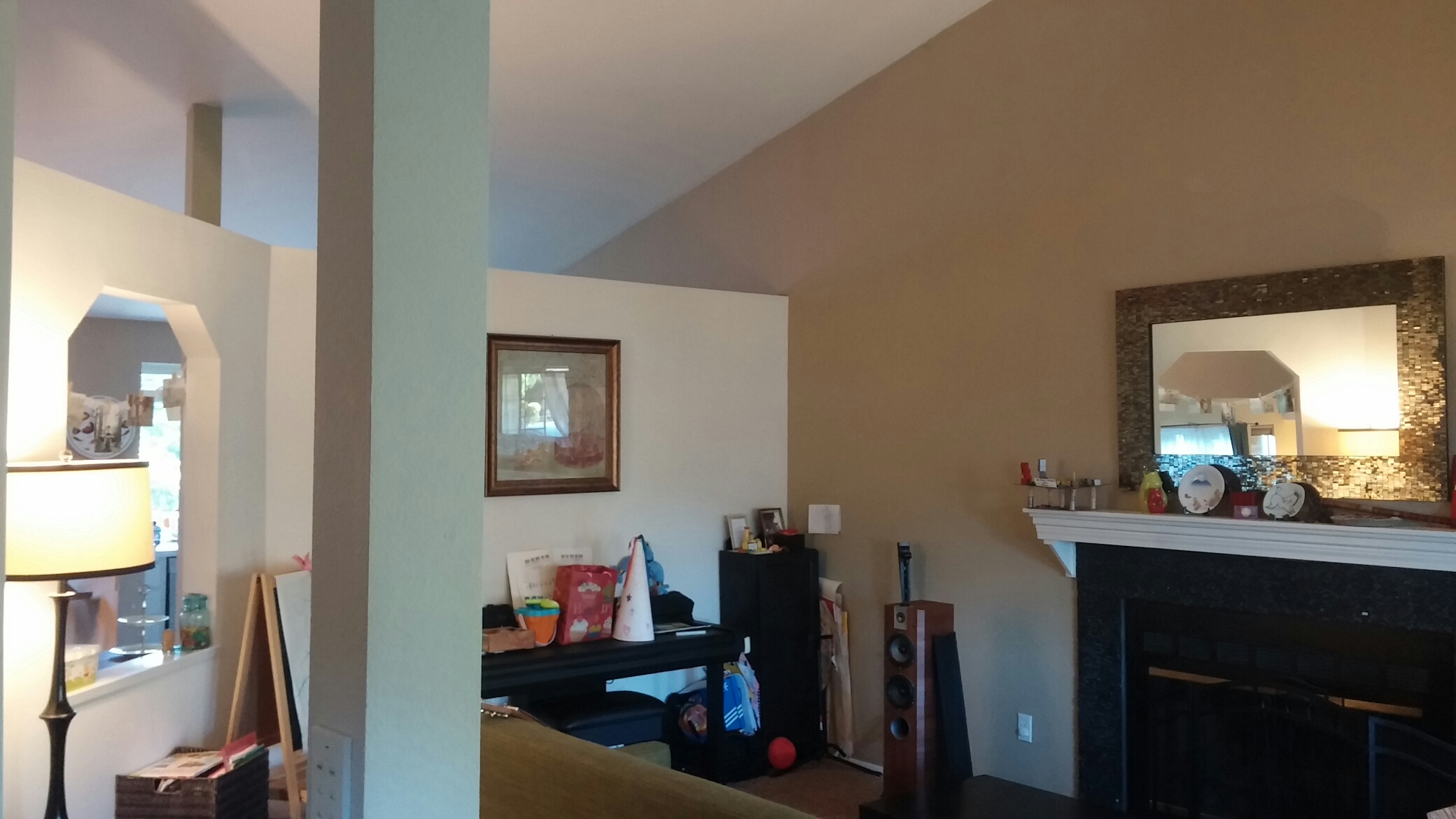

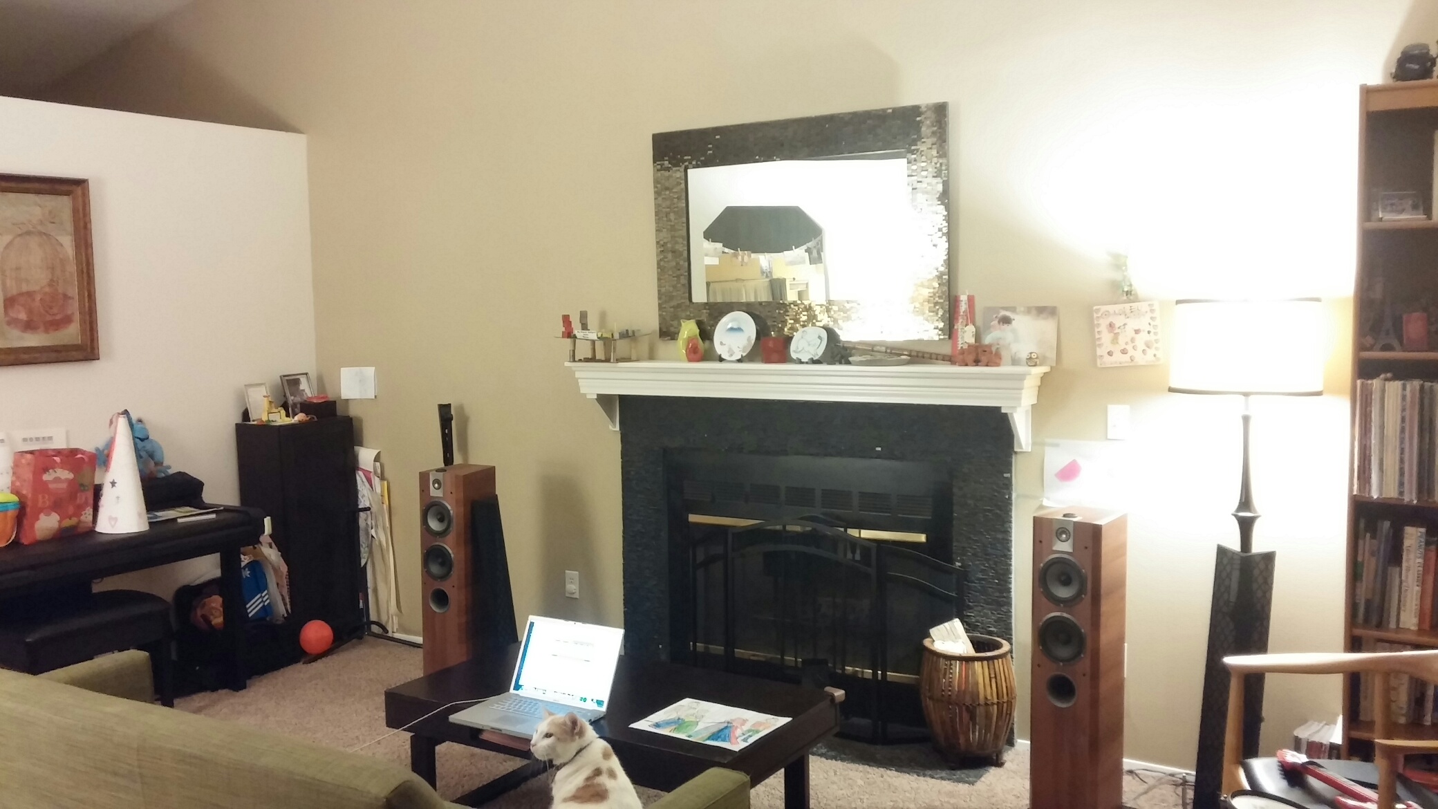

Behind the partition on the left of photo is that perhaps a reverberant room ie with little furnishing .How far is it from the right hand speaker to a wall on the right .
Yes, behind that partition is the kitchen. The right speaker is about 2m from the side wall, the left is a little farther...maybe 3m.
It's the left side (when looking at the speakers from listening position) that is louder. I believe the space behind the half wall on the left and the corner of the room to the left is creating this. I just experimented placing a small mattress around the room. It was interesting.
When the mattress was placed in the left corner the balance got better. When placed on the right side it got worse. When behind I did not notice much effect. Even with the mattress in the left corner the sound was still not perfectly balanced though.
