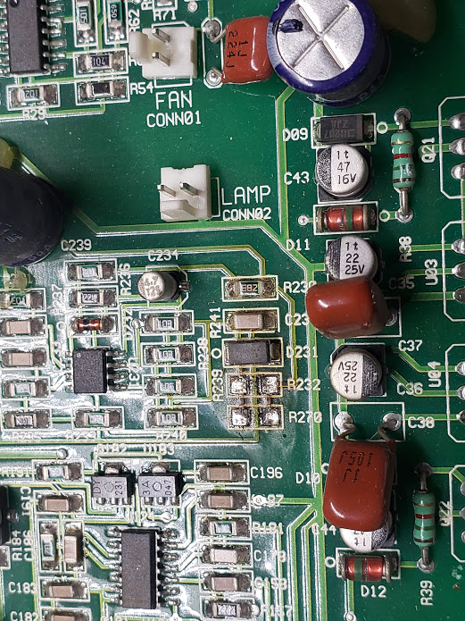

I can't offer schematics,Kicker considers all schematics proprietary. I can help with any issue's your having with this amp. What issues are you having? Post pics.
I will need to confirm but looking at the schematic and BOM the two resistors where
not populated. U231-LM393 and D231-BZG03C12 make up the over current protection.
What is the issue?
What is the issue?
