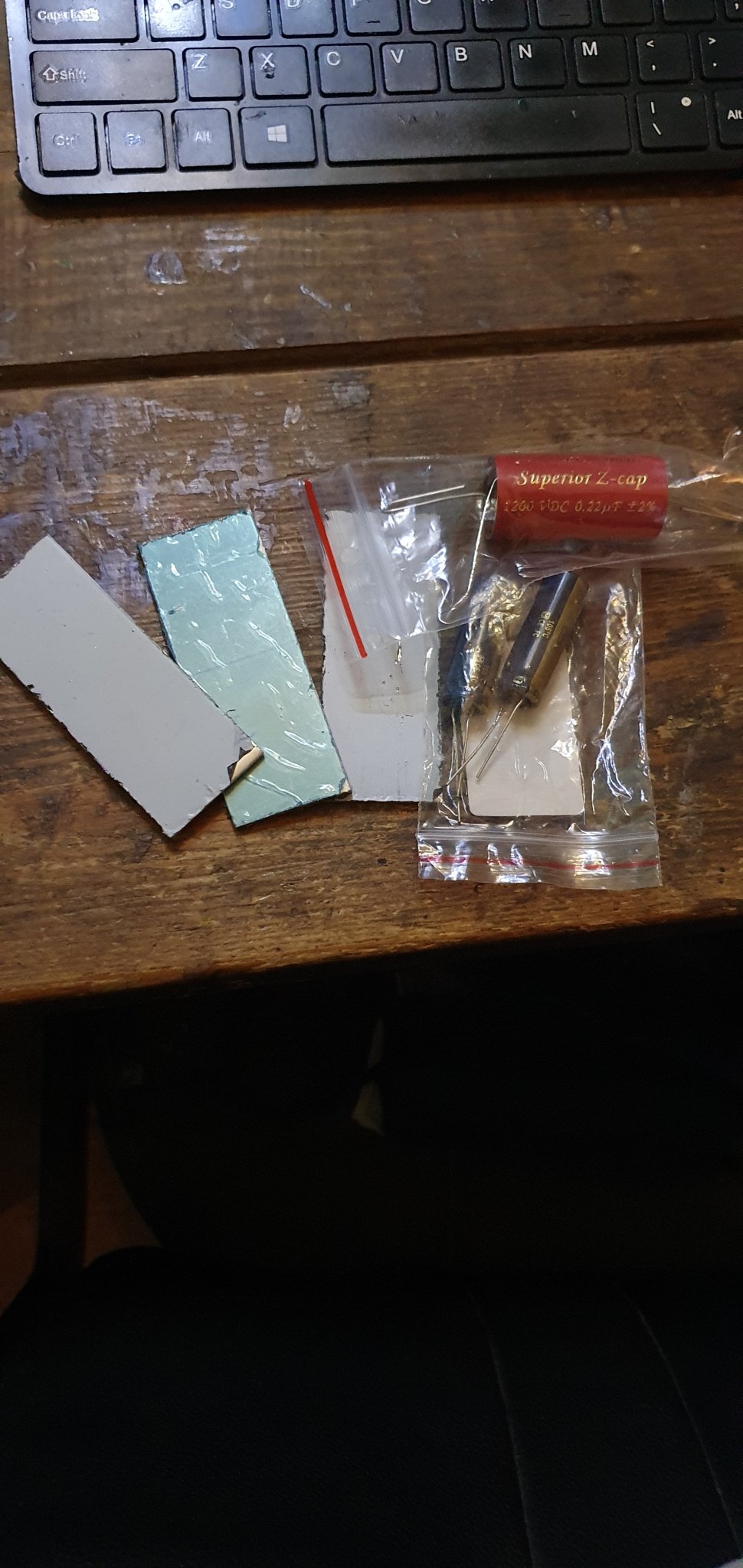

Thanks for the replies,
I'll order 50w versions, mount them on heatsinks, vented through the top panel. I've made heatsinks, as mentioned, I was about to the use them, have new coupling and bypass caps. Heatsinks are 3nr pieces of 30 x 80 x 3mm thick per resistor which will vent through 35mm diameter openings in the top plate (hope that will be enough)
I'm assuming the valves are OK but wouldn't both resistors be overheating at the same time? Or maybe thats a 'not necessarily'
I shall remember that wood is not the best conductor of heat in future!
