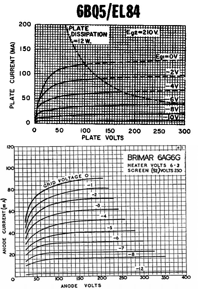

It should work like a charm if to connect cathode legs of 9 pin female and octal male socket by some resistor, I believe it should be 20 Ohm, but needs to be calculated properly. Also, an octal socket would have some space for bypass capacitor, if you want to shunt that resistor out (for PP amps I would not do that!).
