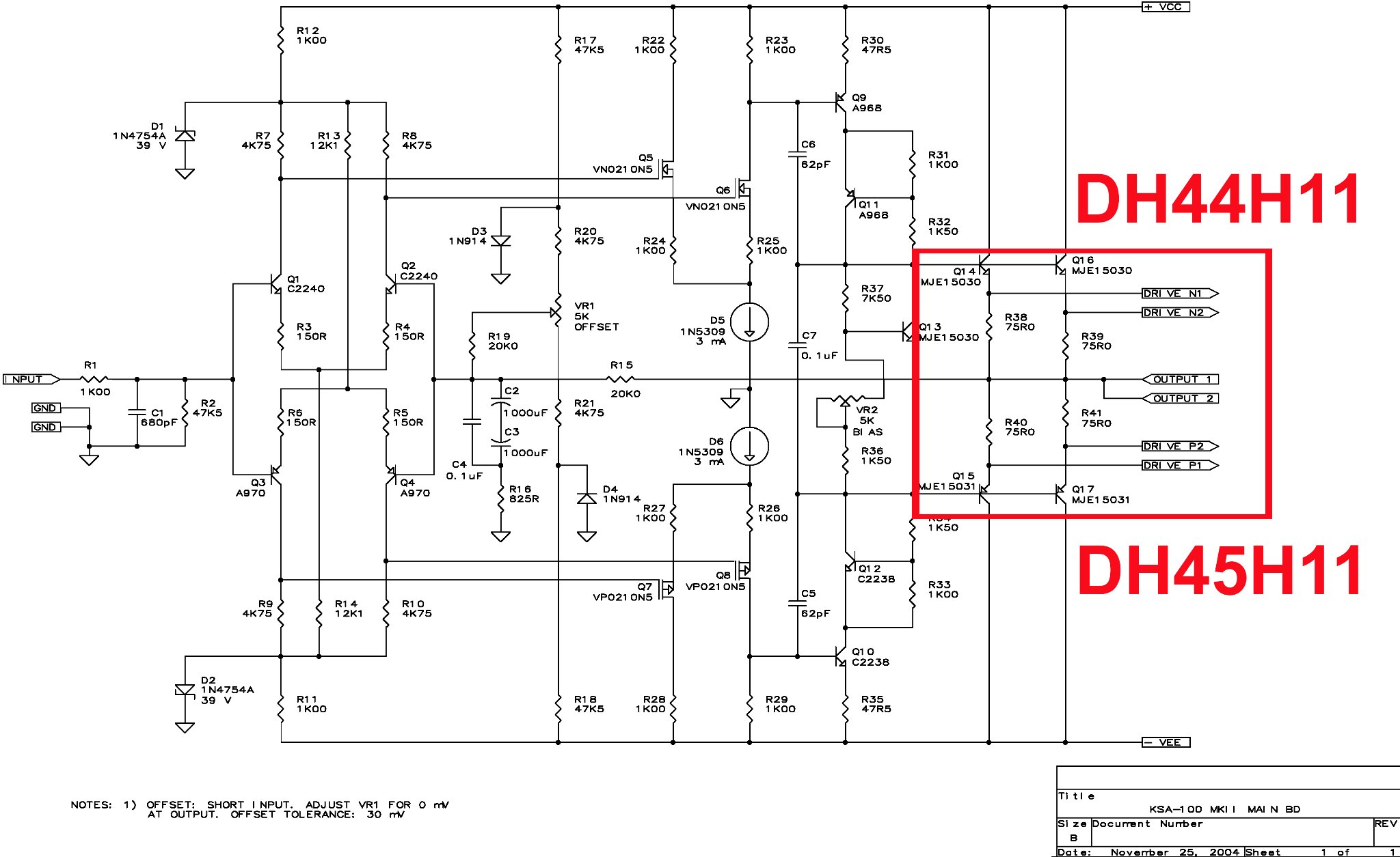

I have ambitions to build a variation of the KSA-100 MKII clone. I have a ton of parts and things to make it happen yet I am lacking a few hundred bucks worth of items that are on order or will be ordered soon. I guess, hell or high water I am committed to it. I want to make the best of it. I have received criticism for this decision. I may have to live with it and let it take its course as all things do. In an effort to move forward I would more than nothing desire a relatively somewhat functional LT SPICE model to go along with said project.

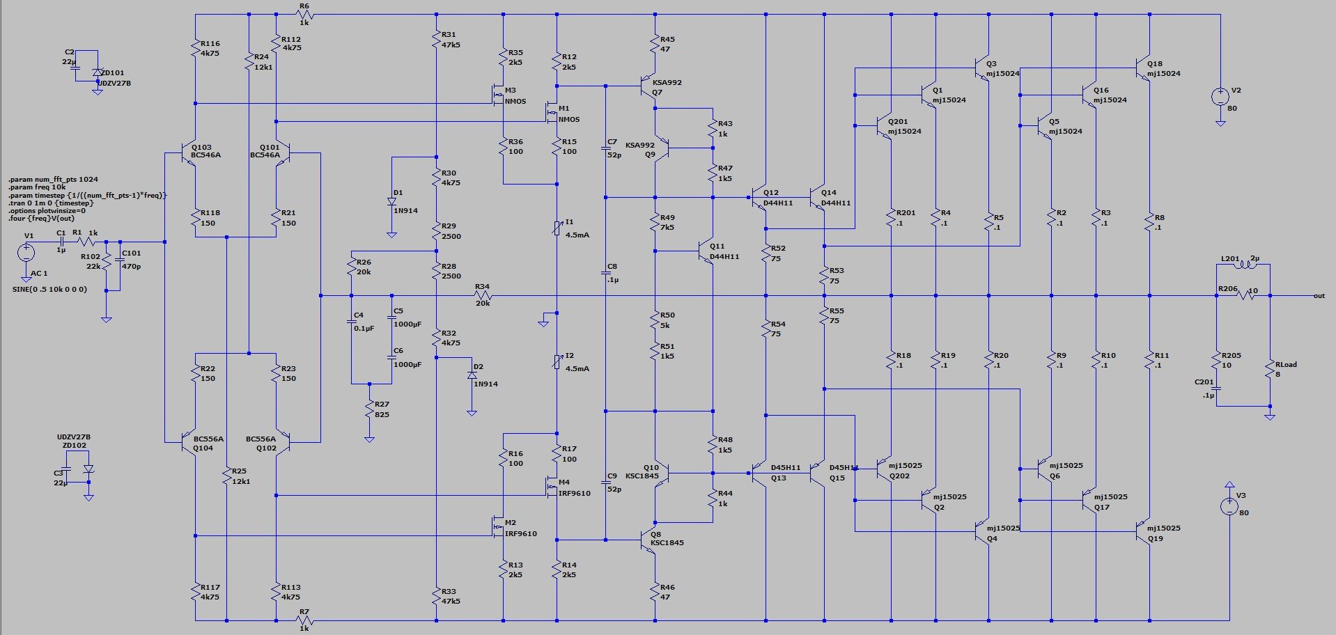

It is funny to simulate as it works so devastatingly bad. OMG it is terrible. Kinda makes me laugh and cry.
I require MOSFET models and help to implement them. Getting models that are relevant may be an issue. IDK.
If you people could look it over and give me some pointers, I will run with it and make the best of it.
I'm kind of lost at this point. I've been stuck here for a few days now.

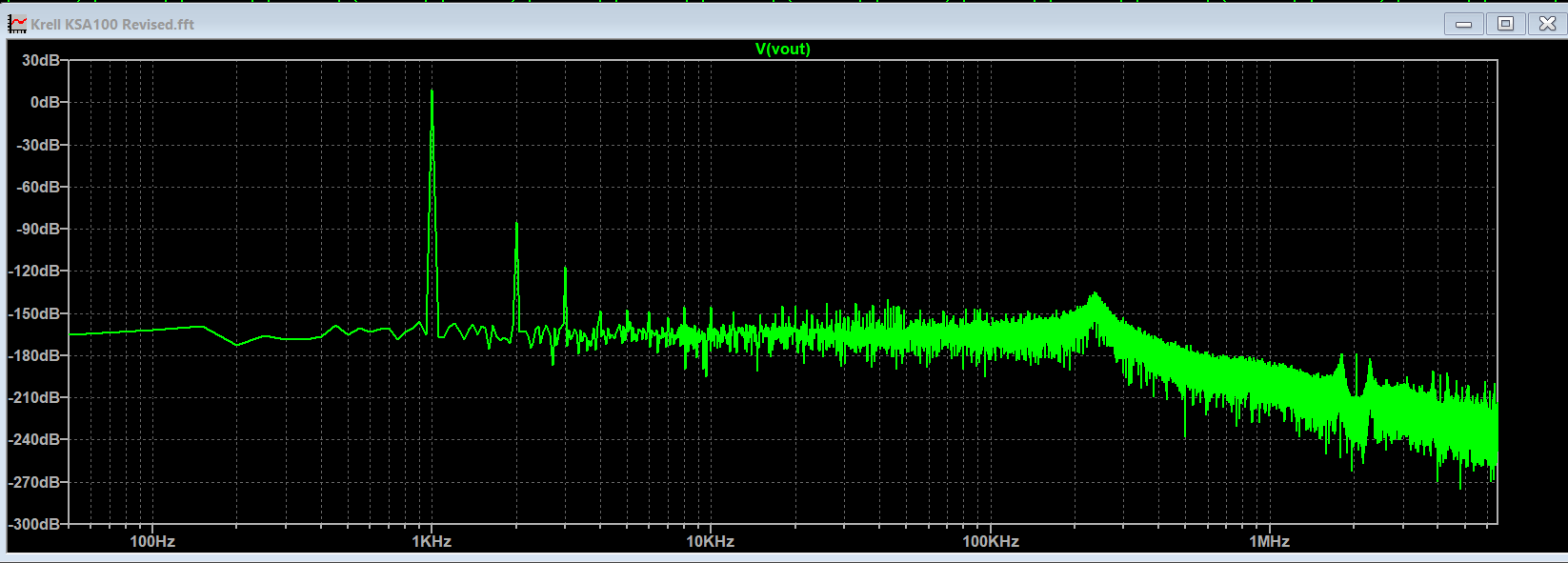

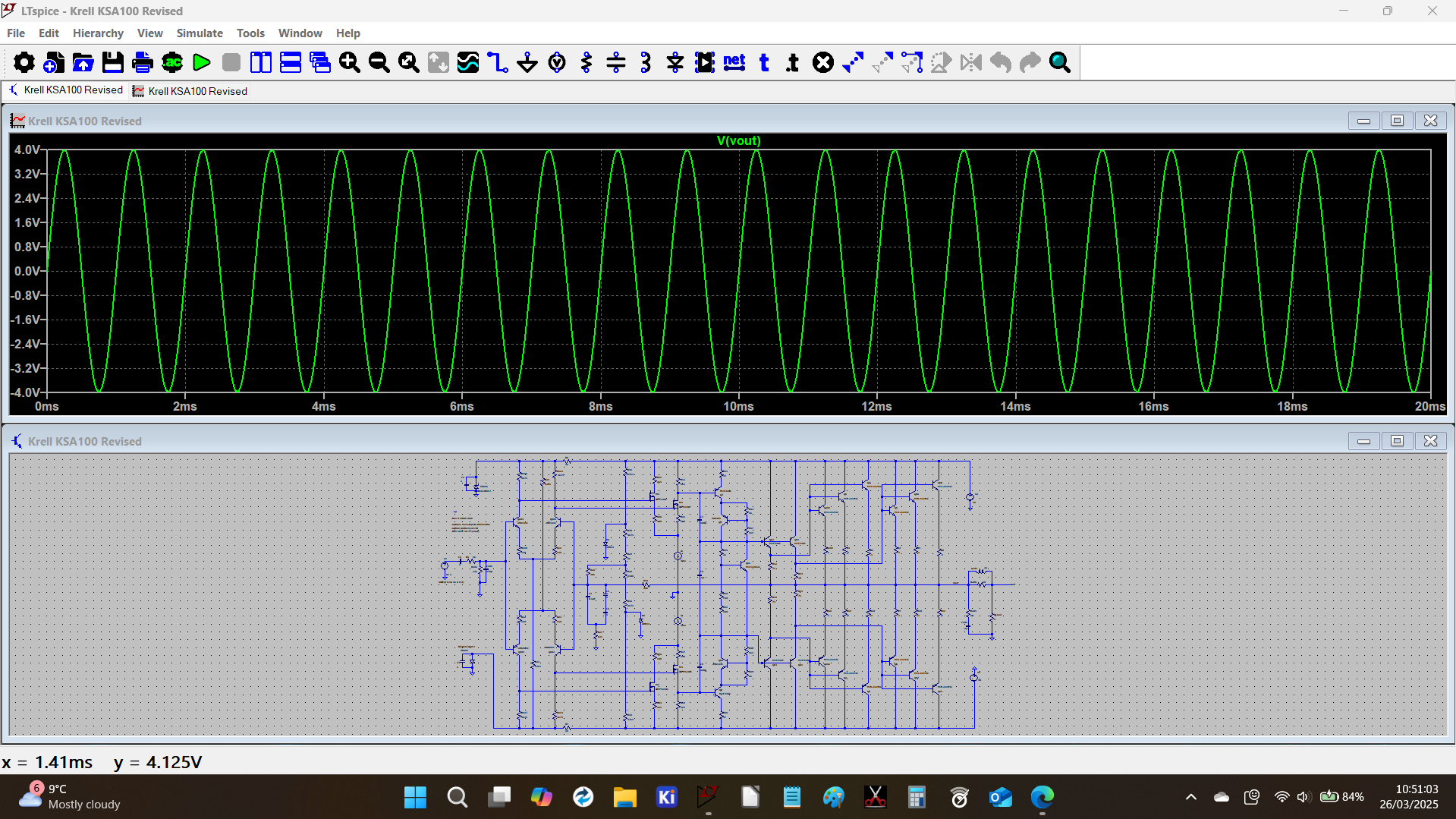

Just had a quick play. Bias adjustment is very model dependent, stability seems on the edge...
You need defined models for the NMOS, not just the defaults. 52pF caps cause instability (now 100pF). Bias setting resistor altered. CCS at 3ma, rails at -/+56. Zeners now connected. Offset range with R values poor... altered.
Bias set to 370ma per pair, no idea what the recommended value is. Sim parameters now set the old fashioned way 😉
You will have to swap your own models into the sim.

I was forced to do some digging. I have had some good LT Spice libraries in the past and I dug one such thing up on an old hard drive. Then I scanned diyaudio and found a link to a massive FET library. I've ordered transistors for this project I currently do not have stock of. When they arrive, I can measure them and add them to the simulation to dial it in.
I have a working base model now and lots of tinkering to do. So thank you.

I have D44H11 and D45H11 comp pairs. They measure almost exactly 205 and 210 HFE. Why not use them (a)?
I have MJE15030 and I have MJE15031 comp pairs. The 30s measure 100-ish HFE and the 31s measure 300-ish HFE.
I bought about 500 each of the MJEs(30-31) over the years trying to get them to match. NEVER succeeded.
The D45s and D44s are tight on the bench. I have never listened to them before, though I have had them in my stash for 10 years+
I deployed them in service work with above-par results but I never LISTENED to them. My 'customers' hear them.
DO YOU have experience with D45H11 and D44H11 in your audio projects?(b) DO YOU like them/sound?(c)
Alternate question(d): SHOULD I buy a boatload of MJE15032s and MJE15033s because I may get a better Beta Match? It'll set me back $500CAD. I can recoup the money in service work but am I likely to score HFE matches? (e)
Bob Cordell may have told me that I can drive a million MJ21193/94s with a single pair of MJE15030/31s.
Bob Cordell may have told me that I can parallel my DH45/44s or MJEs with little to no sacrifice.
Bob Cordell may have released a new addition of his book a few years ago and we should all buy a copy(I did).
