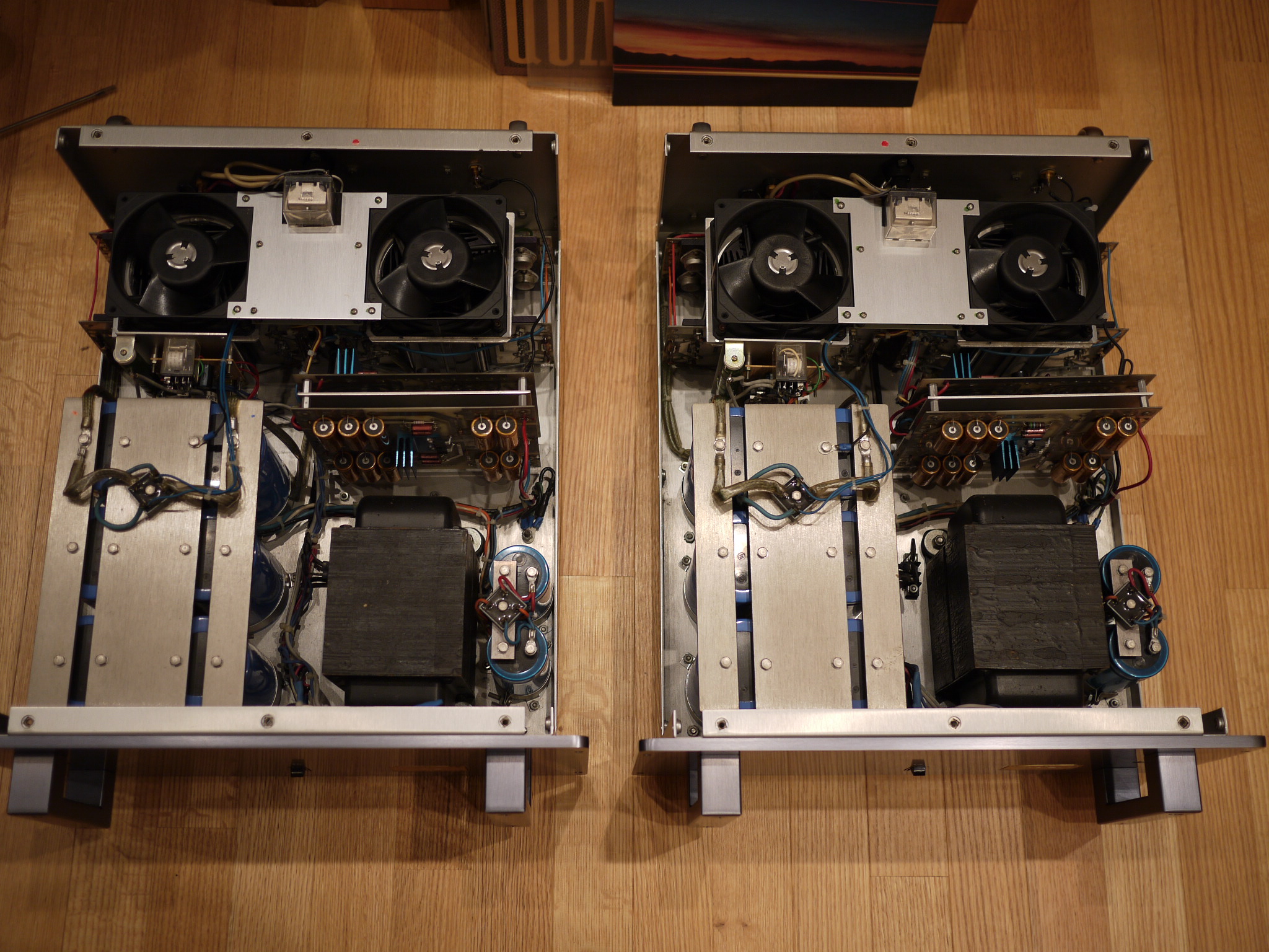

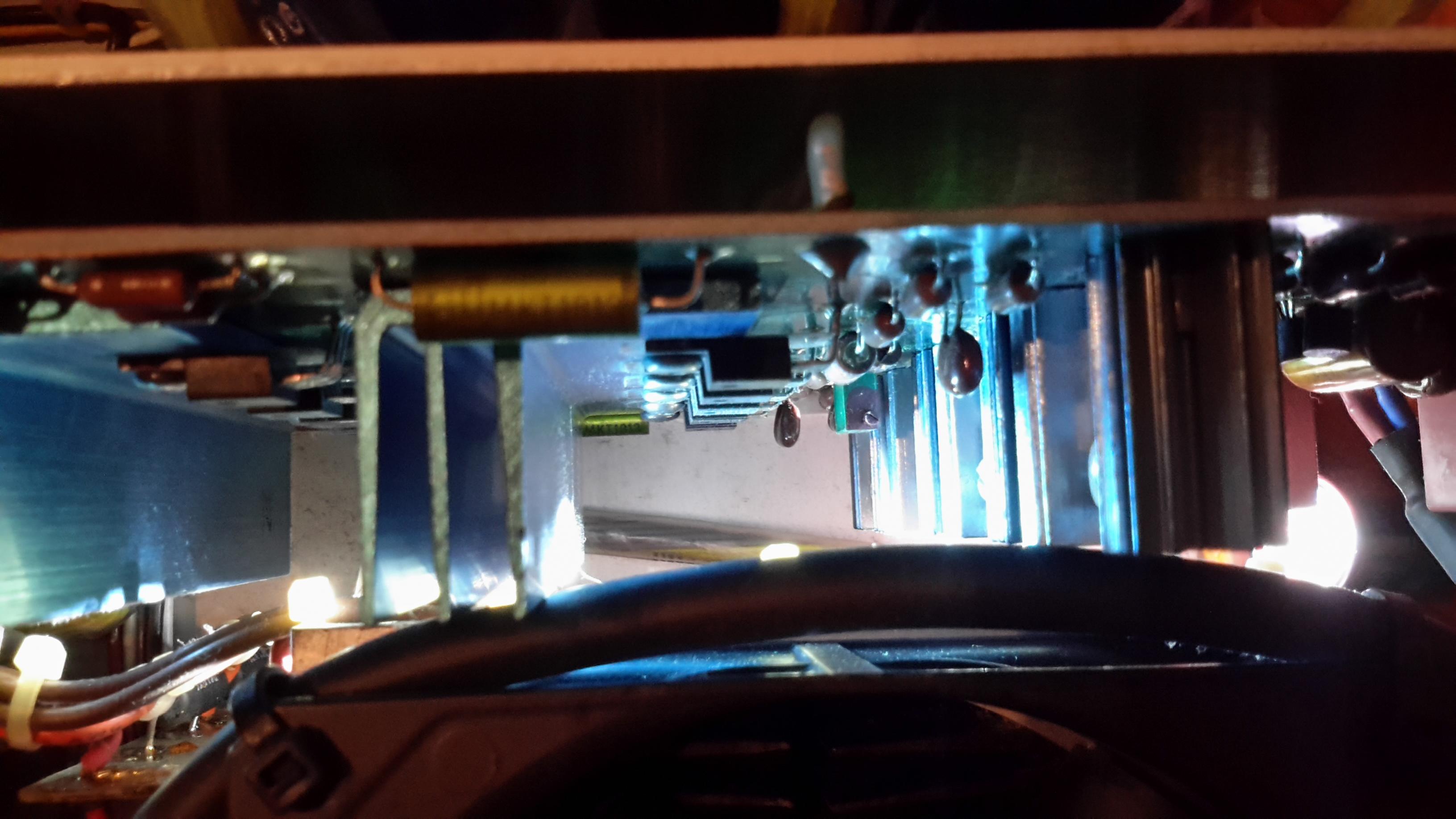

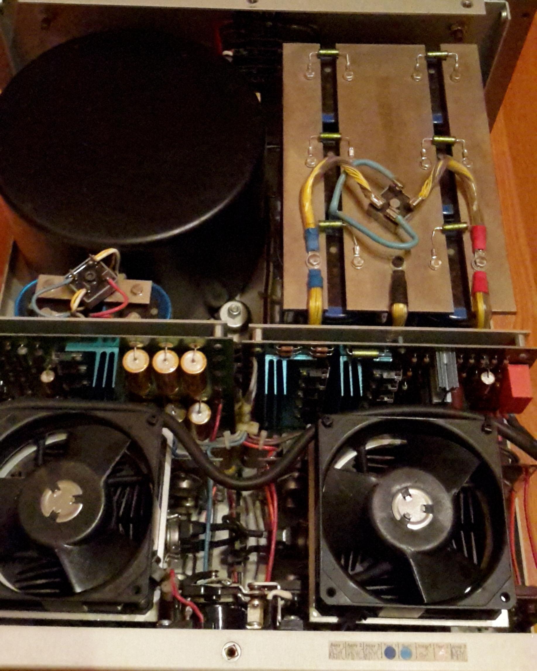

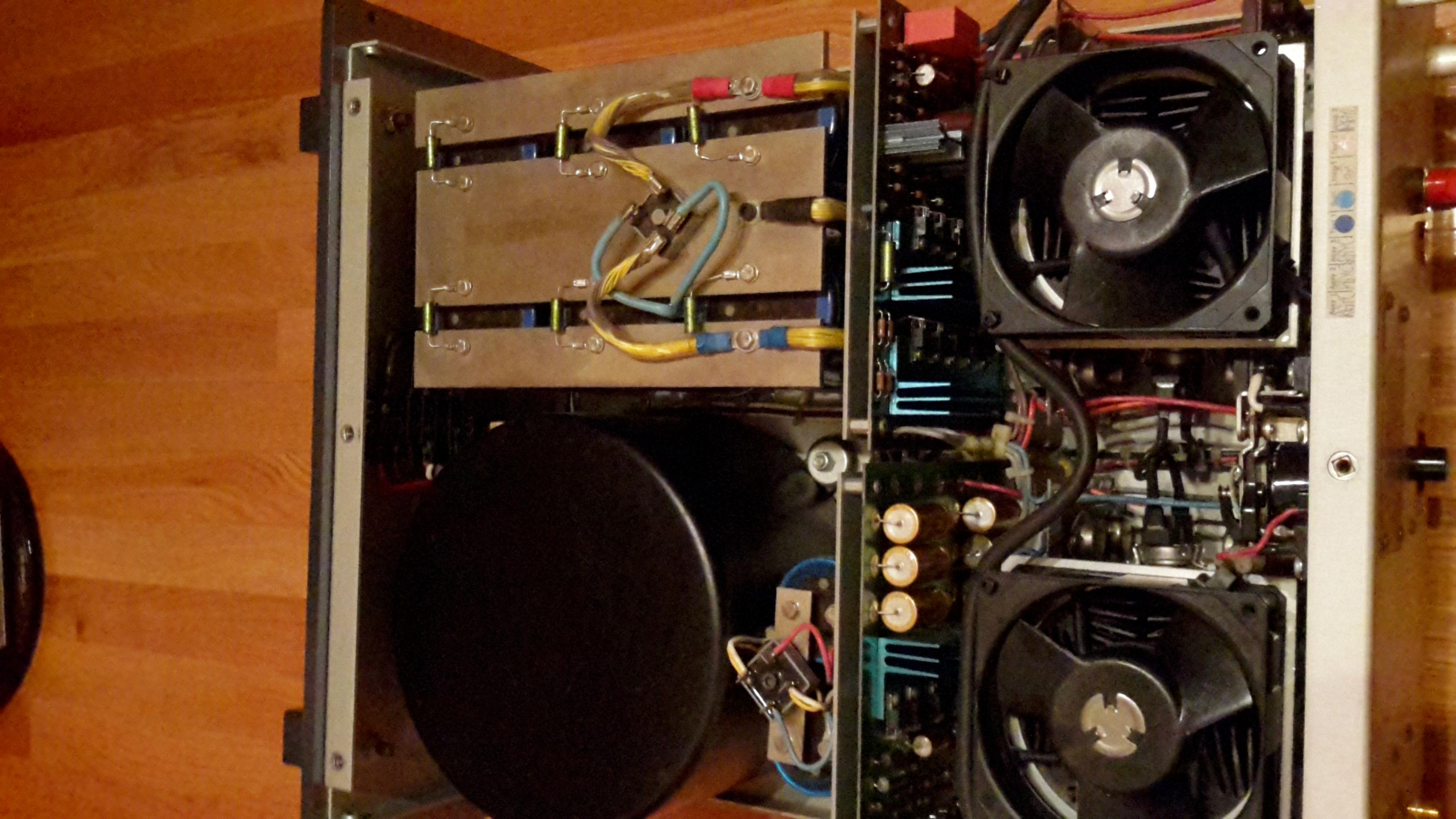

Great amp though maybe you can share some highres pictures of its innerlife.
Audio- and Regulatorboard would be interesting.

Thanks for the pics!
I know that you have to unscrew and screw in 20 screws and the screwdriver seems to slim away easily. Took me about 20 minutes to get the hood on and off again.
I see you have one of the Mark 1 versions with the fans blowing downwards but with a Avel Lindberg toroid. The first vesions had 'E-Core' transformers like these.http://www.diyaudio.com/forums/attachment.php?attachmentid=599058&stc=1&d=1486998116
