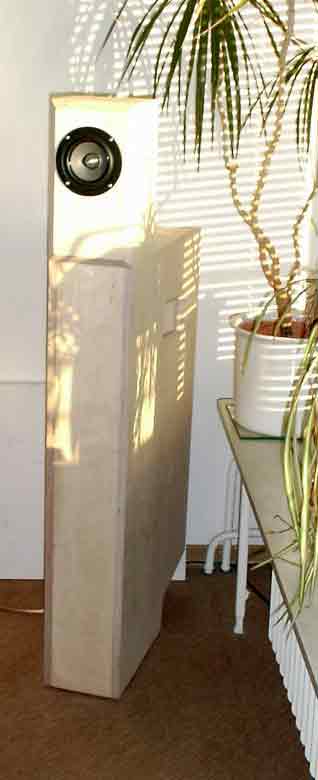

Hello,
all the best for all in 2008,
I start with the KORNETT a double
bass horn for 4"-5" driver.
with horn mouth distance and
membran movement cross setting.
http://www.hm-moreart.de/101.htm
opinions?
Hello,
try this
Tangband W4-655C
or similar,
or the ferrit version of the front
http://www.tb-speaker.com/detail/0624_11/w4-1320sjf.htm
front driver
http://www.tb-speaker.com/detail/1230_04/w4-1320sj.htm
if you can make measurements try other driver,
front driver should have a rising SPL over ~3Khz,
back driver invers and changed +-,
and SPL 1-2 dB less of the front driver,
than you may need no notch filter in the mids.
