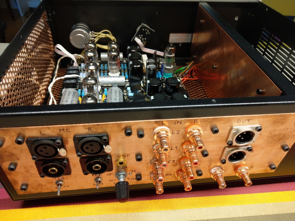

It would be nice and useful to see how your M77 clones look like inside. Here is mine:
Hi Tbaashus,It would be nice and useful to see how your M77 clones look like inside. Here is mine:
Nice job!
I will soon be putting my version into a case but I am interested to know what connections you are making to the earth point at the centre of the PCB i.e. the four yellow, two green and one black wire?

There are actually two black wires going from the earth point. One is ground connection for the line inputs (but not the phono inputs where I use shielded wires). I had a serious hum issue, and found that it disappeared when I grounded the PCB to the case, and that is what the second black wire is for.
I have recently repaired two Tandberg 6x tape recorders, and also have a 6x which was is such bad shape that I have used it as a parts machine. Six of the tubes on the amplifier boards on the 6x have metal shields connected to ground, so I just took the tube shields from the parts machine and put them in the M77 (connected with four yellow and two green wires). No idea if the shields make any difference, because I haven't tested the preamp without them. Anyway, there is very little noise in line amplifier and the phono preamp is also relatively quiet (not noticeable in practical use), so I don't think the shields did any harm.

Many thanks, I did not see the tube shields when I first looked.....

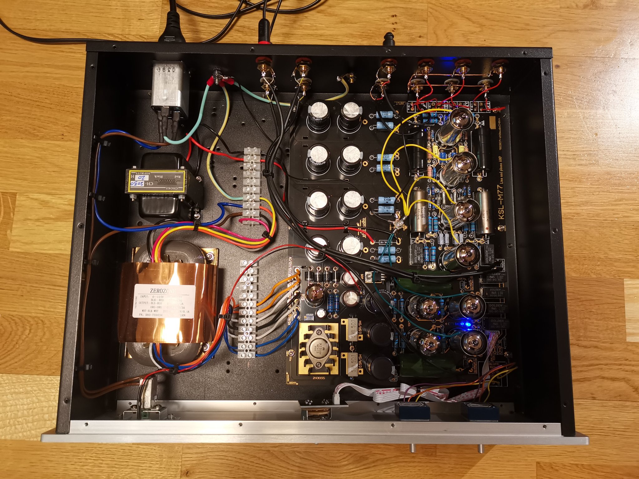

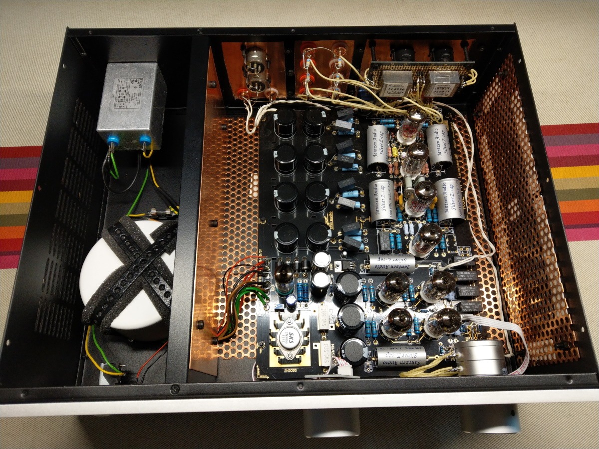

Finally got around to take some pictures of my build, please see attachments. I tried to use copper where possible, just like in the original
Also, fully potted mains transformer attached with springs and foam, a line filter, and additional bypassing on the supplies (the small black film caps).
You can also see the MC input transformers on the backside, giving me both asymmetric and symmetric inputs. The symmetric outputs are connected asymmetricaly for the moment, work in progress..... The volume pot is a chinese stepped attenuator, works fine in my opinion.
The coupling caps are Jansen silver caps, and the RIAA caps are Silver Mica. Wiring is done with silver coated solid copper and cloth isolation.
Enjoy

The rotary switch is in fact a 100k pot (+ 10k resistor), to adjust the input load for the MM input. And, as it is in parallel to the MC step-up transformer, it also works when the MC input is selected, here it will adjust from 100ohm to 1.1K.
On the bypass caps, I used 100nF, mostly because I had some with long leads that would nicely fit on top of the resistors without too much hassle. Next on the list was to make a 4-channel superreg (like the one from Allen Wright of Vacuumstate fame), one day I will get around to that project
