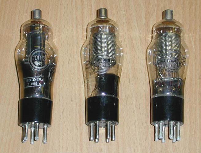

It is pronounced Jh, or Zh, looks like >I<
10Jh12S was used in telephone multichannel systems before 1960'th
Later it was replaced there by a loctal 12Jh3L - I am not sure it was the same internally. In later stations 6Jh1P were used, but I think they are not the same...
Here is the photo (the left one is 10P12S, a power pentode).

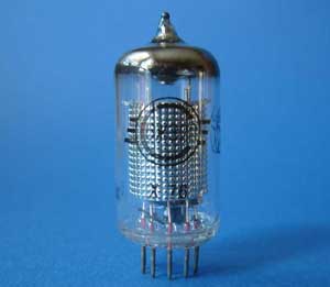

I believe 10Zh12S is close to later 6Zh32P tubes that were used mostly in microphone and tape head preamps.
When I was a kid I made an amp using 10Zh12S and 10P12S tubes.
