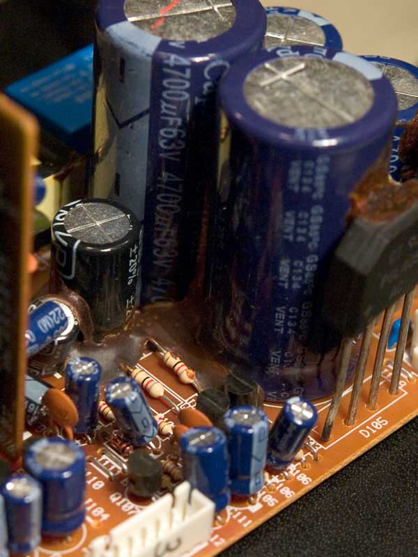

6. After taking the sub apart, I verified that the hum comes from the speaker (as opposed to an electonic part). The four largest radial electrolytic capacitors on the one board have a brown "gook" around them which I think is an indicator that they have failed and leaked. They are both rated at 4700 uf. One is 63 v, the other 35 v.
Does it make sense that it would be the caps? I would try my hand at replacing them, but after searching radioshack and the net, I can't seem to find capacitors of the same value.

I'd say either the caps have failed or the (probably pathetic bridged car-amp chip) amplifier has failed. The brown gook is probably adhesive that holds the capacitors to the board for mechanical stability. If they had failed, the tops would be domed or ruptured.
Take some pictures

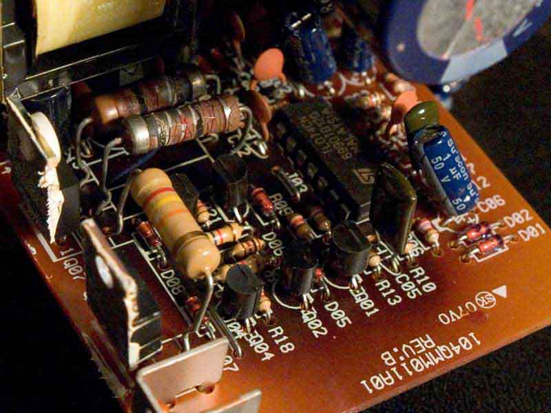

I disassembled the electronics so I could get at the boards in question. Upon closer inspection, I do NOT think the "gook" is leaked capacitor electrolyte, but rather adhesive placed there. The caps are not deformed in the sense of bulges or cracks.
With the board out, I can now see another potential problem. The circuit board itself is a brown color, like butterscotch. But, at one place, the board has a really dark brown charred appearance, which I interpret to be a sign of extreme heat exposure. In the vicinity of this discoloration are two resistors which seem cracked and disintegrating.
I will try to take some pictures and post them.
here is a picture of the caps in question

Ouch...it looks like there's a little more work to do.
I'd start with measuring the resistors (if still possible) and replace those. A plain resoldering of the board, especially the places that suffered from heat, could solve the problem.
If not, jaycee's tip on the chip might be correct.
/Hugo
I tried checking the resistors with a multimeter, but I am unable to read the color codes due to the charring. I do not have acess to a schematic, but am inquiring about the resistors values on the Klipsch forum.
If it is just a matter of checking the resistors value and repalacing them, I would be up to the task. Beyond that, I might be over my head.
I think there's more wrong than just the resistors. Resistors don't end up looking like that over time even if they run pretty hot.
If I had to guess, I'd say one or both of those transistors or another part of the amplifier failed and shorted out internally, which would cause the resistors to burn up like that.
There's also a chance that the amplifier failure may have cause damage to the subwoofer driver too if there isn't any DC protection and the amplifier became railed after failure.
