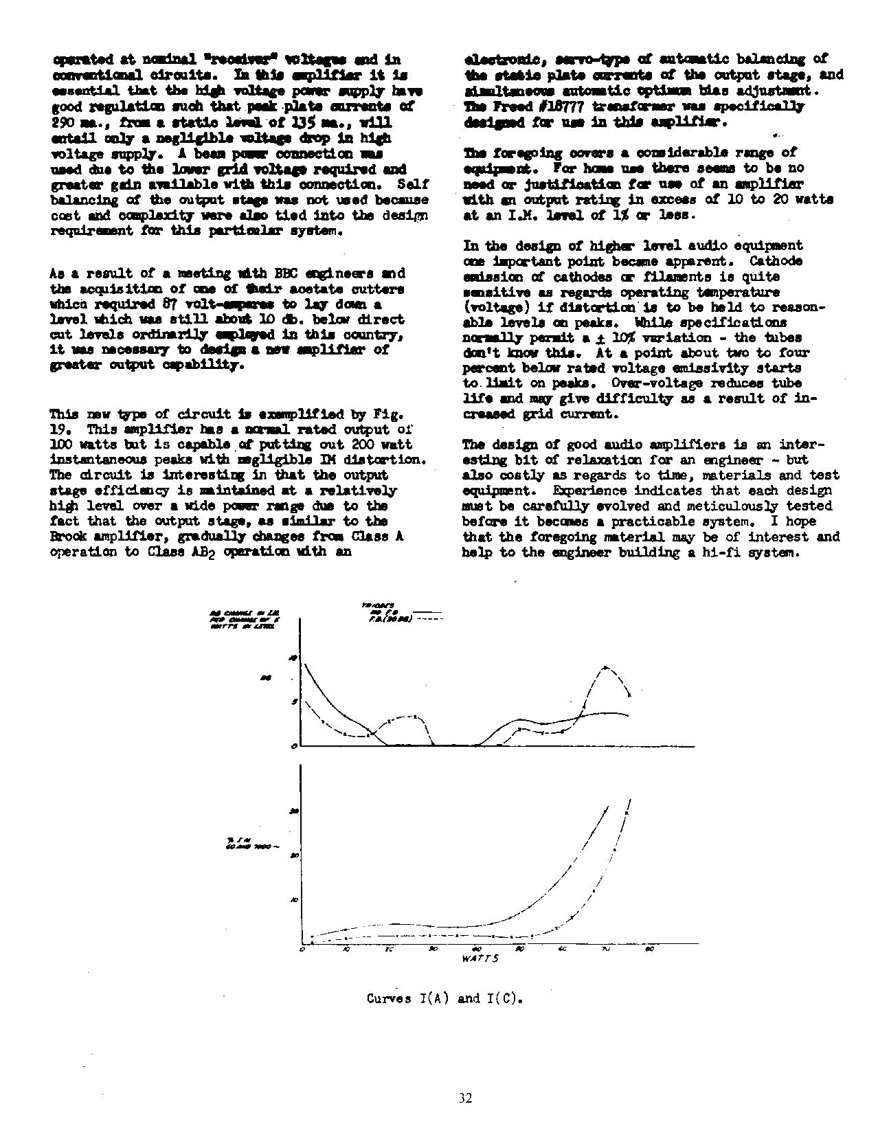

M. V. Kiebert of Indianapolis Indiana
Not a name you here all the time.
https://www.pearl-hifi.com/06_Lit_Archive/02_PEARL_Arch/Vol_01/Sec_01/065_Dsgn_Fctrs_for_PwrAmps.pdf
In Particular is the very last amp on the page.
Designed for the BBC no less.
It's a 100 watt continuous amplifier using a quad of 300Bs
Into a FREED 18777 output transformer.
Sadly there are NO component figures given in Mr Kieberts schematic.
Now here's the part that gets me.
How can you get a 100 watts out of a quad of 300Bs?
In the paragraphs above the schematic he references a 200 watt short burst peak power.

I found a HIGH detail of this circuit. Kieberts article starts on page 166.
Page 171 is the 100 watt amplifier. He writes about it in detail. So NO I don't believe it's a misprint.
https://www.americanradiohistory.com/Archive-Electronics/50s/Electronics-1955-04.pdf
Figure 17 says "Primary of output is a total of 1650 ohms" And the secondary shows 16 ohms.
Now I know of some UTC transformers that have a 2500 & 1500 Ohm plate to plate primaries. But these are rated for 40 watts.
The FREED 18777 must be a beast.

That is one of the most intriguing elements and I am also compelled to try that version of the circuit (I have the Bh7 tubes already)... at the same time, I really don't need a 45W amplifier. Its a lot to take one and I would feel much more comfortable investing the time and money necessary if I knew that someone had successfully executed this schematic and might be willing to offer a little guidance.
In my opinion, this is a very complex amplifier to build. The power supply is complicated by the choke-input design. You need a true swinging choke, not as standard choke, and those are hard to come by these days. You could change it to a cap-input supply, but that involves determining the target B+ voltage, which is probably around 400VDC. The negative supply is tricky as well, coming right off the main HV taps.
More critically, we have no idea what output transformer was intended, at least I cannot tell. Without that information, you'll have to experiment with the amount of negative feedback (which is also not certain--20dB?). What plate-to-plate load did he use to achieve 45 wpc? Perhaps 3K, or 6.6k? I don't know. Also, since this is a Williamson design, stability is going to be a factor, and the output transformer has to be very, very good to handle the feedback without oscillating.
I'm a fairly experienced builder but this would be a real challenge for me.
I *have* built Kiebert's 24wpc Williamson. It was pretty zippy, with high input sensitivity. I frankly prefer the more relaxed sound of the original 6SN7 tubes and don't find find the original as problematic as Kiebert makes it out to be. But in terms of bandwidth and transient response, Kiebert's version excels the original.
If you don't need 45wpc, but want to try a Kiebert design, I would suggest the 11 or 24 wpc versions in the original article. Here he uses the Peerless S-265-Q, a magnificent transformer. Heyboer makes a *very* good copy, for about $225 each. They work every bit as well as the original in American Williamson designs. In this way you are not flying blind, the design is much simpler, and the sound is quite excellent.

I have to think that a lot of Kiebert's design were thought exercises. I wonder how many amateurs actually built the more complicated ones...

Thanks for the input and for the document. That is a very helpful version of the schematics, as it details the power supplies for the 11 and 24 watt versions.
One of those is definitely a more reasonable project to consider.
I am often drawn to exotic circuits (and tubes) but I am an intermediate amp builder at best, so it would be irresponsible of me to try to build a circuit as complex as the 45 watt Kiebert.
I may try the 11 watt version and I will post about it somewhere on the forum if I do.
