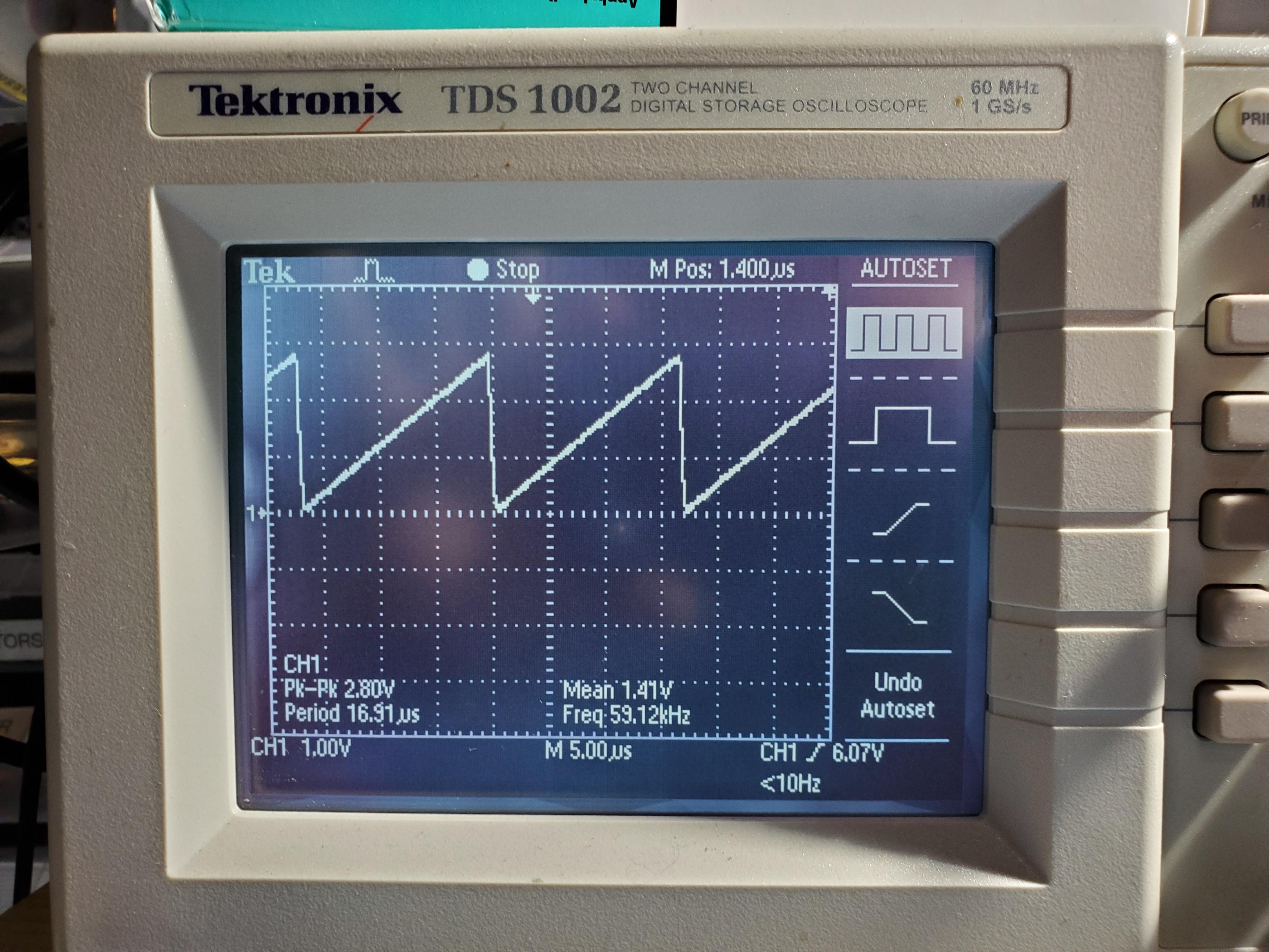

Tl494c voltage.
1.) . 883
2.) 3.693
3.) 0.054
4.) 0.029
5.) 1.445
6.) 0.001
7.) 0.000
8.) 0.000
9.) 10.21
10.) 5.23
11.) 0.008
12.) 13.19
13.) 4.891
14.) 4.872
15.) 4.871
16.) 4.117
As soon as I add the fets the pulsing starts, using irf3205's still have the 100R gate resistors, should I lower the resistance to say 47R?

The voltages you listed for Pins 8 through 11 can't be correct, considering the waveforms you posted. But based on those waveforms the power supply is working. I'll have to get back to you about the gate resistor values, but the 100 ohm resistors shouldn't cause the amp to pulsate.

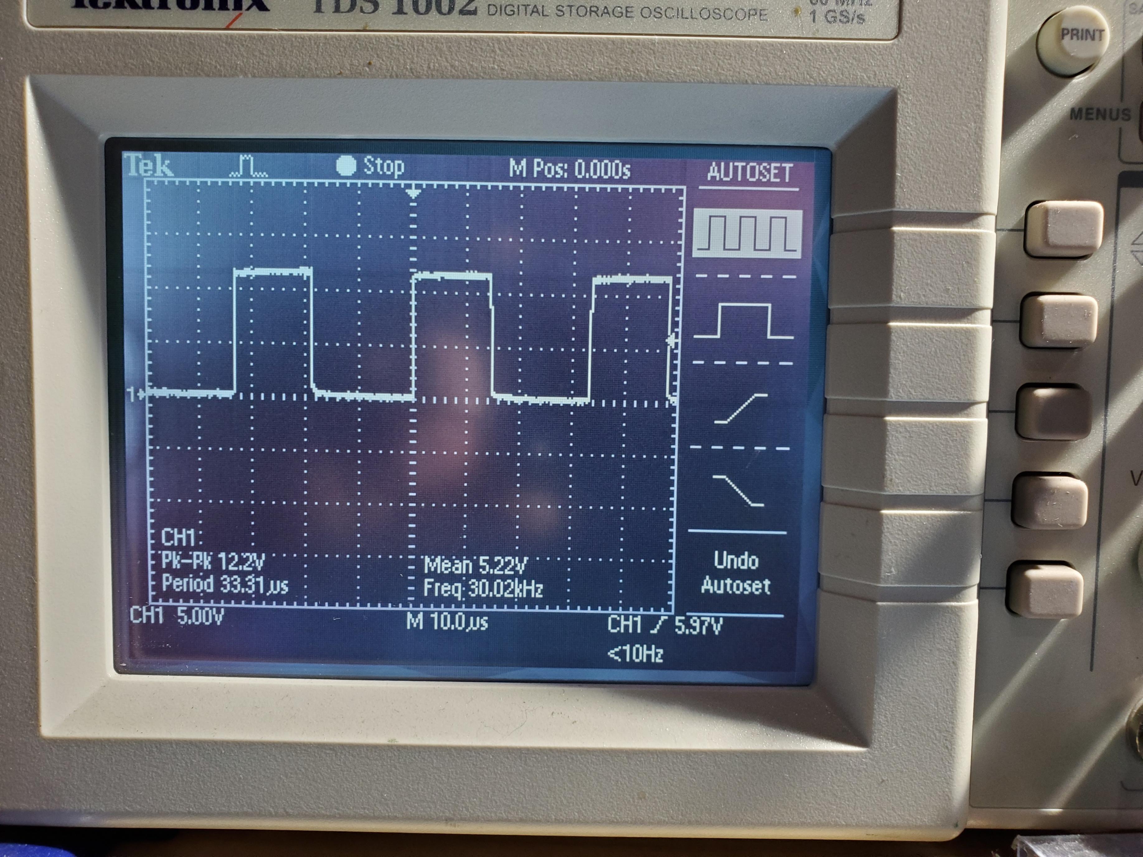

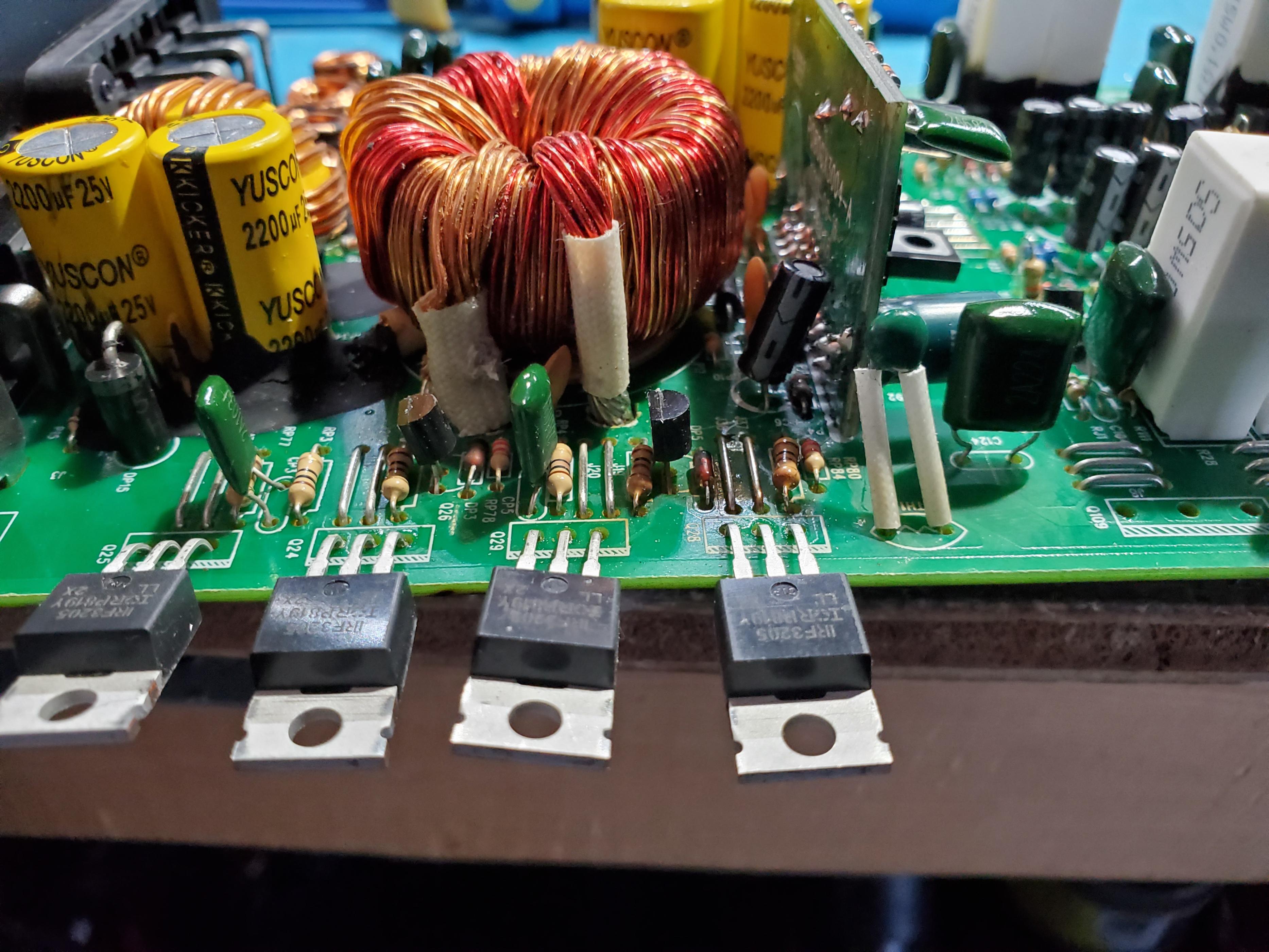

OK, now I have been through the entire curcuit. No failed components. Drive is good. I removed all the outputs and lifted the output protection resistors. R33, R34, R88, R89. Powered up the amp, current. So I go to Check the ps fets one is shorted. I remove it and power it up again. Current. Removed them all drive is 100% Good 30khrz square wave. All resistors and capacitors check good. So I'm leaning towards the transformer has a short somewhere.

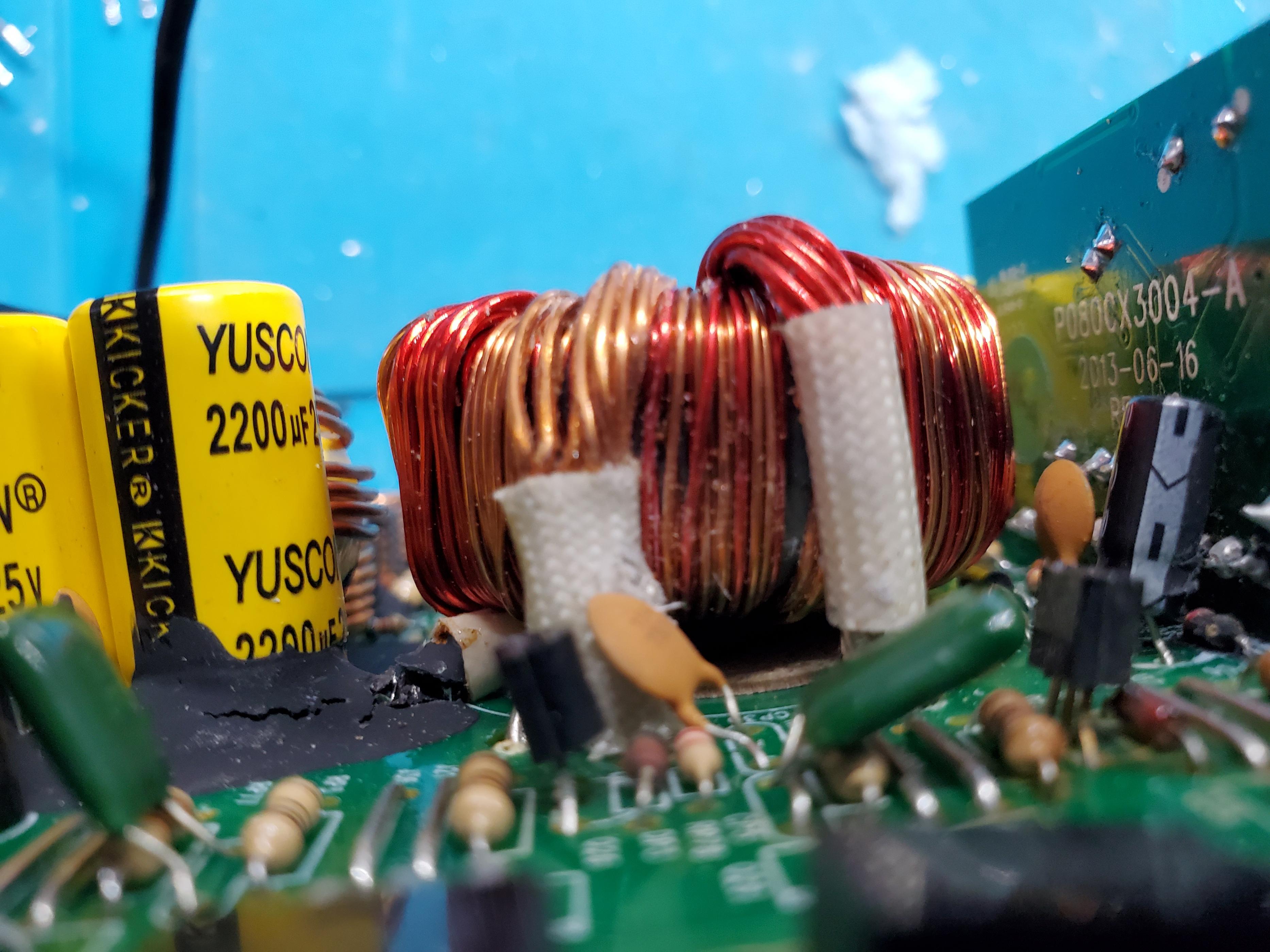

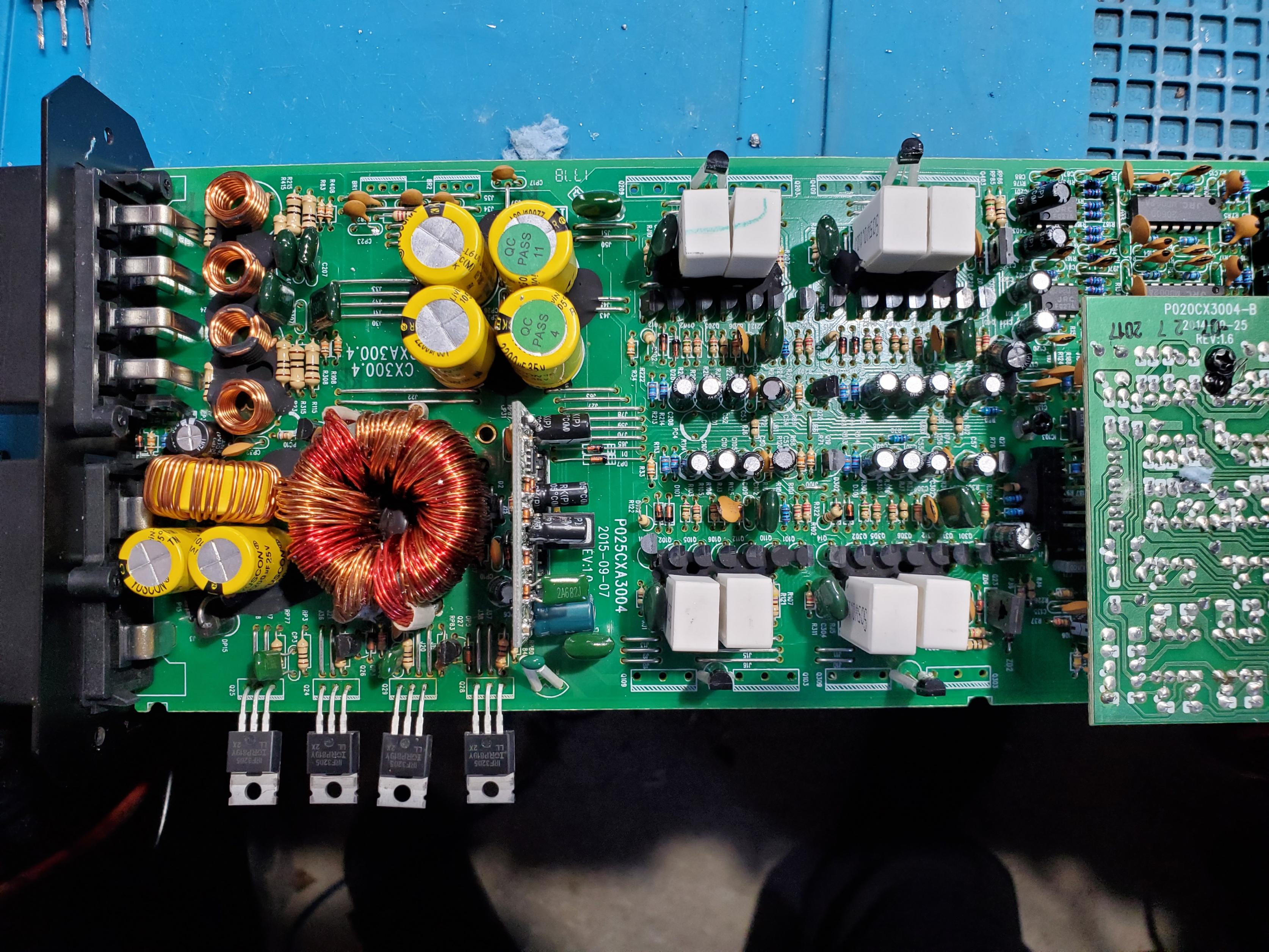

post a pic of the transformer and surrounding area and one overall top and bottom side.
Does the transformer have any hotspots, discolored windings? Is the core cracked? If you twist and turn the transformer does the pulsing stop?
