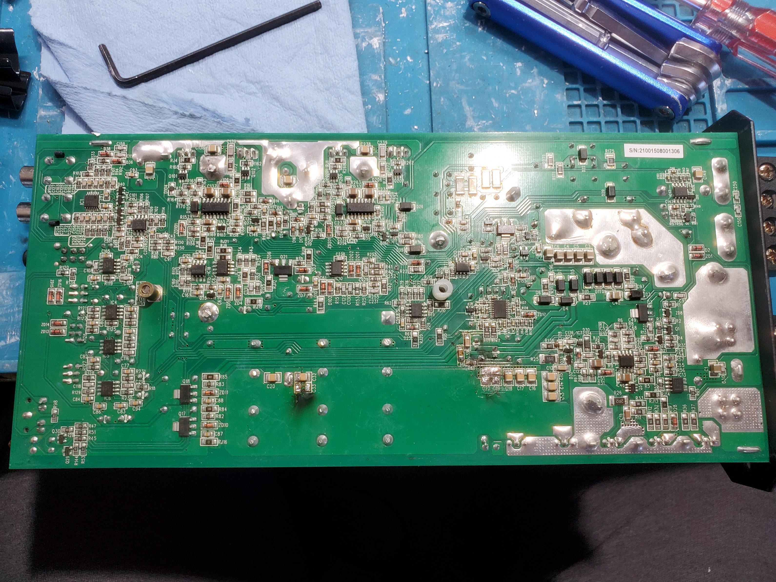

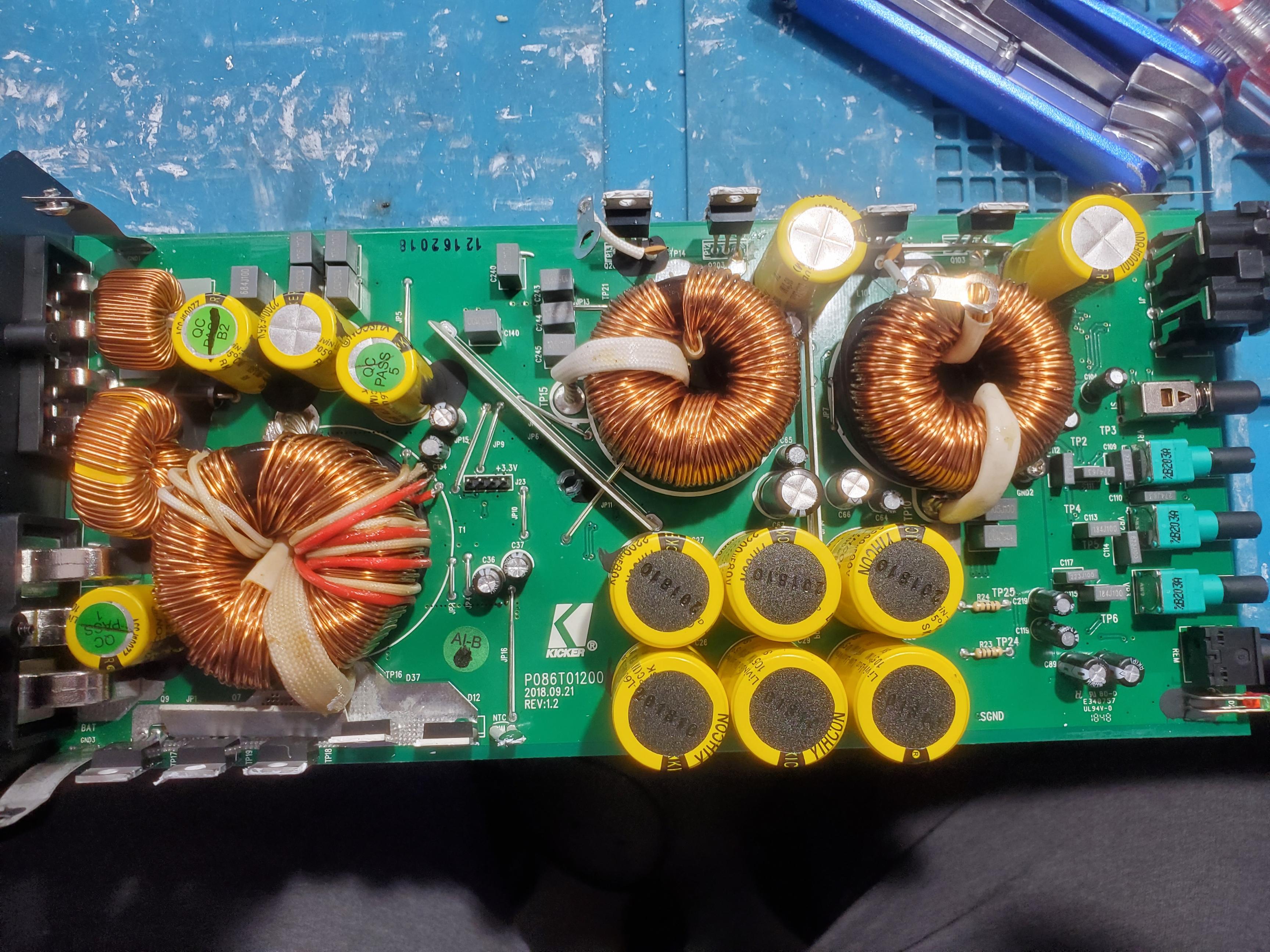

rhempz01 Member Joined 2016 2019-10-10 8:03 pm #1 2019-10-10 8:03 pm #1 i have the new 1ohm version of the cxa1200.1. Something was left cut long and it grounded to the heatsink and blew some smd capacitors. c23,c19,c33 could really use there values. Attachments 15707341842941124017499687938863.jpg 1 MB · Views: 89 15707342112309093343955858617994.jpg 1,010 KB · Views: 88 PapaZBill Member Joined 2013 2019-10-11 2:36 am #2 2019-10-11 2:36 am #2 C19,23,33-220nF You must log in or register to reply here.
