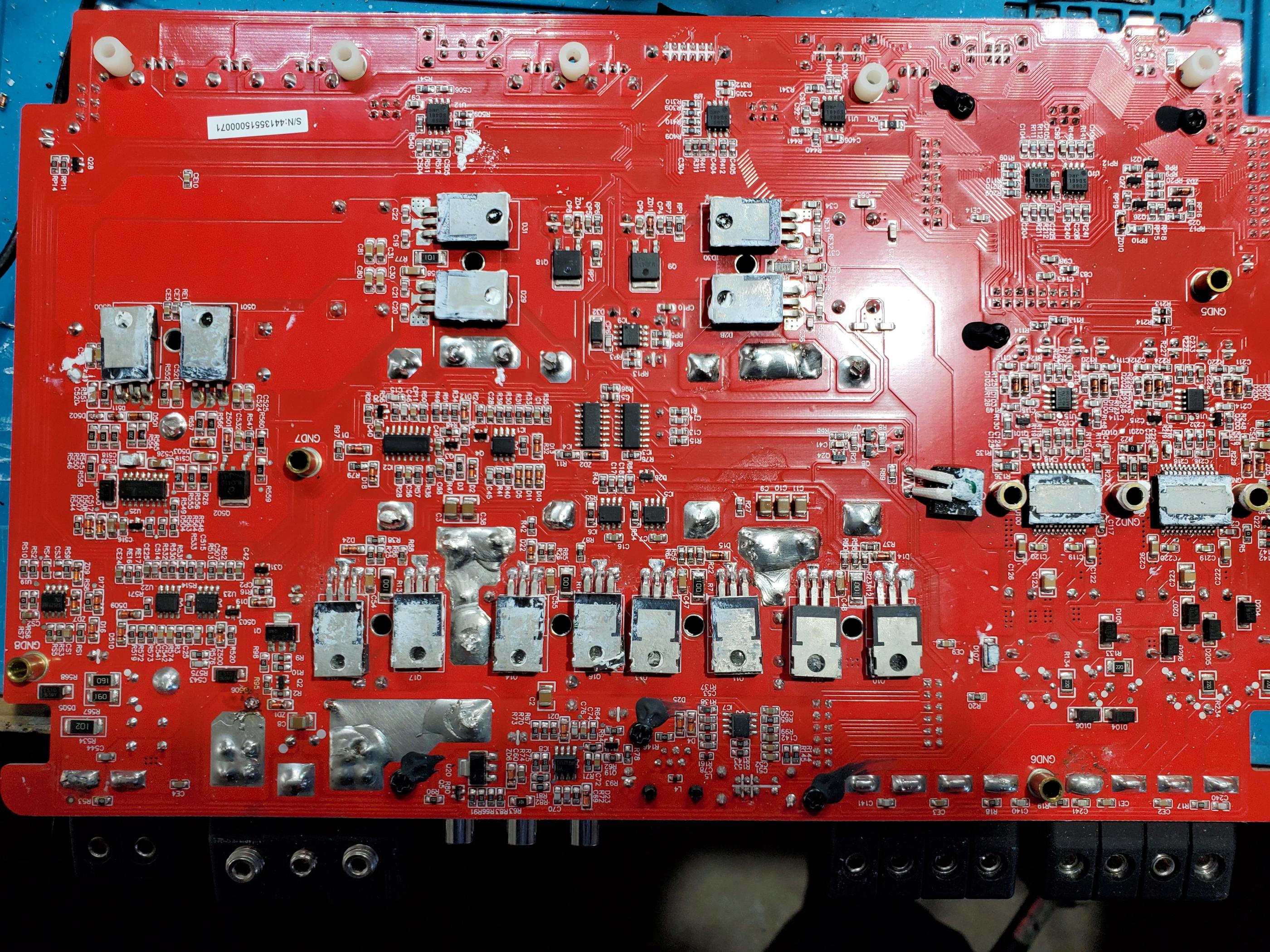

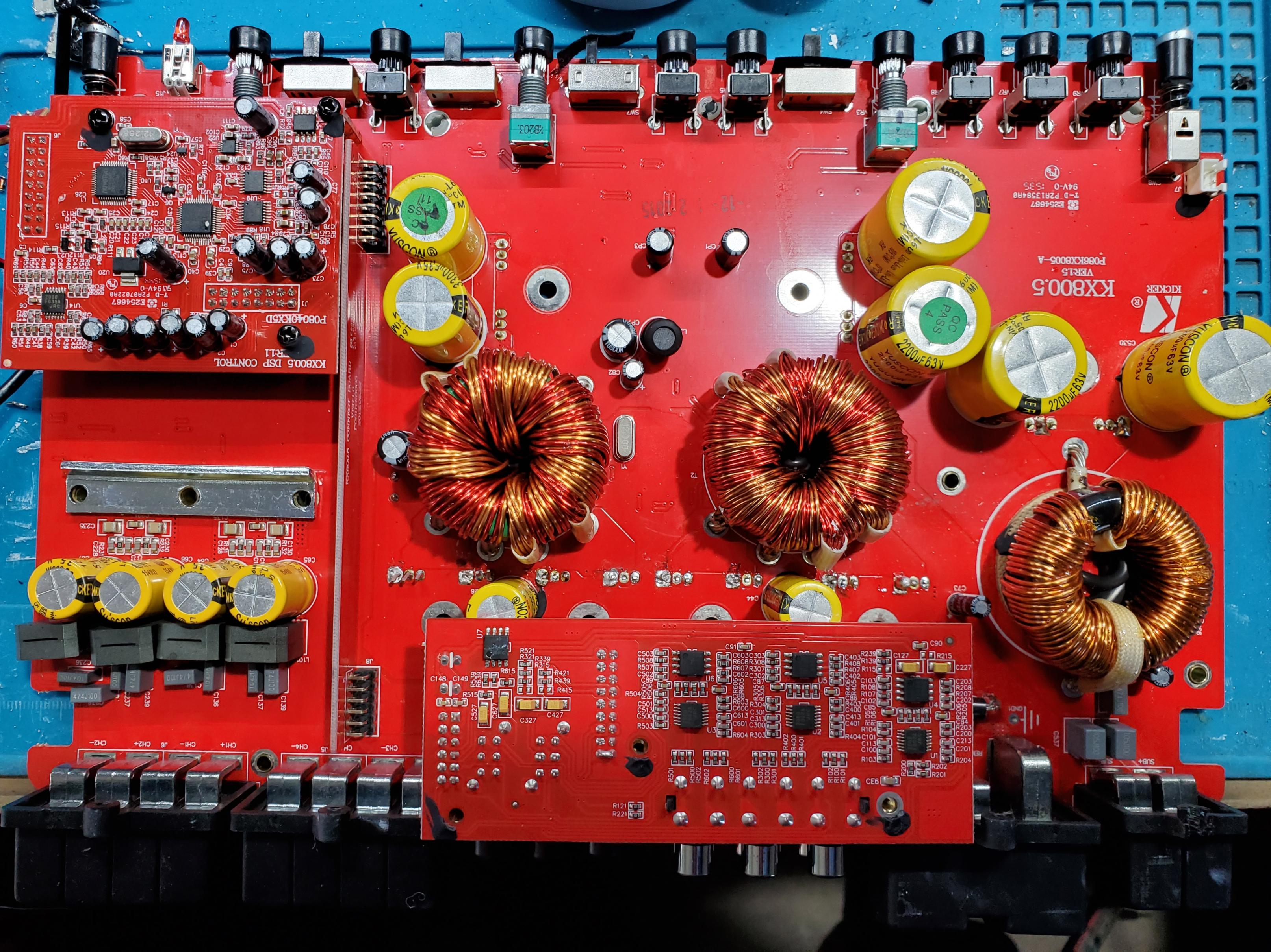

i just received a kx800.5 i found it had shorted q10-q12 aot460's. i replaced them but if you add power to the board, it still does not power up correctly. So i could use some help learning this board.
Q10-12 are the power supply switchers for the full range output IC's.

i have all of those supply's to build a small heat spreader for the chips to keep them.from burning up.
Ok so with the power supply aot460's all in a good standing. And the the led plugged in the amp will not power up. it draws about 2.4amps and the voltage is pulled down to 3v from (12.85vdc) setting on my supply. Something is short. The protection led is just off.
