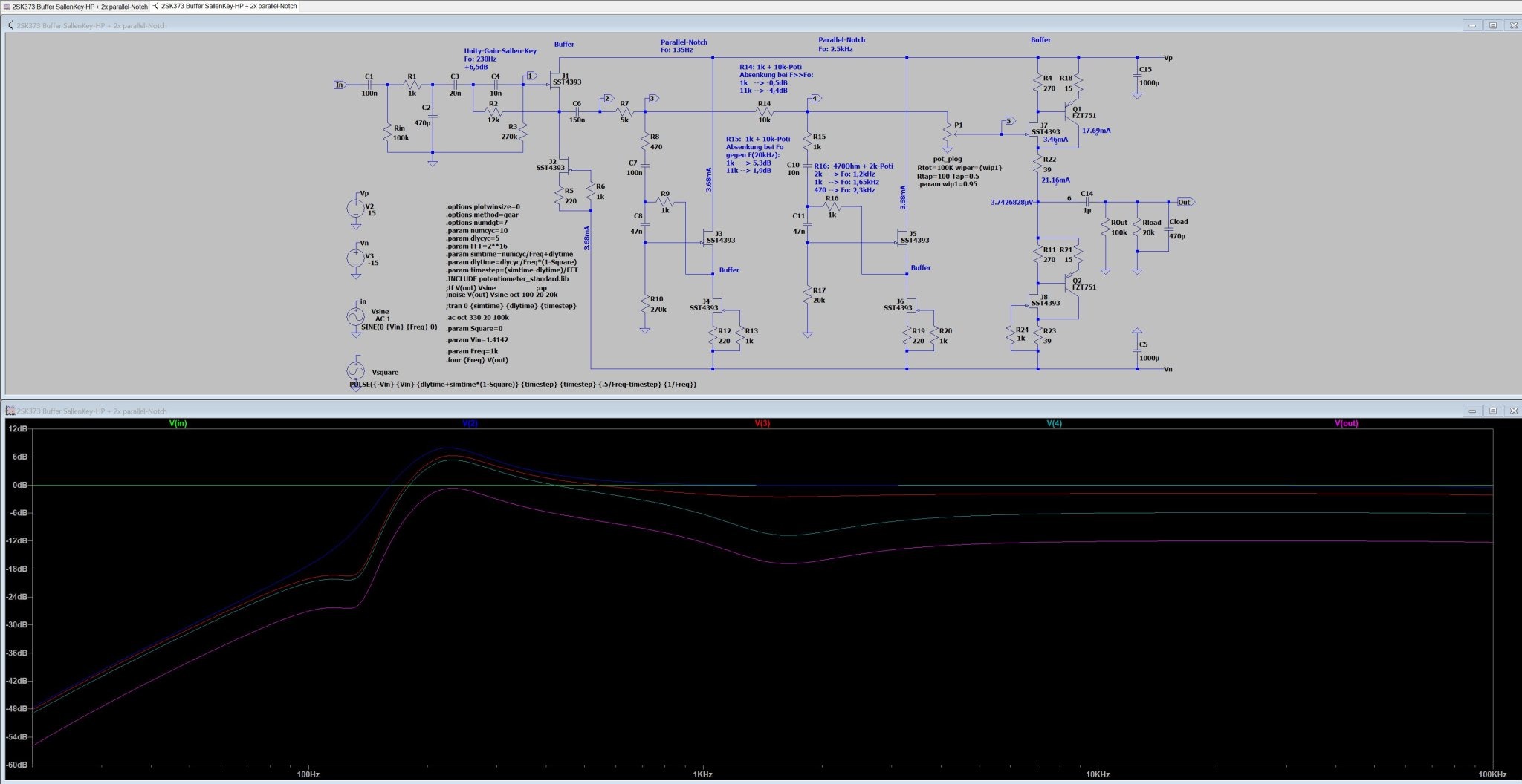

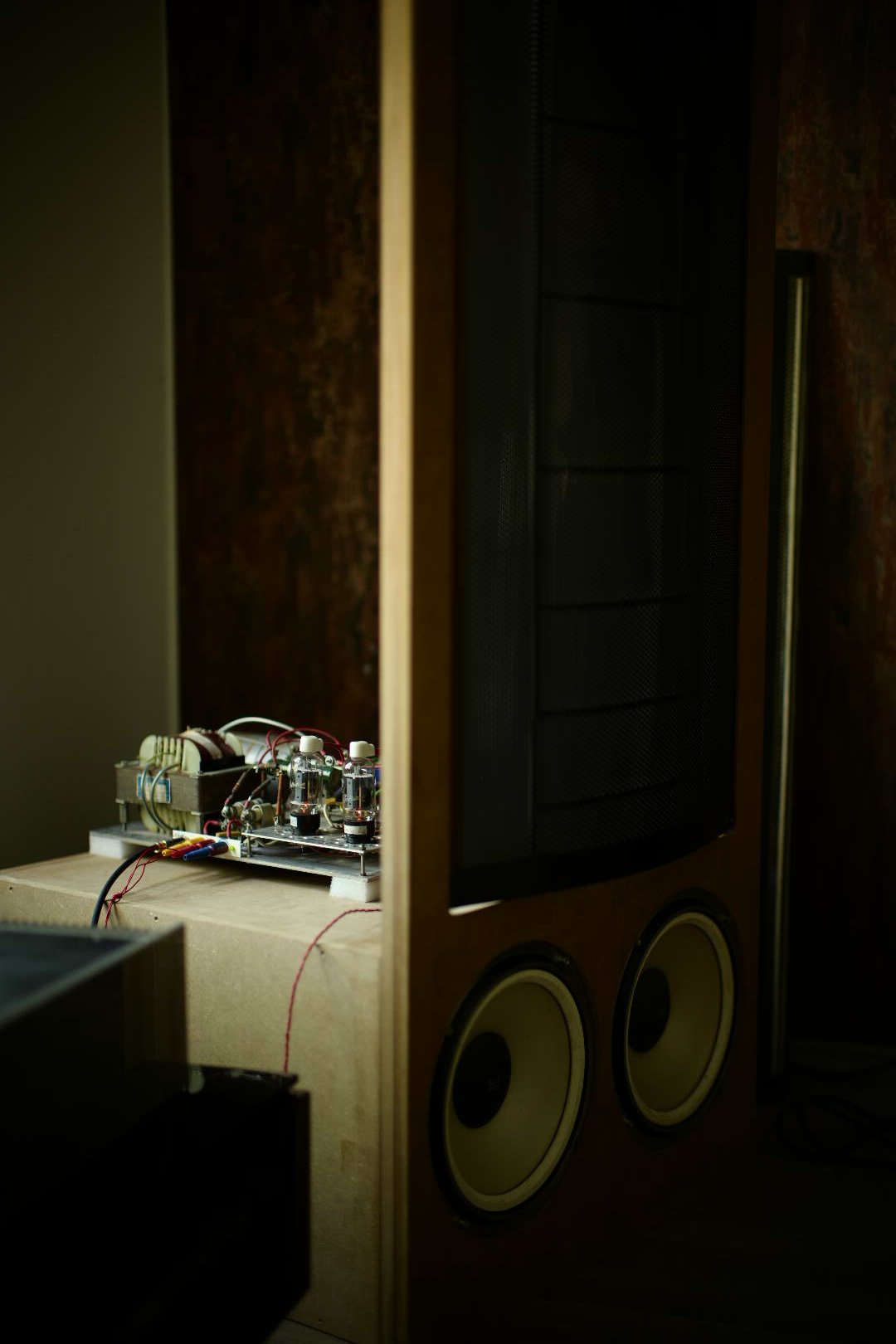

So i built OTL direct coupled electrostatics with some decent woofers and i needed a proper XO. I love Jfets. I got them everywhere. I even got them in my purse. Dunno for what, but i'm prepared for the unknown ;-)
However, bored of DSPs and bored of turning XO knobs the whole day instead of listening, i started to design a Jfet buffered PLLXO. Thing is i like my stuff minimal. Also i have a specal affair with single ended 2SK170s. I know i'm not the first to create a Jfet buffered XO and i know Nelson has the genius 6-24 J113 ready for sale. Not saying that's bad, i love it. But i like to etch stuff myself. Single ended, single layered cool old skool. No China. Strictly.
I didn't use CCS in this design. I am using 2SK170 with bias resistors all the time and with a good PSU i have no issues. Noise from my OTL amps is louder than the Jfets anyways. And honestly i never had audible noise from the Jfets even with my headphones. Also i want to use 2SK170BL. These are rare and expensive.
Please bear with me i'm more enthusiast than a pro. Work is still in progress. Also i'm still on a learnig curve in KiCad. I tried it all on a perf board and it worked.

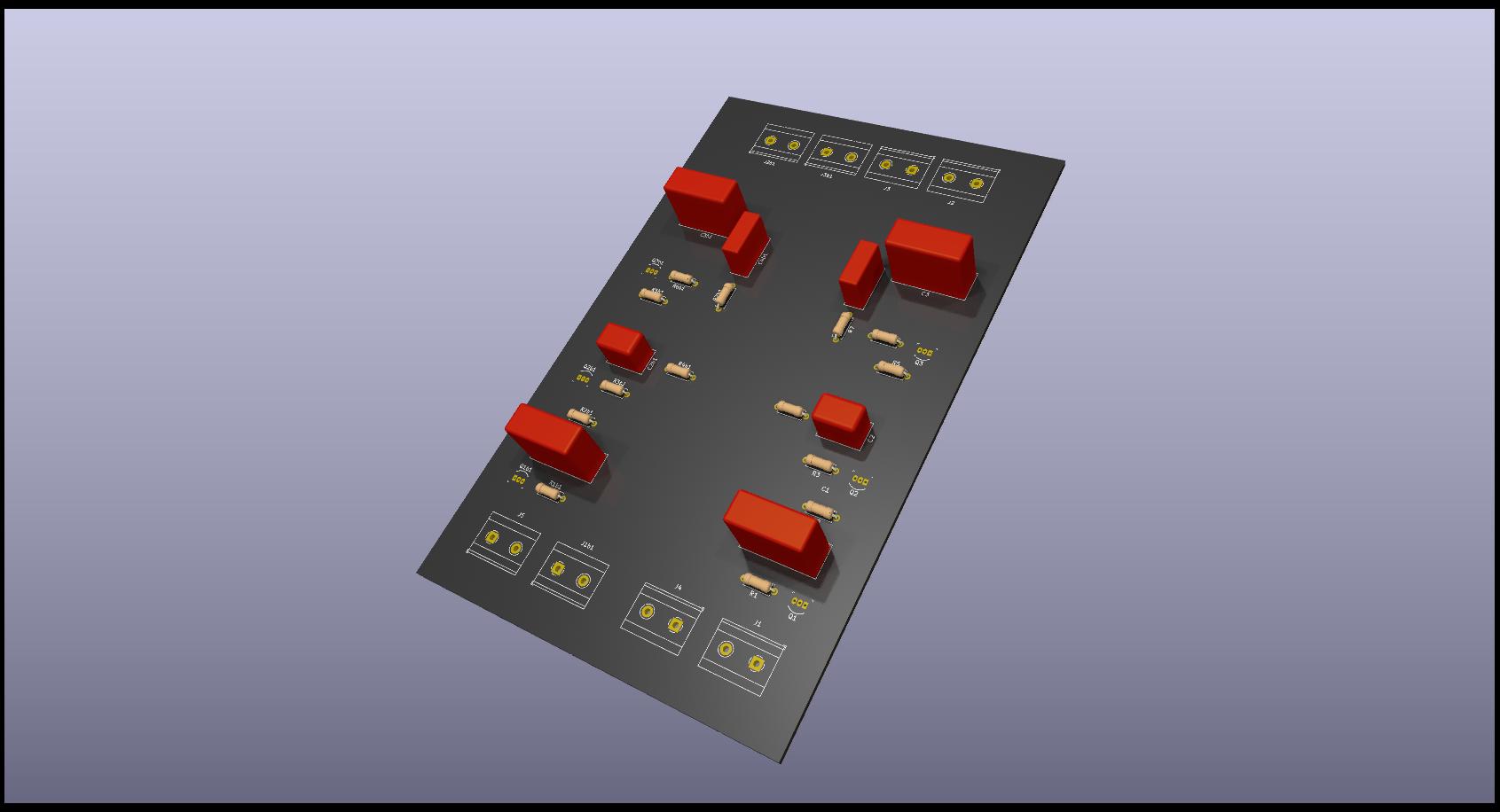

So. This is the 'Vulture' Jfet buffered PLLXO. I called it so because the schematic looks like an abstract vulture ( you need a bit of phantasy for that) 🙂. You can build it in dual mono if you wish. Everything is prepared for that. You will need 6x 2SK170BL matched @10mA. Actually everything between 9 to 11mA should work fine. There is also a PSU using the LM7812. Can be substituted with the 340-12 which is better on paper. There are quite a bunch of caps, probably makes Nelson smile when he sees that. The transfo is an encapsulated Talema 70063K toroid with 2*115V / 2*15V. It's wired for 230V but can easily be changed for the US.
The PCBs are 160x100mm Euro format. There are Hammond enclosures for this form factor. I did not include fuses in the schematic/PCBs because i like to use fuse holders which allow access from the outside of the case. So don't forget your fuses.
The PLLXO itself is first order. You can easily make it second order by adding another PLLXO stage between the buffers / after the first stage. It's really easy. Just use the same parts. 6db+6db makes 12db/Oct.
I think you can't make this any simpler. It's really just a few parts that make a superb active crossover. The right thing for minimalists. Actually you can make this a complete preamp with nearly unity gain by just adding another stage of Jfets and a 50k stereo pot. Maybe add a source selector and you're good as long your source is loud enough.

Jfets typically have very high input impedance. It depends a bit on the IDSS of the Jfets you are using. I recommend to start with C=0.1uf and R=10k and see where it takes you. I'm getting around 200Hz with that config.
I used quite big footprints for the PLLXO parts, so that people with love for PIO caps etc have bit of playground.

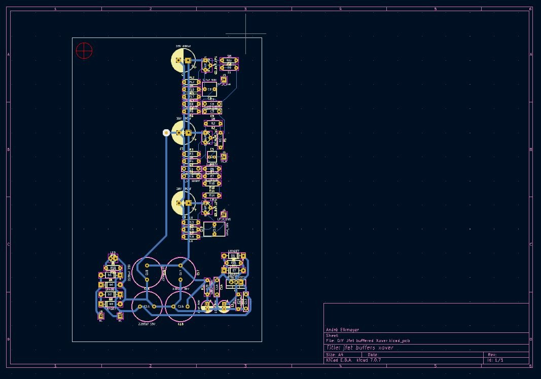

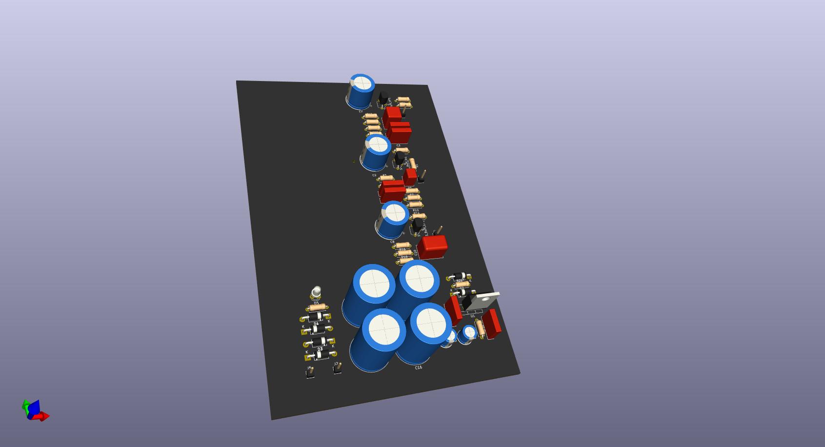

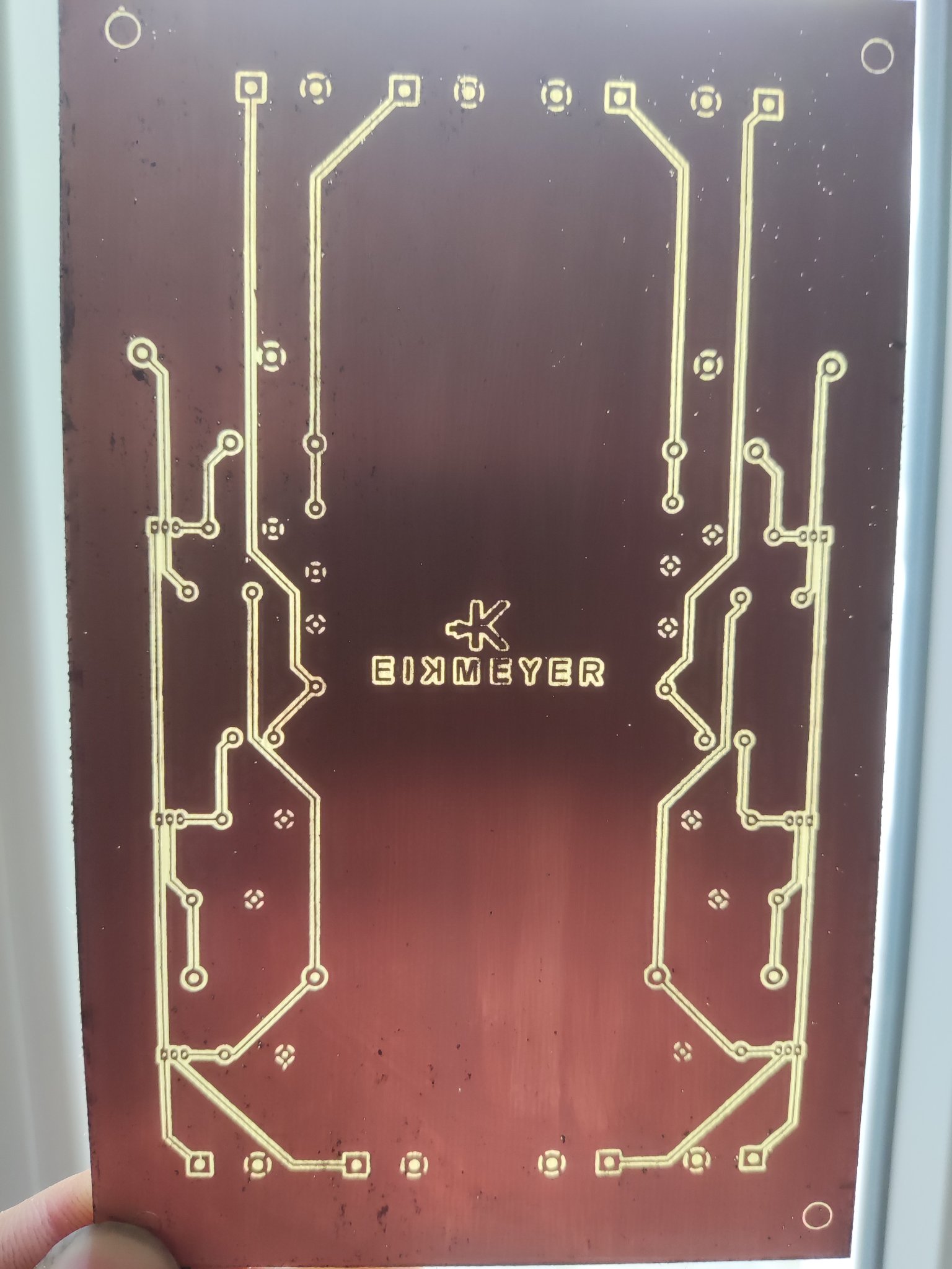

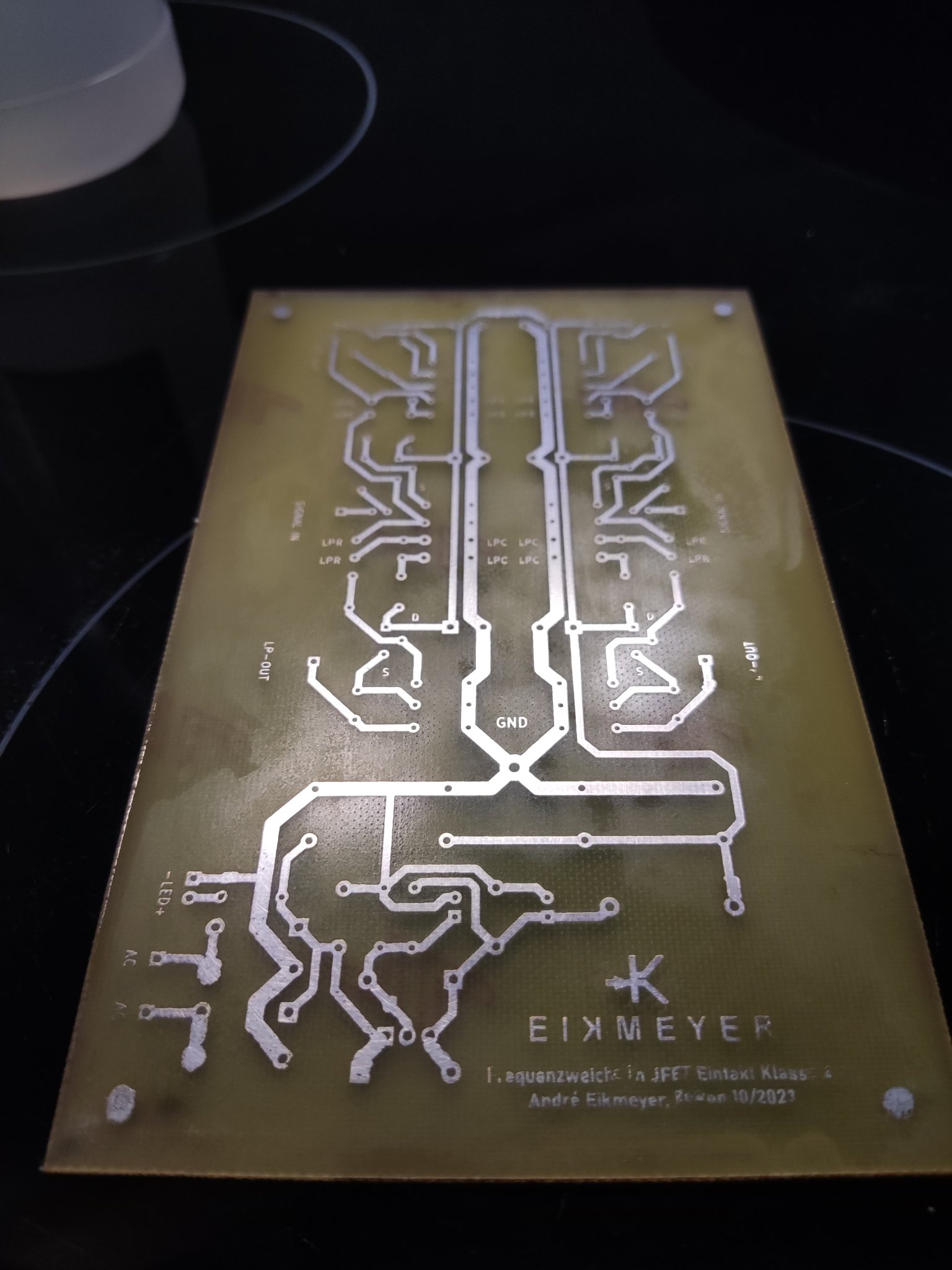

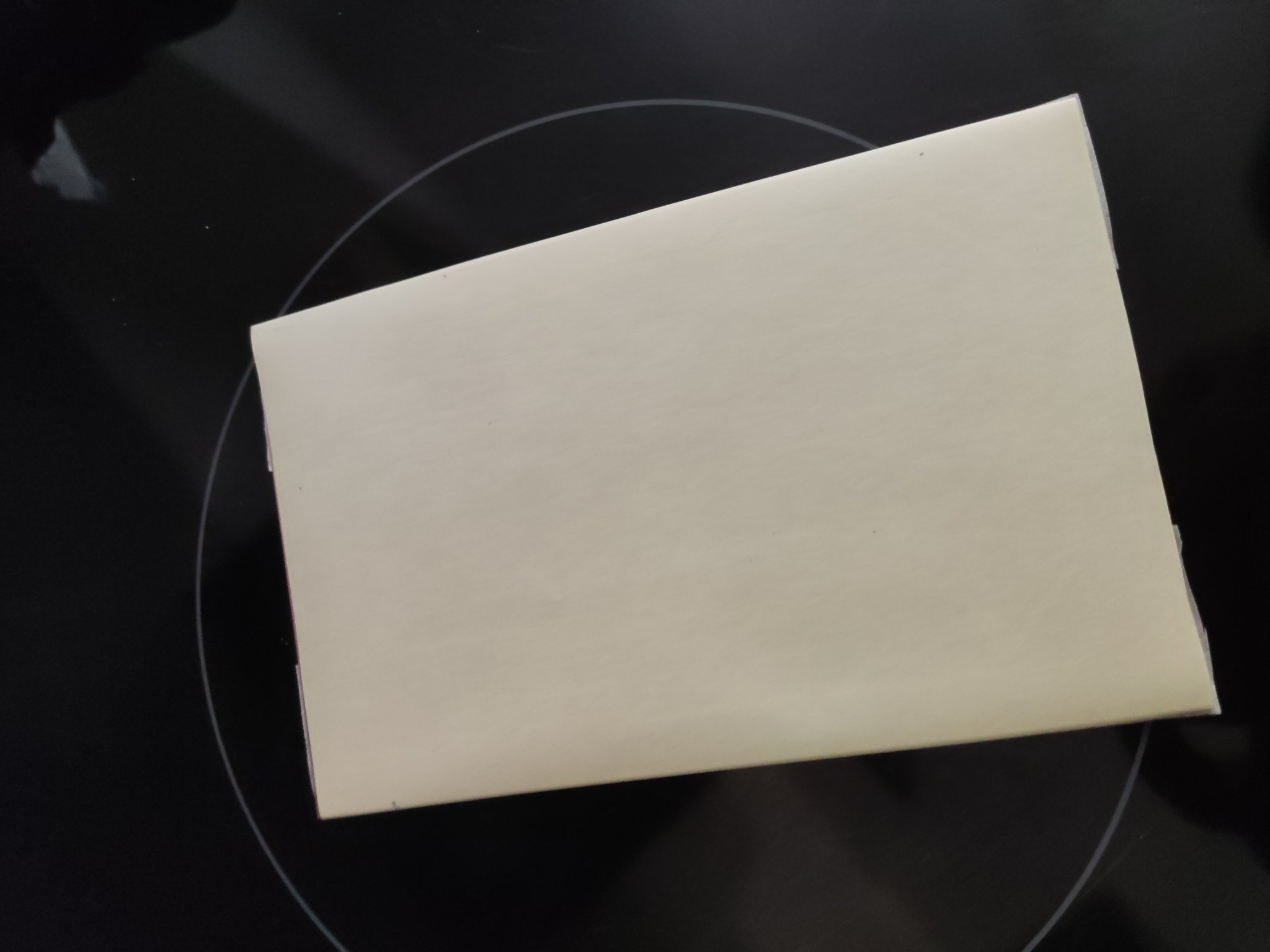

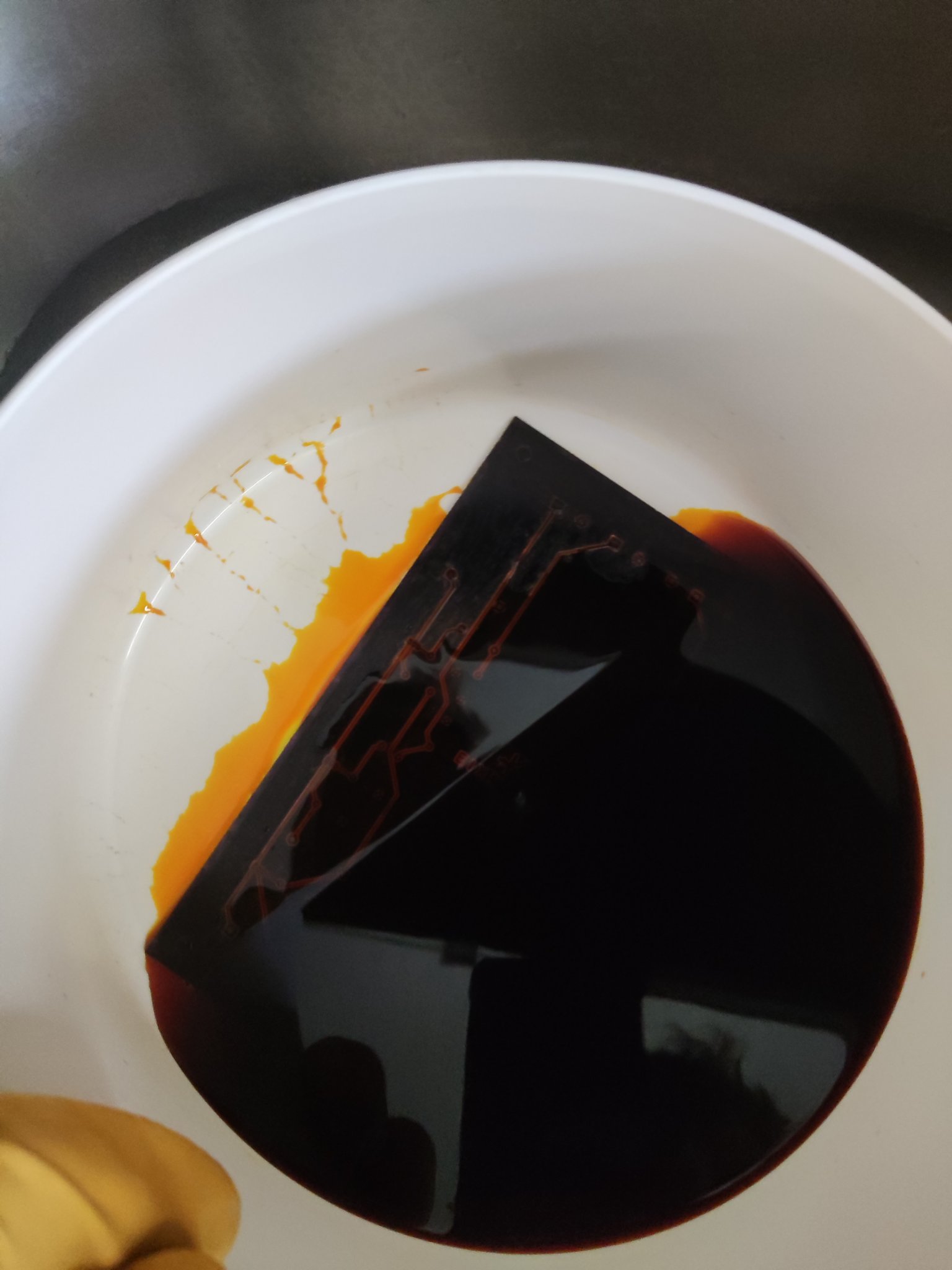

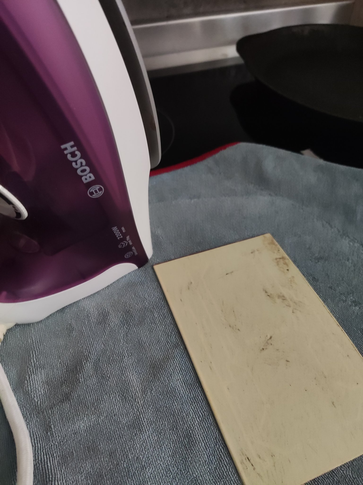

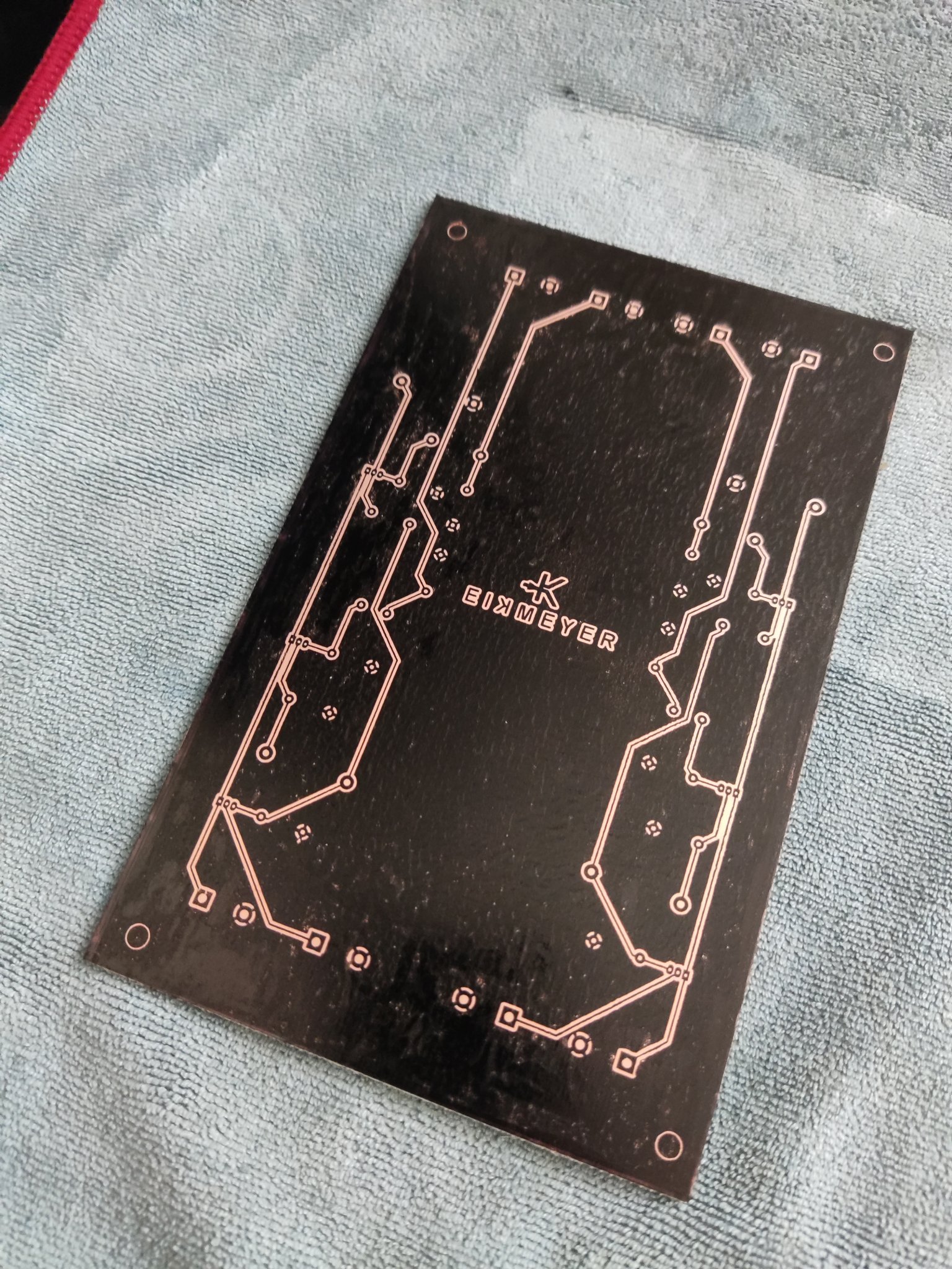

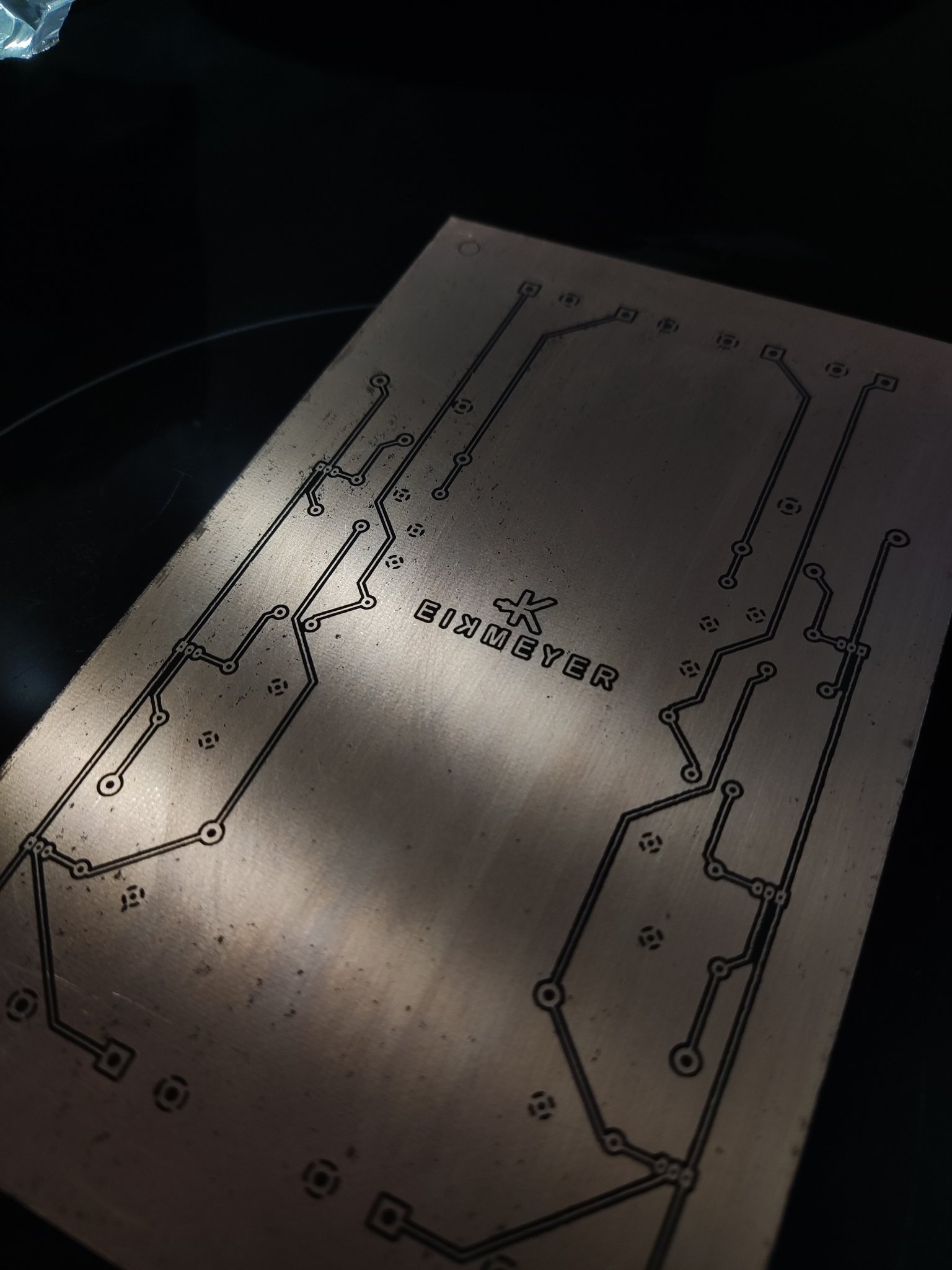

Today i found some issues in the first design. So i updated the schematic and PCB files. I also added a ground plane to the crossover. Will update the PSU soon.

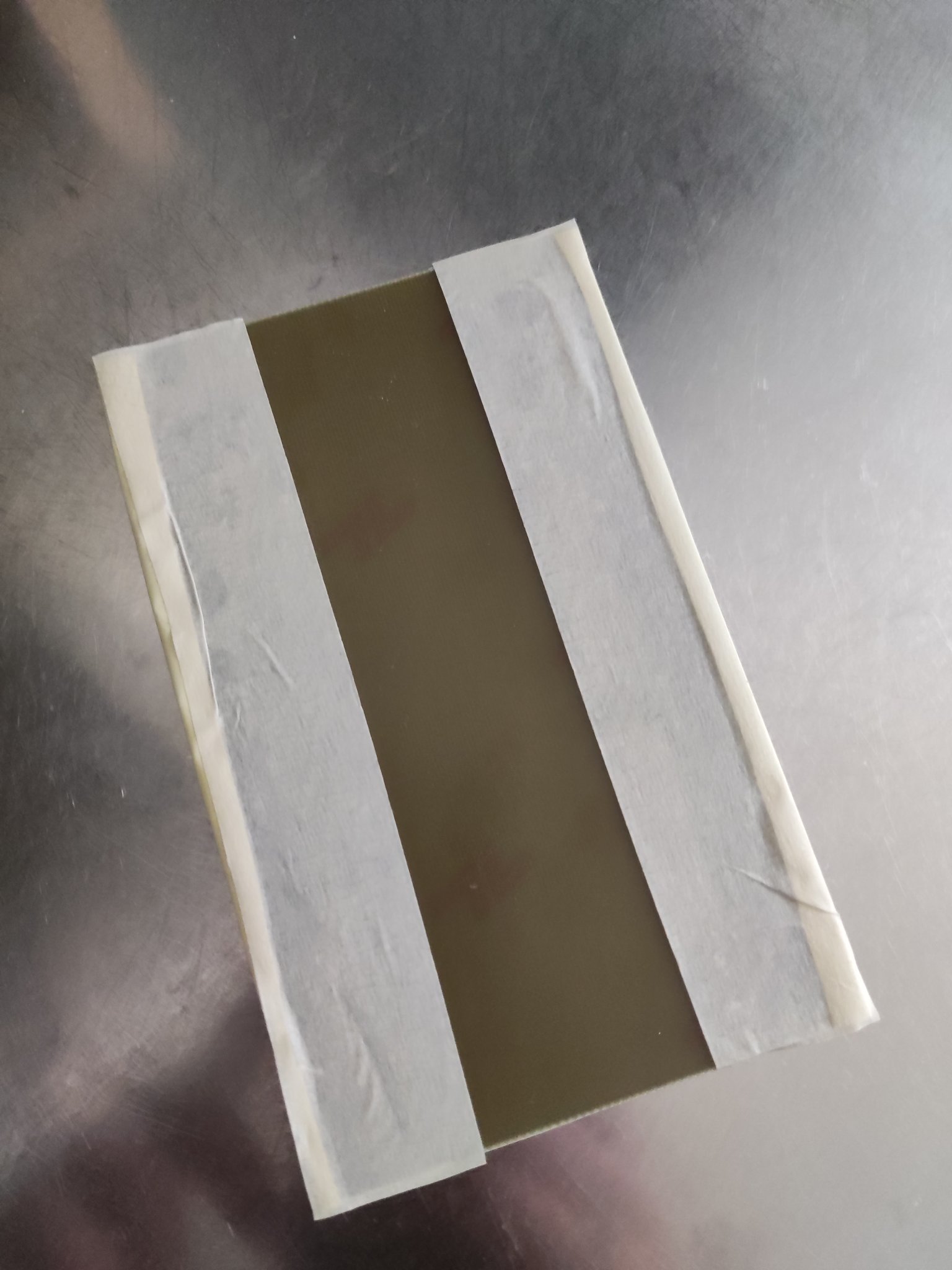

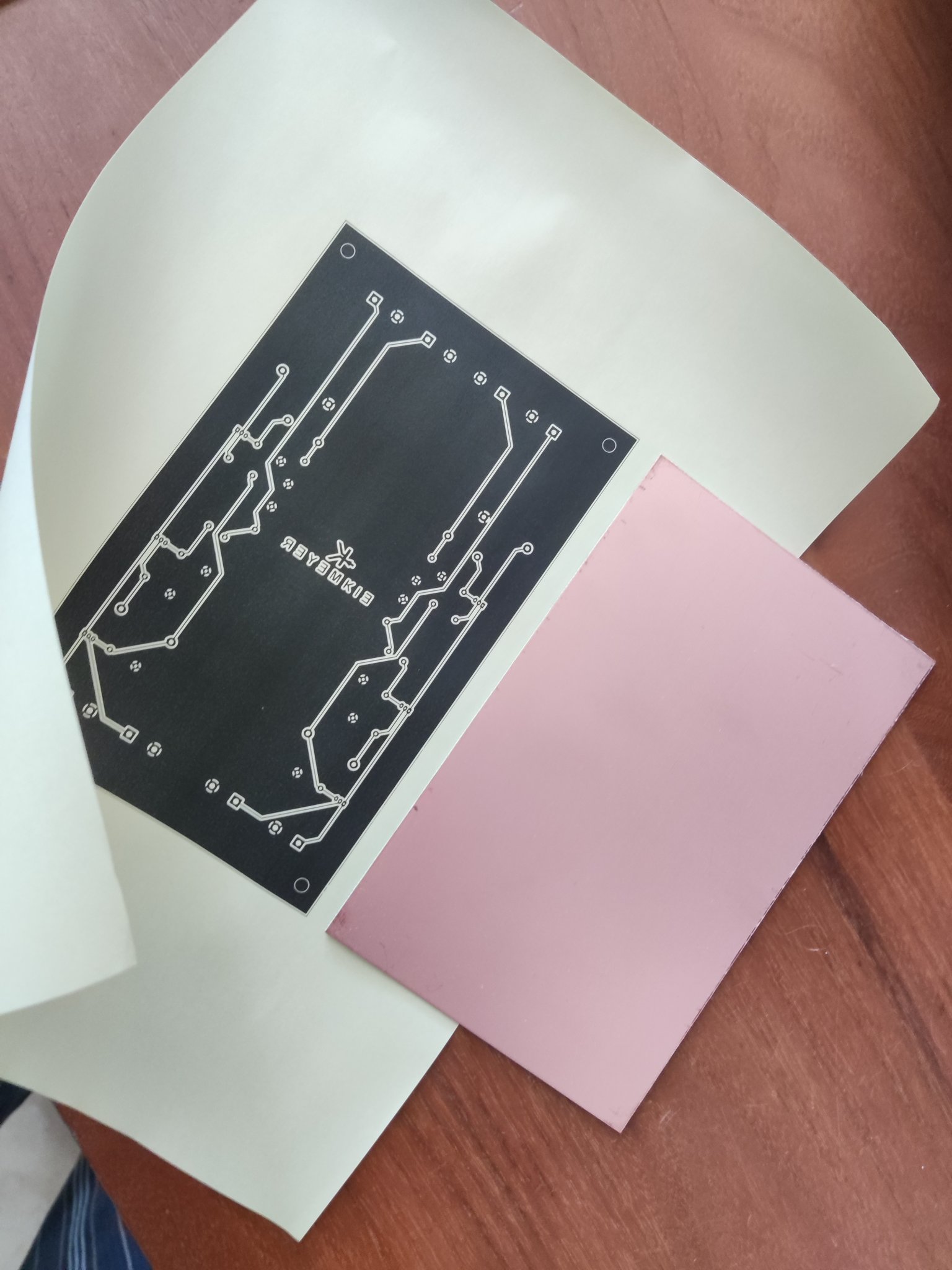

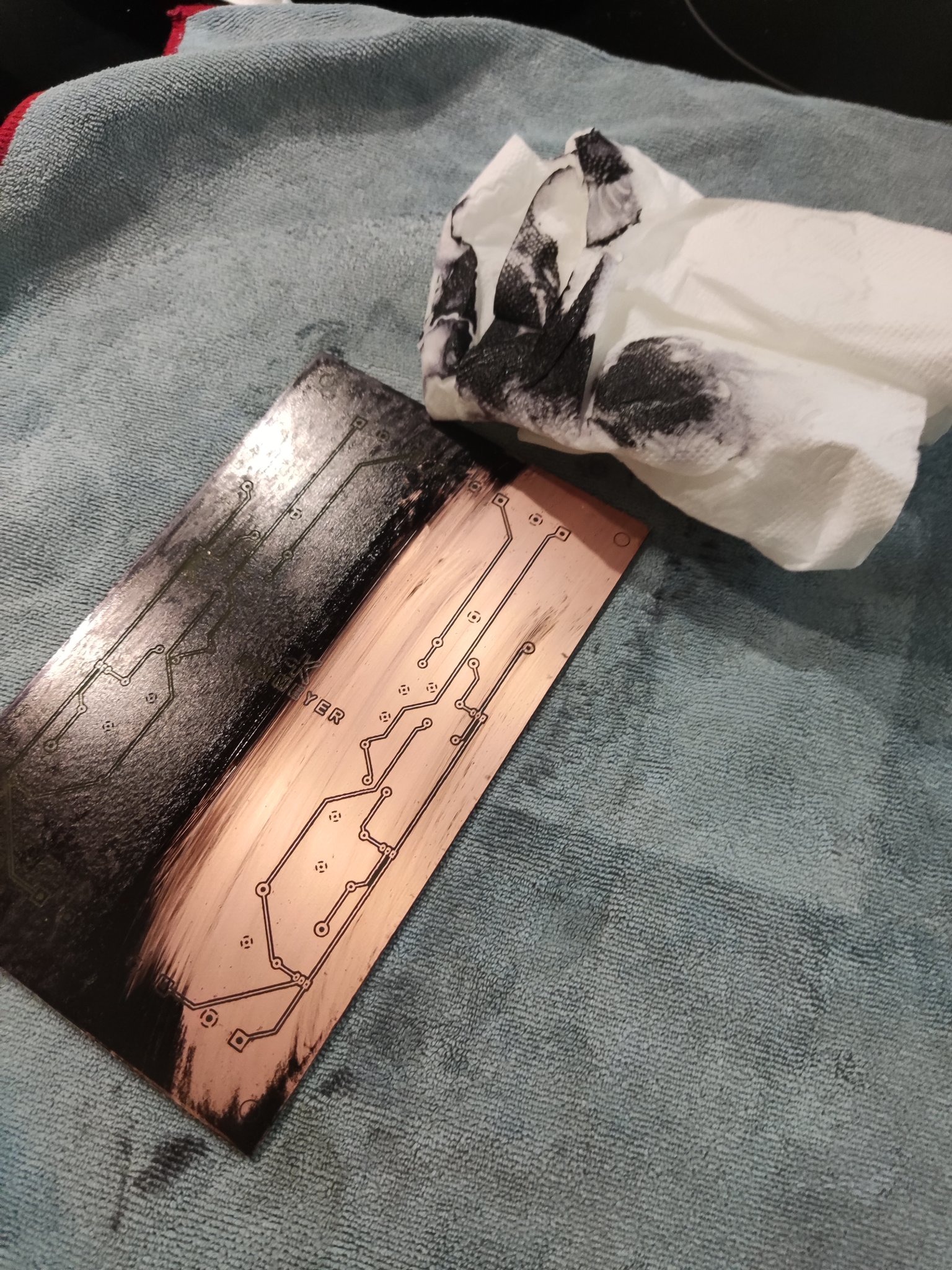

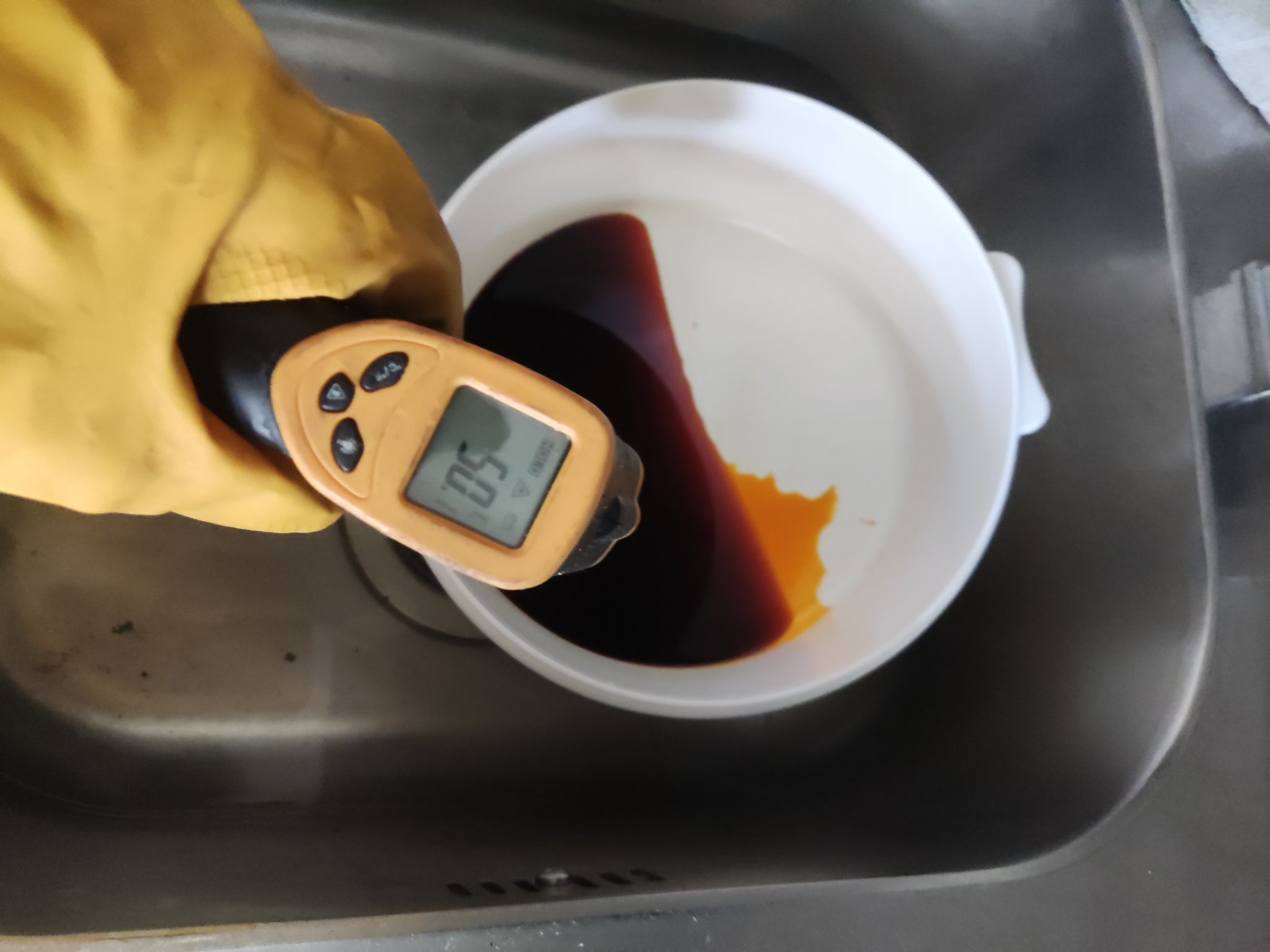

I etched the crossover PCB today. I used the toner transfer method and got a very good result i think. Also i added my name to the PCB. Because it sounds better when my name is on it. That's why manufacturers put their name on their devices. It just sounds better.
However, you can anytime remove it. Not sure if it will even show up on systems without the logo footprint installed.
Maybe it's a good idea to directly solder the components on the copper back. Then it's easier to change PLLXO values.
I still find it a bit difficult to work with KiCad. The tracing is still not perfectly symmetrical. But at least i managed to make the overall layout less confusing with shorter signal paths. I would be grateful if anyone with more experience could clean this up.

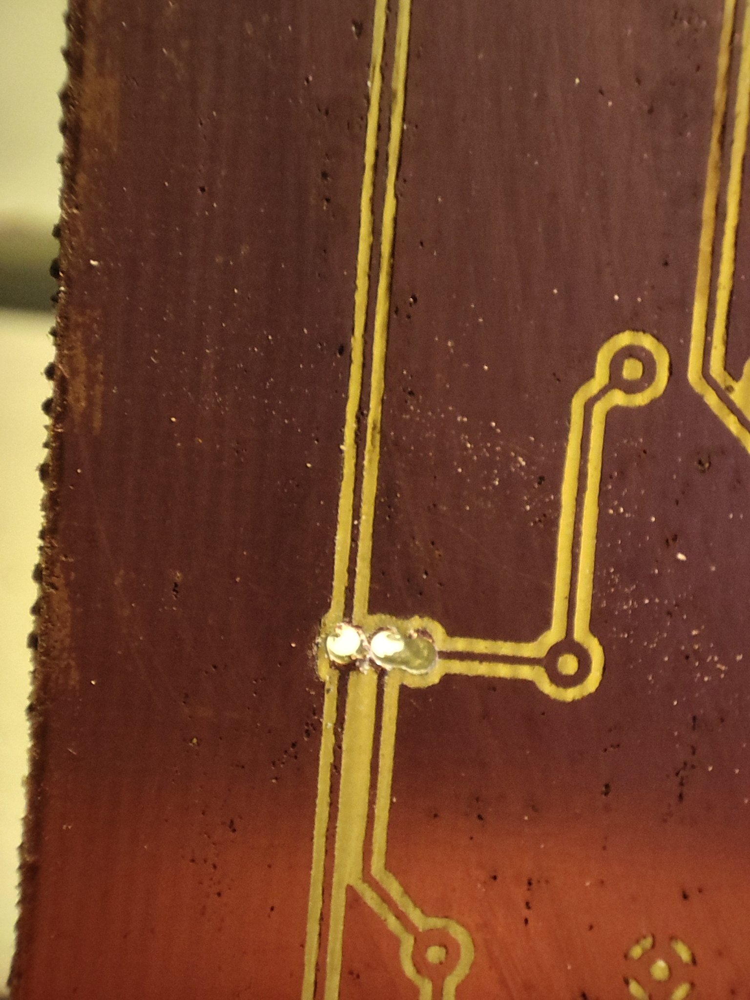

V1.1 went wrong while drilling the PCB. I should have used bigger pads for the Jfets. Oh well...
Actually maybe not that bad. I already mentioned it would be nicer to have the CU on top of the PCB. Then i can also etch the names of the pads and it's easier to change PLLXO values on the fly. Maybe some sockets would also be good. But actually i already know what values i will use. This will be sort of my final XO because i am basically done with what i wanted to build over all the years.

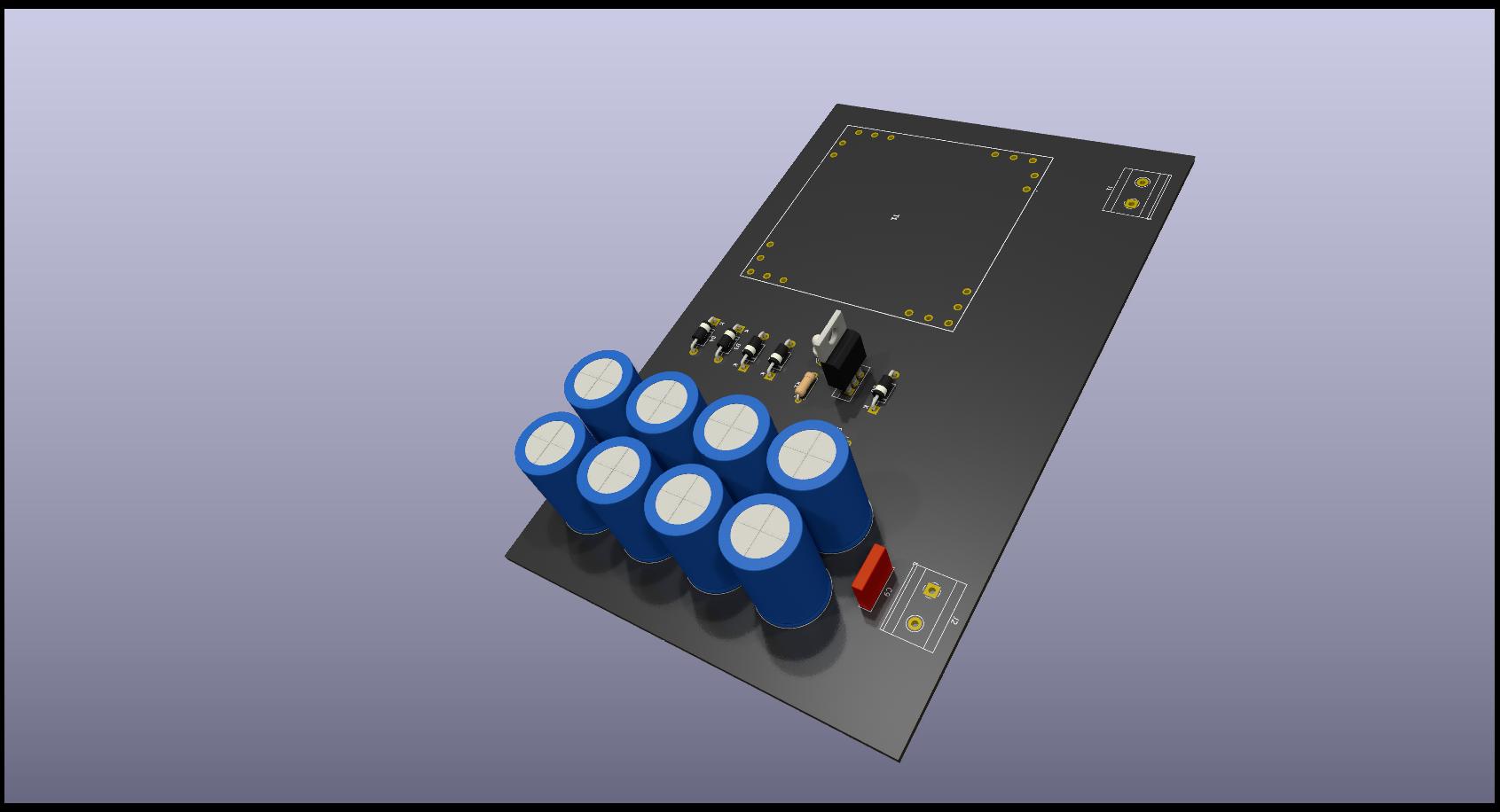

just saw this thread and unzipped and opened the files.
Well, to say it frankly ... too small pads are not the only issue -and certainly not the biggest- You might think about again.
Both the XO as well as the PSU leave a lot room for improvement.
The possibly biggest issue for me is the self-biasing of the 2SK170BL JFETs by a 1k resistor, supplied from a single 12V power line.
The SK170BL works almost under cut-off condition, but still it´s Vgs is too small to allow for a suitable input and(!) output signal voltage range ... as such distortions will be high.
Due to the very low idle current it will also not be able to drive an attached load properly.
--> You might chose a different JFET that is better suited to this application and that is not long obsolete and almost impossible to source.
Adding to these problems is the complete absence of local supply line decoupling caps.
The Layout itself is also quite debatable ... I wouldn´t be too surprised if You would get air born interferences.
Similar problems occur on the PSU board.
Way too much capacitance after the rectifiers and almost no capacitance after the regulator.
At first glance the 100R resistor might be a bit low on wattage/heat-capacitance.
The tracks on the PCB are long and tiny again .... no gnd concept on both PCBs.
Your circuit requires a major redesign to become a properly working and well sounding XO.

Hi Calvin, thanks for your honest reply and time.
Actually i am running a similar circuit in my preamp for 10 years. I am using the two jfet stages to buffer the volume pot. And it sounds really good. I measured distortion back then when i built it with something like 0.0027% THD if i remember right.
However, you are right. There are still issues and i already redesigned the circuit. I even forgot to add the ground plane... Goodness. Also i didn't add a gate stopper.
I still think the 2sk170 are worth it. Initially i wanted to use them because i still got some pairs i matched in 2010. Also there are still offers for matches BL and GR types on ebay.
What do you think about Vgs? Should i just raise PSU voltage or lower the resistors? Maybe use LEDs as CCS? I would like to keep it all minimal.
And sure, single ended minimal circuits will always have room for improvement. But on the other hand there is always something nice and special about the results.

btw. which ESLs and amps did You build or modify(?).
I assume it are Acoustats combined with Your own subwoofer-build?

Hi Calvin, i have built quite many ESL panels and true ribbons overs the years. I started building hifi gear together with my father in the mid 80ies when i was still a kid. Quite contrary to my knowledge about Jfets i have some experience with building drivers 😉
Right now i am using Martin Logan CLS2Z panels, which i got for quite cheap, directly coupled to DIY tube OTL amps based on early prototypes from Klimo. Very moderate voltages around 2.2kV on the diaphragm and 1kv PP. I also own a pair of Acoustat Model X servo amps, which go higher. Like 5kV on the mylar and 4.5kV on the stators. An easy job for the CLS2Z. The CLS were originally designed for 5kV and later they went lower to something like 3kV because they had problems with wear on their early coatings.
I am crossing them over at 200Hz first order with two pairs of the very rare Fostex SLE30W "edgeless technology" woofers. I made experiments with higher orders and other crossover frequencies, but this combination sounds the best to me. The Klimo OTL don't have EQ in the input stage. And actually i don't need it when crossing over that high. The Acoustat Servos do have EQ and that pretty much makes sense when running the CLS full range. Although i find slight damping with felt on the back and adding "wings" to the panels for avoiding early acoustical short do the same job a bit better because there is less excursion on the diaphragm at lower frequencies.
However, this is probably my last build. At least i hope so. I have a garage full of parts and gear. Since i'm self employed it's simply overwhelming to have so many open projects and i simply want to build a complete chain from the best parts and sell the rest. Currently i want to move over from my old minidsp 2x8 to some other active or partly active analog crossover. Hence is started this thread.
For jfets i feel the same like you, they sound more organic than OPAs. There have been times i knew more about Jfets. At least when i take a look into my old notes. Thing is i have ADHD in a form that allows me to learn things very fast as long they are in focus. But once they are out of focus i forget about them as fast as i learned about them. That's probably why there are so many mistakes in the files i posted.
The last three days i started to learn Jfet again and right now i'm scratching my head about what i have posted here 😁

Attached is a XO-circuit to give You an idea I´m talking about.
Its utilizing SE-JFET-Buffers for a curved non-segmented panel, and comprises of a High-Q Highpass, a high-Q notch and a soft-notch.
Three simple ccs-loaded Followers and a fourth more potent bipolar-pimped one are all what´s needed.
The two Notches are basically simple parallel RCL-Notches where the L-part is synthesized from a cap and a buffer.
You could even omit with the Notch-Buffers if You´d go all passive, using real inductances.
Though it may look complicated at first glance there are only two active devices in the signal path, J1 and J7 (maybe also Q1).
I used this style of XOs in my systems and they played much more authentic and lifelike than OPAmp XOs and IIR-DSP-filters.

I didn't give up (yet). i made a new design. It is a single channel for now. I will add the second channel later. I still have to figure out how to accurately mirror a layout in KiCad. Will have to do that manually i think. I also integrated the PSU on the same board. Not sure about the ground concept. But should be good as a starting point. Also i decided on a second order filter. I will leave the 2SK170 because i have 6 of them here and i want to use them. If i had more i would change the bias circuit. So for now this is a voltage divider bias. It's basically the exact same buffers i built a decade ago and which never made any problems and sounds really good. I would appreciate if someone could sanitize what i have done here.
Thank you!
I'm using a SN97CU3 soldering paste that is normally used to solder copper tubes. I'ts simply pasted thick on the tracks and then i bake it in an oven at around 160°C until the paste appears to be dry. Then you can rub that stuff off with some luke warm water.
Here's a link to the paste.
https://www.conrad.de/de/p/felder-loettechnik-sn97cu3-lotpaste-inhalt-250-g-2226426.html
Only use electronic solder for PCBs, plumbing solder usually has agressive acid fluxes that will rot a PCB's thin traces very easily over time. (The acid permeates the fibreglass and leaches back later).
The usable lead-free electronic solder is 95% tin, 4% silver, 0.5% copper, which is a eutectic (important for hand soldering). Chipquik do a large range of pastes for electronics.
I'm using this method for 30 years now and never had any problems. My father used it for additional 20 years before me and his PCBs show no sign of what you describe. I believe you, but i guess the issue you describe is more of a hypothetical nature, or is related to other mixtures of solder pastes.
I also used a similar method. It's probably important to clean all residues from the pcb immedately after tinning.
