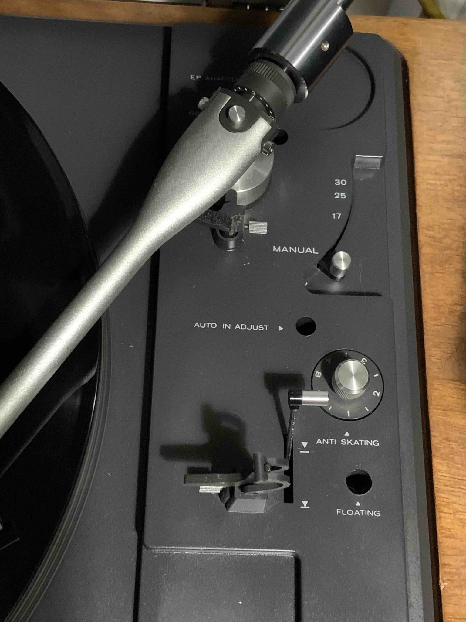

1) the lifting up and down of the tone arm - it sort of but doesn't really work. I've tried to manually readjust and it's ok briefly but then it sags even if the silver screw is tightened. How can I solve this? Any other decks with a similar mechanism with an online refurb vid?
2) What are the 'floating' and ' auto in adjust' all about? I've not seen those on other decks.
3) does anyone have a service manual?

The silicone damping fluid is gone, so you would have to replace it, or else install a new cue mechanism.

Floating refers to the chassis suspension lock-down. There are four total locking bolts on top of the deck.
See figure 4 in the attached manual. They must all be removed for the suspension to float freely.
The In-Adjust is for the set-down radius adjustment. See page 12 here:

Usually people lose the suspension locking screws immediately after it's set up,
so if you just have 4 holes, it's ready to go. Some turntables have the screws permanently attached, though.
When the tone arm sets down, if the stylus misses the lead-in groove, tweak the in-adjust slightly
with a small screwdriver to get it in the right place. It won't take much of an adjustment.
