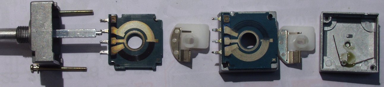

My beloved Kenwood l-07c started to have issues_scratching and weak sound on left channel. I think the problem lies at the gain attenuator/balance control. I opened it up and intended to clean the attenuator with contact cleaner but could not as there are no openings on the part for the contact cleaner to get in. I spayed some cleaner there anyway. All 2 channels worked properly briefly and then gone bad again. There is so LITTLE info on the Kenwood L series amps. I am hoping someone might have knowledge on the problem with the Kenwood. It is really a wonderful preamp. It has served me so well with my pair of Kenwood L-09M. I will be so upset if I can not get it fixed.

If you can't find an access pont for the contact cleaner, it would appear to be a sealed dual concentric pot.
Unless a sealed pot can be dismantled (difficult) for cleaning, the only option is replacement.
If a dual concentric replacement is hard to find, and you don't often need the balance function, you could use a standard stereo pot and join the two separate halves of the volume knobs together with glue or a connecting pin.

Maybe it's worthwhile removing the control and trying to clean it. There may be small openings that are not visible now. Use only a brief shot of cleaner at a time, though. More is not better. Exercise the control, another shot,
and more exercise. Then try it out. It is possible that the control is worn out, but if it worked for a while after cleaning, maybe not. Also clean the subsonic switch.

You can get an idea of what s need to clean these type of sealed control here:

Tvi, that is it what can be done. Reading from service manual, there is a specific illustration on what to do with the “attenuator” in that the wafer can be replaced, not the entire rotary switch. I am almost sure the wafers can be cleaned as well as the pockets they reside in. But for now i will wait..
