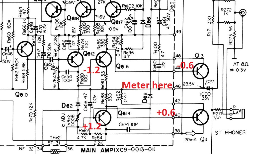

Another easy way to look at this is put your negative meter lead on the midpoint and then measure the voltage to each output transistor base and driver base.
For your 31 volts you should see:
31.6V on the base of Q4. So your meter should read +0.6
32.2V on the base of Qe14. So your meter should read +1.2
and
30.4 on the base of Q3. Your meter should read -0.6
29.8 on the base of Qe16. Your meter should read -1.2
The '0.6' is an approximate value related to the forward turn on voltage of a silicon junction. You are looking for large errors such as anything over say 0.8 volts or lower than say 0.4 volts.

I'm going to repost what to expect as I've made some mistakes trying to describe it you. The upper NPN's that is Qe4 and Qe14 are as I describe and you should see the incremental change of 0.6V adding up as you work 'back'.
So with 31V on the emitter of Qe4 you should have +31.6 on the base and +32.2 on the base of the Qe14.
The PNP driver and the output Qe3 are where my description fell apart. The lower NPN output (Qe3) should see 0.6 volts between base and emitter.
The emitter is actually grounded and so we read between ground and base for that one.
The PNP driver (Qe16) will see about -0.6 to -0.7V measuring from the output (the midpoint) to the base.
Apologies for my errors describing that earlier. In essence all you are doing is checking the B-E volt drops which always are in the 0.6V region. Measuring from fixed points like the output is sometimes easier and safer than trying to prod two leads at once on a small device as one slip would be disastrous.

ok Mooly, on the base of Qe14 with respect to pin44 base of Q3...Qe14 is reading +48V and Qe16 base is reading +39V...that is way off. I did replace the Power Transistor Q4 which was originally 2SC1060 with a MJE3055 which I was told would be a match or cross. What do you think? oh yes on the base and emitter of Qe3 i am reading .627V
Those readings do sound off but lets be sure and let me try and make it easier to follow. If you have 48 volts from Qe14 base to the base of Qe3 then that really means the midpoint voltage should be very nearly equal to 48 volts... and you have 31. So 17 volts is being 'lost' across the base/emitter junction of Qe14 and Qe4. So yes, something is wrong there suggesting a possible open circuit junction in Qe14 or even open or broken print.
1/ Make sure you still have the same incorrect midpoint voltage of around +31 volts as measured from ground. If the reading is significantly different then just note down what it is and continue...
2/ Place you black meter lead on the midpoint position and read the voltage on Qe4 base with the red meter lead. You should read approx + 0.6 volts.
3/ Now place the red lead on Qe14 base leaving the black still on the midpoint. You should read 1.2 volts.
4/ Now place the red lead on Qe16 base. You should read approx -0.6 volts.
5/ Place the black meter lead on ground (chassis) and read the voltage on Qe3 base. It should be 0.6 volts.

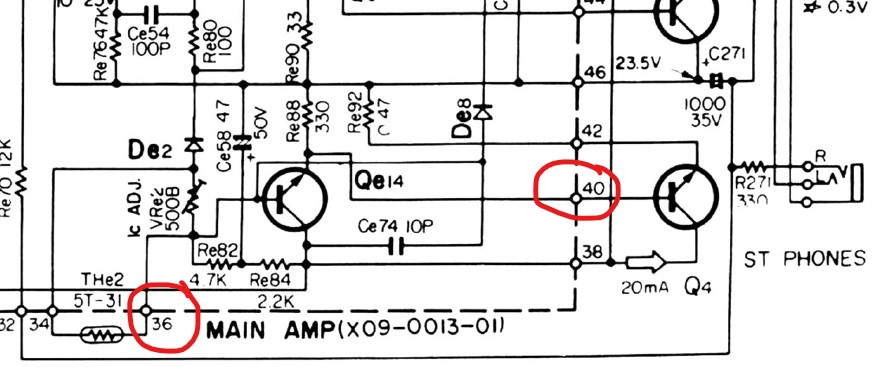

Qe14. Put your meter between pins 36 and 40 on the board. You should see 0.6 volts.
Qe16. Place your meter on the striped end of the diode D62 and the other lead on pin 46.
That gets you across the B-E junction of each driver.

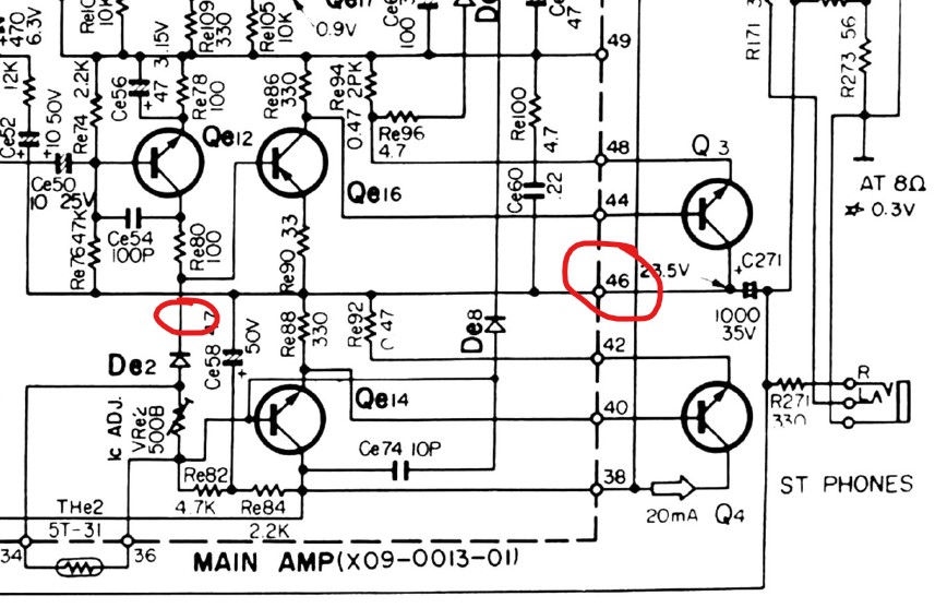

Qe4 base is pin 40 on my diagram, and pin 44 is the base of Qe3. The midpoint is pin 46.
There shouldn't be any truly negative voltages anywhere, that is voltages with respect to ground.
I'm going to post my copy of the diagram and the voltages between the pins. Give me a minute, then I have to go
