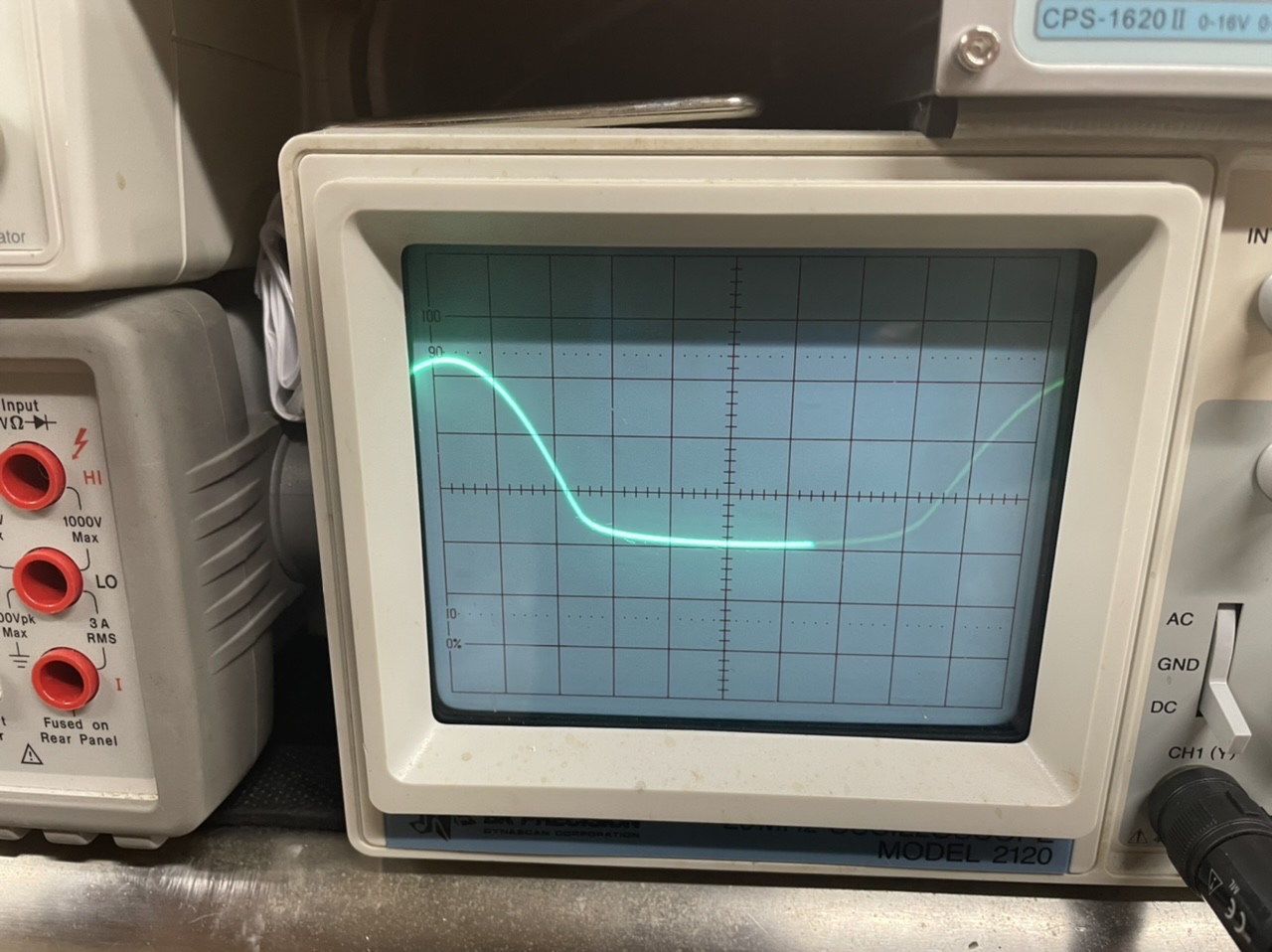

Now under load, the amp will only get to about half output (40A draw from bench, about 35vAC across speaker terminals), before acting up. The bottom waveform gets very distorted after that and the amp struggles to output anything higher.
Problem seems to get way worse at 2ohm load vs 4 ohm load where the amp will falter and output a similar screenshot but at 18A draw instead of 40A @ 4 ohms. Rail voltage is +-87vDC the whole time and the amp is not starving for bench power which is staying above 13.5vDC the whole time.
Any clues? Service manual?
Scope set to 20v/div. Inputting about a 75hz sine wave.
Its worth noting that with NO load, the output is absolutely fine looking out to clipping.

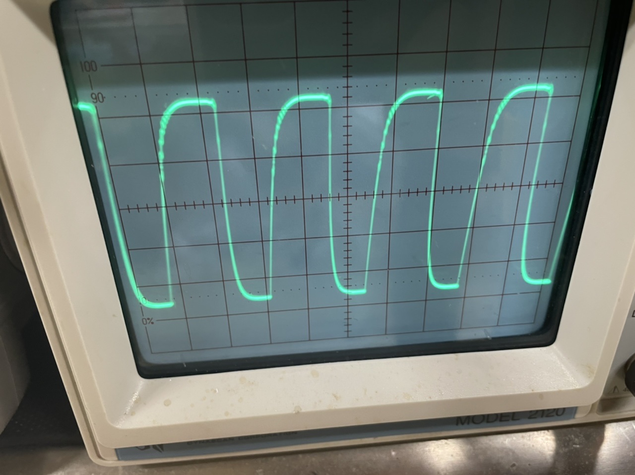

Found something interesting. If I put my scope probe set to 1X on the base or collector of Q304/Q306 OR Q303, the amp will pull out to 90A at 2-ohm clean. My probe is loading the circuit slightly. Also looks like the drive signal off of IC241 pin 3 and 11 is OK, but the signal on the base of Q304/Q306 and Q303 is rounded. Photo.
Q304/Q306 & Q303 are measuring OK in circuit. I'm actually wondering if reducing the 4.7k resistors at R301 and R302 may help? Seems drive may be weak here for some reason.
Or it could be IC241 is going? Is that even an audio device?
