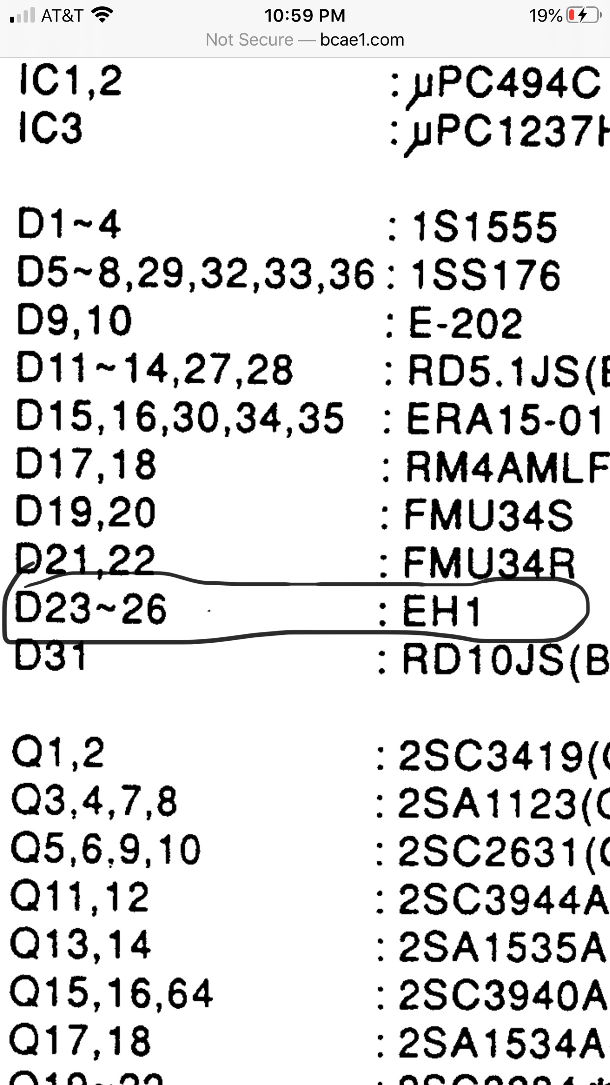

Will this one work UF1003-T Diodes Incorporated | Mouser
And wondering if all the diodes are the same according to the schematic .
Since there are multiple diodes with the same board locations
And the diodes I took out have all different part numbers and they are shorted
I think that will work. This is the rectifier for the driver voltage for the output transistor drivers. I don't know how much current they need to handle. I initially looked at 1 amp diodes but saw the 4 amp of the same size so I picked that one.

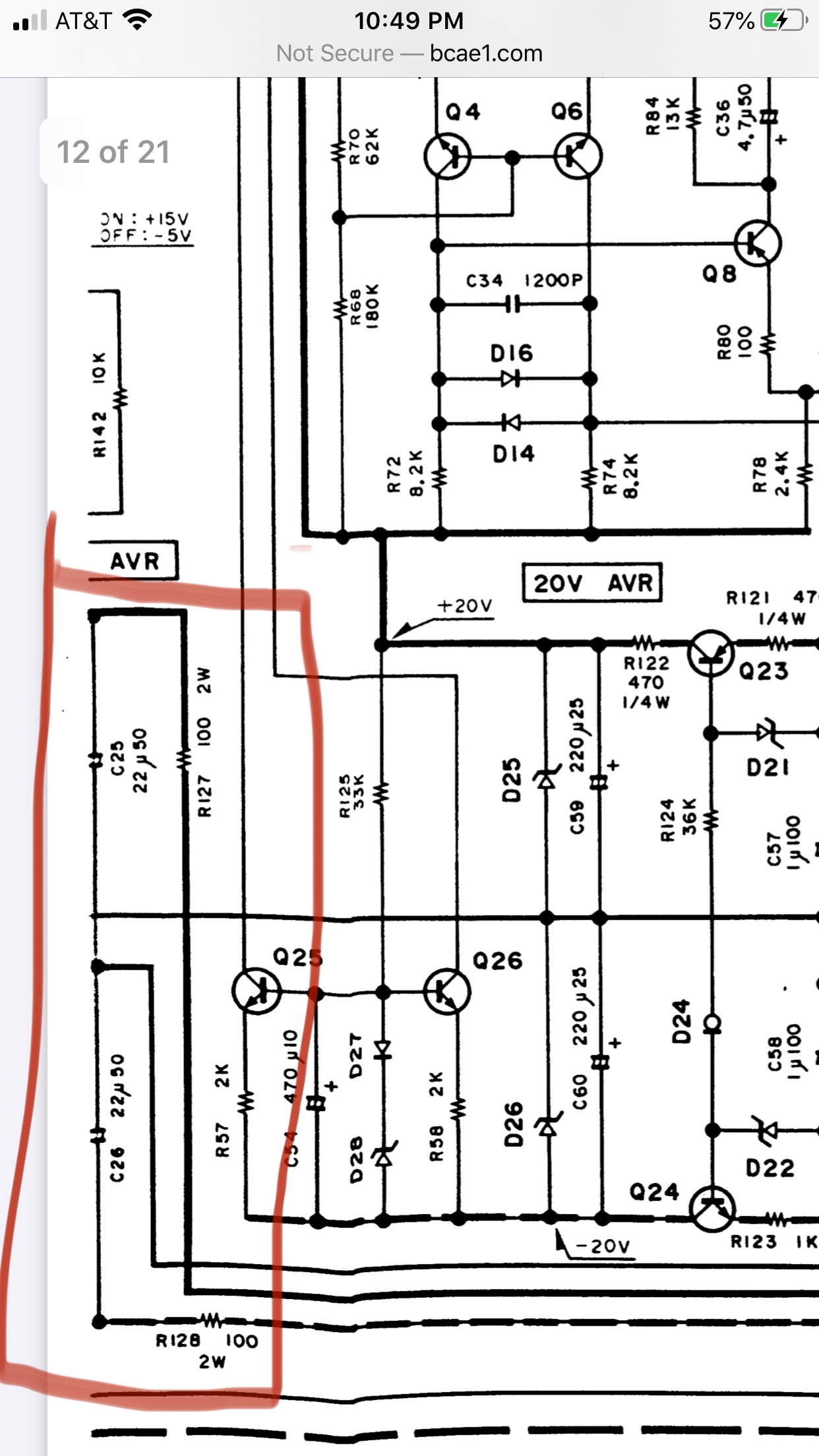

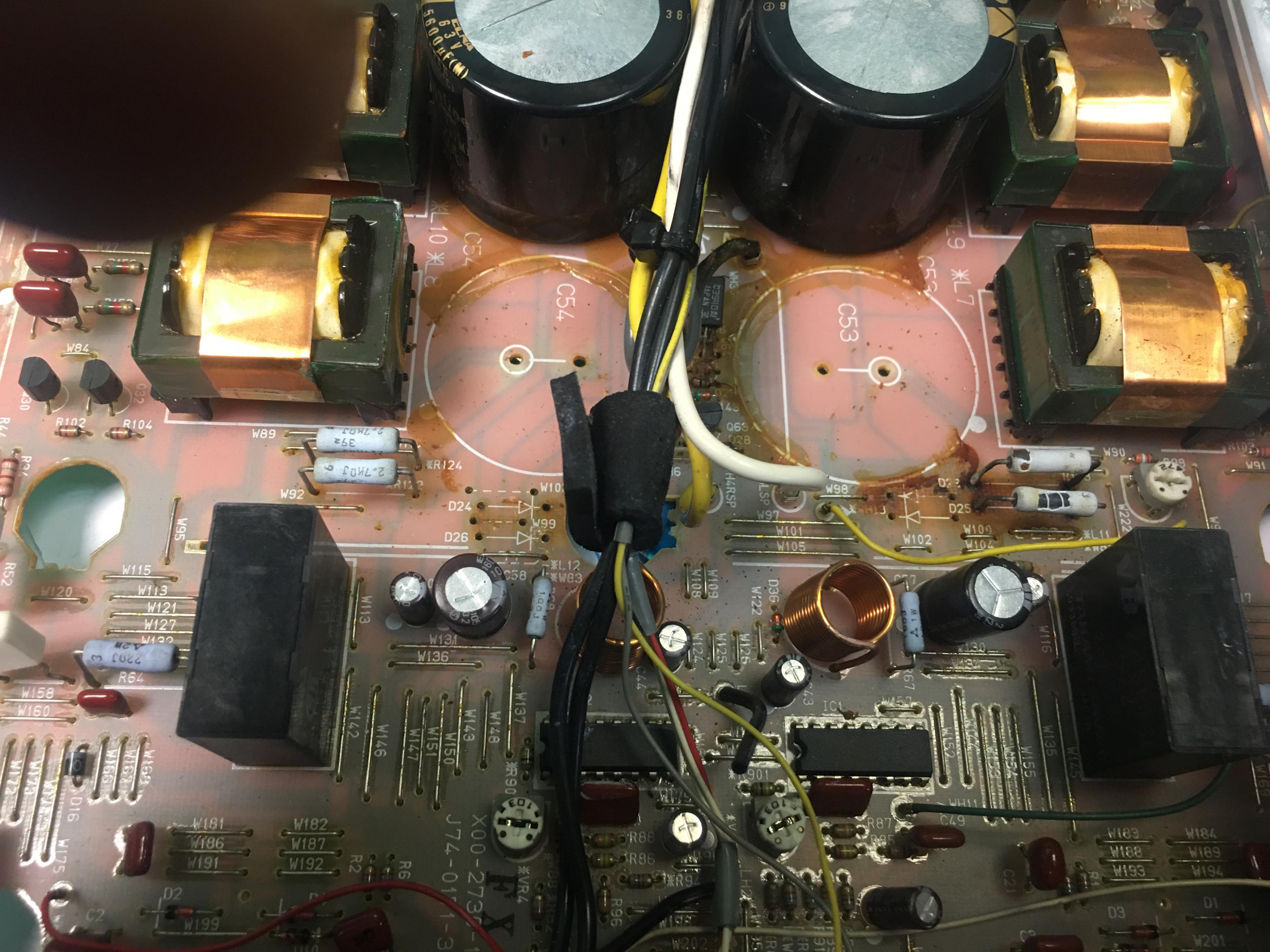

I found some 2 watt resistors on the board near the rectifiers .
2 of them are 100 ohm and measure 109 ohm
The other 2 are 270 ohm and measure 277 ohm
Are these ok to run or should they also be replaced ?
I don't see them on the diagram. If they're 10% tolerance, they're OK. If they're 5% tolerance, they are very slightly out of tolerance but likely OK.

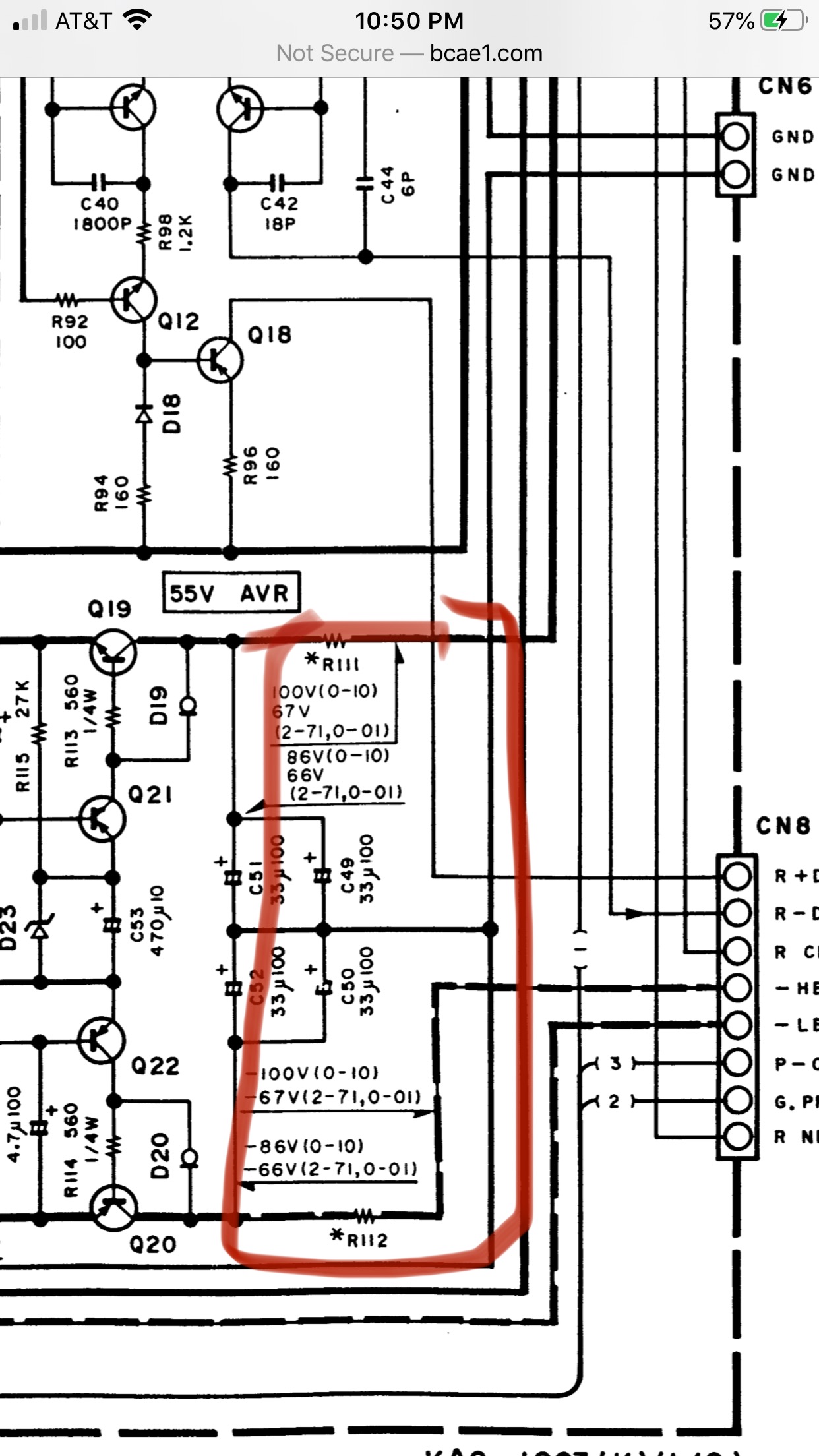

Find the resistors on the diagram and send me a page number and map reference from the page.
It’s on page 12
Also the values are listed on page 19
Those aren't near the rectifiers or on the RCA board as far as I can see.
I think they're OK. If you have them, replace them. If you have to place an order just for these parts, I don't think it's worth ordering them.
I just double checked and your right my mistake .
They are on a smaller board .
