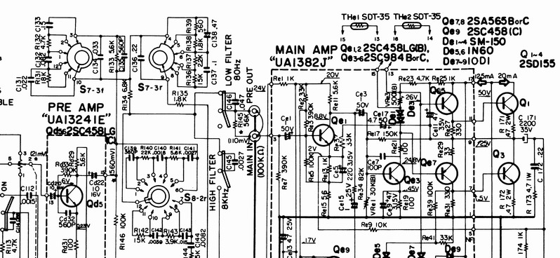

I have a few questions about amp design. Before...here is the story. A friend of mine at work asked me to repair his beloved Kenwood KA-2600 for second time. First time we both worked on it because he wanted to learn how to troubleshoot dead amp. We found the amp protection circuit, one driver transistor and few caps dead, it was ok repair. He was happy again. He is musician with good taste for audio and he loves this amp. He has bunch other amps and receivers he likes less. First time I did not bother to listen to this amp, I just repaired it at work. Second time he brought it, I took it home. It was shorted power supply, bad insulation. Easy repair. This time I managed to listen to it. Man, it sounds great. I mean it. Now I know why he keeps it around. I compared it to two Onkyo audiophile amps I had that time and they did not even come close. They sounded boring in comparison to this one. This amp is sparkly clean, juicy, just fun to listen to. It reminds me good tube amp sound.
Anyway, I am not an expert, this is just my hobby, I just built and listen.
Could any of you circuit experts have a look at the circuit and tell me what makes it sound so great? Seriously, it so damn old and yet is sounds way better than today's mainstream media stuff.

Nothing special. Just a good, clean design. Uses NPN output transistors, capacitance coupled to the load. It's actually close to being a low end unit.
Maybe what's happening is that you are driving it too hard and just happen to like the sound of that clipping distortion.

On your amp , the "vital" bits are that the input stage is "single ended", which means the distortion produced rises far less sharply with frequency than the LTP used these days, it's also mainly even harmonic.
The output stage is a "quasi complementary", worse than the full complementary designs of today in respect of linearity, but again, the distortion produced is the "right kind".
what makes it sound greate is not the amp it shelf but the all thing together ... this type of circuits have a gozzilion errors compaired with todays hifi or high end standards ...
example of errors
limited bandwidth at both ends
capacitor coupled
no diferential LTP
absense of curent sources /sinks
terrible crosstalk figures
horrible tone control
generally amp like that will measure terrible
BUT !!!!
the all arangement will produce wonderfull sonics and add to the sound colours that dnt really exist but make the sound extremelly warm add to this that simplicity of most circuits makes it even better to listen and there you go ...
The problem is that you actually think that it plays well ....it sounds friendly.... it both plays and measure bad ... but friendly ...
do your shelf a favour and make construct any amplifier like the DX or the leach or the symasym or the P3A and use it just with a pot in the input and our favourite music and source ... it will be compaired next to nothing with any of your comercial equipment ...
Thanks Mooly for this comment, I have seen it mentioned before quite a few times and there is lots of folks which seems to prefer the sound of SE to differential input.

I am not sure if it has horrible tone control. Can you explain what you mean?
Its tone control uses series of switches rather than pots, which might be better. Again it uses single stage before the tone control...which can give it certain pleasing tone. But I would not call its tone controls terrible.
