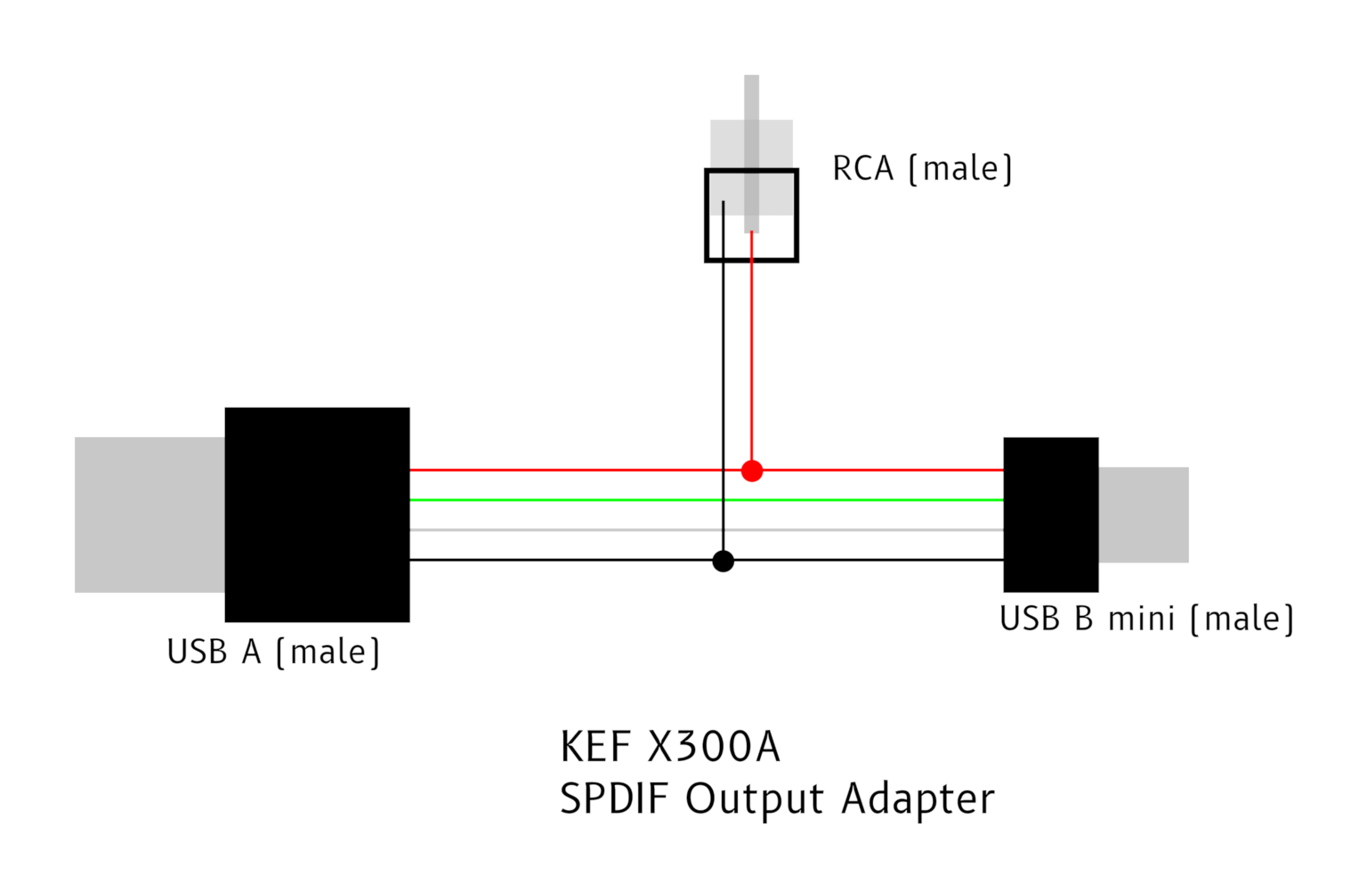

(Inexpert) drawing as promised:
USB wiring is (normally):
Black: Ground
White: Data-
Green: Data+
Red: Vcc (+5V)
X300A wiring is:
Black: Ground
White: UART rx
Green: UART tx
Red: SPDIF
A simple hack is to:
Black: Ground
White: Data-
Green: Data+
Red: Vcc (+5V)
X300A wiring is:
Black: Ground
White: UART rx
Green: UART tx
Red: SPDIF
- Solder the wires of two USB pigtails (the two halves of a USB patch from X300A Master to Slave) to a small prototyping board
- Connect all signals (red to red, black to black, etc.) so that the pigtails connect the X300A Master to Slave correctly.
- Connect a short wire to an RCA plug (or jack, to taste) as shown, Black to the shield, and Red to the center, as shown

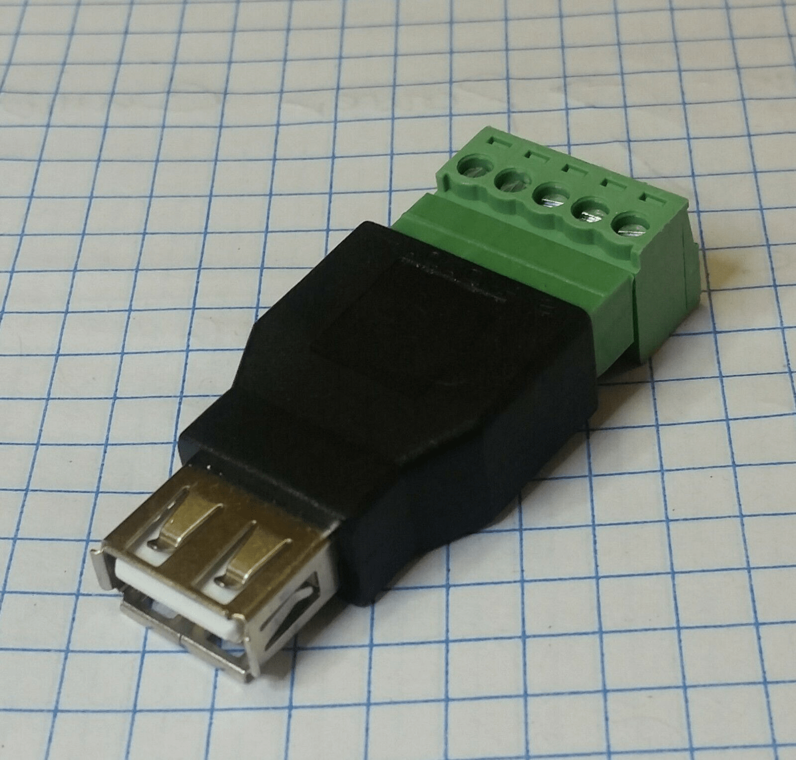

As I've mulled over better/easier/quicker ways to implement the hack, I came across this USB breakout connector, which could be used instead of the proto board and mini USB (and doesn't require any solder!):
- Connect the USB A male pigtail to the connector
- Connect an RCA jack pigtail to +5V and ground, as above.
- Plug the connector on the pigtail to the Master inter-speaker connector, and plug your same old USB cable into the connector to go to the Slave unit.
- KEF X300A Subwoofer Output (finally) solved
