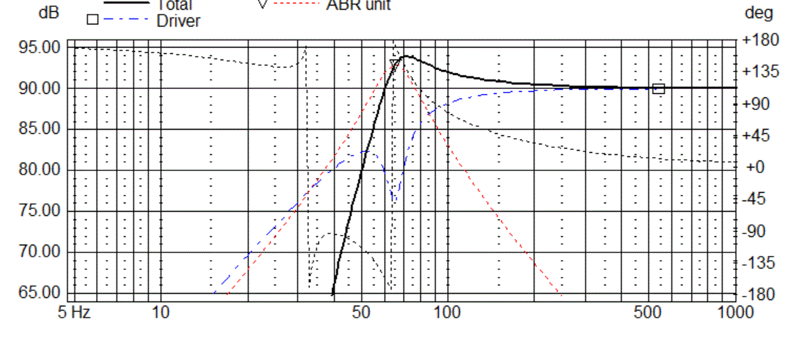

Tiny VAS, middling value Qts, very high estimated sensitivity and a highish value for the drivers fs. Still the tiny vas and middle value Qts would offset one another and the Qts wasn't so high as to make porting/PRing the driver unrealistic.
Simulating with the driver showed that with a PR tuning of around 67Hz resulted in a peaky response with a hump at the tuning frequency.
attachment.php
Not exactly what the doctor ordered but would definitely create a lot of 'thump' from the sub that could otherwise seem impressive but all the while giving hardly any real extension. I expected to get decent output down to 40Hz out of this thing.

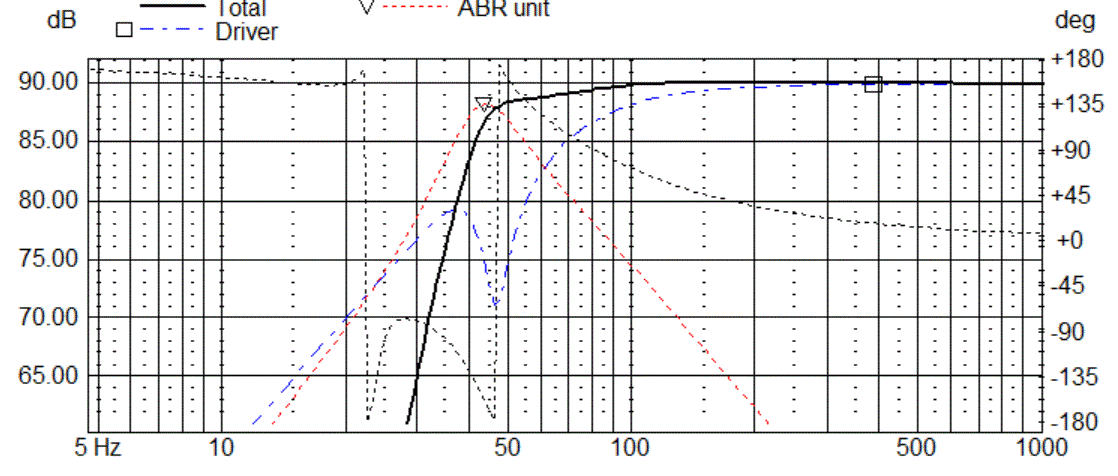

Adding mass to a PR lowers the tuning frequency and adding in around 20 grams pushed the tuning frequency from the previous 67Hz down to around 47Hz.
attachment.php
Much better. A nice EBS alignment that would benefit from room gain, lower group delay and give far more extension.
This was of course only in simulation so I got out the precision scales found a nearby solid object that weighed roughly the right amount (an empty printer cartridge :D) and glued it to the back of the PR with some 3M adhesive goop.
I then measured the tuning frequency and voilà it was pretty much where I expected it to be. Measuring the subs average frequency response, semi near field, with the mic being moved smoothly throughout an arc around the sub, resulted in a nice smooth response without any peaking down low and useful extension down where it really matters.

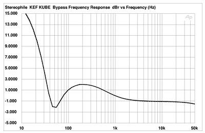

Kef is a company that has some really clever tricks up their sleve, so I think the design is as intended.
I think they've done the same thing that they do with the Kef Reference 107/2. The woofer section is tuned with a bump in the FR to get max efficiency, and then the FR is equalized to the wanted system FR. Then you waste no efficiency in the crossover. This technique, using a Q multiplier is quite common for subs.
Here's the internal EQ curves for the EQ module for the R107/2 (also called a Kube, BTW). The measurement is snagged from Stereophiles test of the 107/2.
Johan-Kr
Well like I said I measured the subs frequency response before and after the modification too. After the device showed a smooth extended roll off into the bass with a very shallow roll off that would be in part countered by some room gain.
You might be able to increase overall efficiency with a higher tuning and then EQ it flat but this only works over the frequencies centred around the bump. The higher tuning cripples the subs efficiency and output down lower, which is where I want a sub to be at its best. Still the sub showed no signs of complex EQ such as you described otherwise I would have measured it.
A highpass might be present but if so only a very shallow one, if higher in f3, or one that only acts quite low down if it is steeper.
