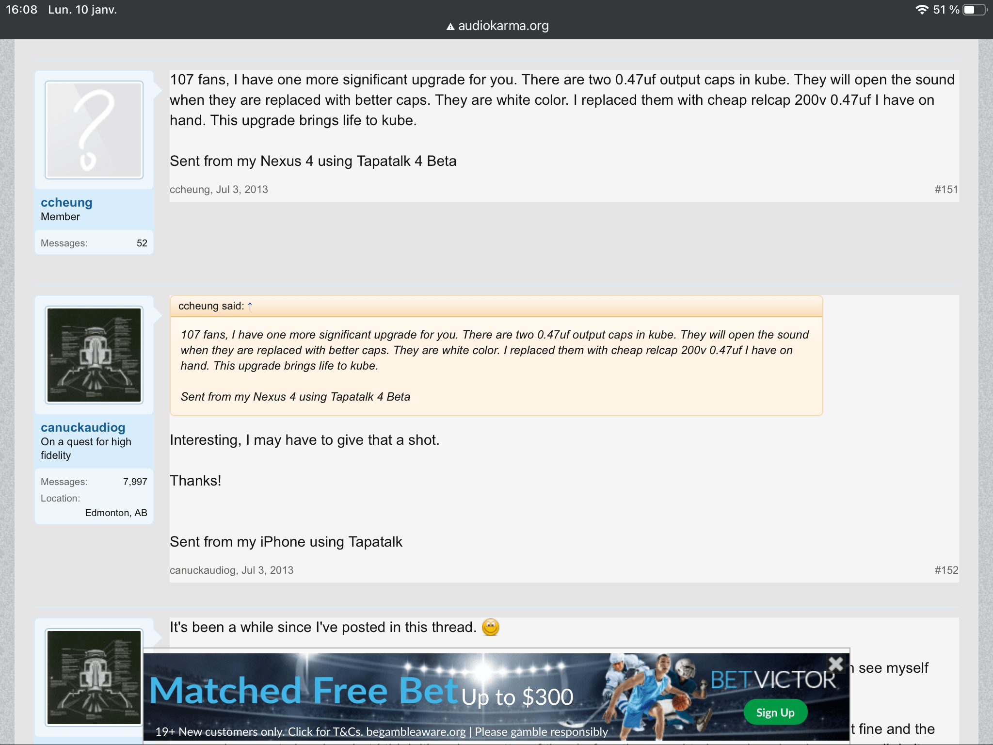

I did change the caps and opamps in my Kube, you can look up on aka [ Kube opamp upgrade]. While your there, there’s a official Kef 107 Owners registry.

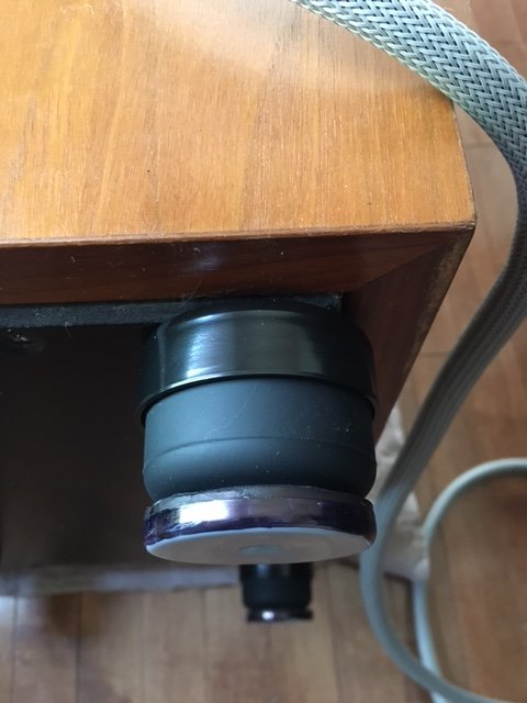

The feat on my Kef are SVS SoundPath plus some glider. They do a excellent job to minimize the vibrations on a hard floors. I know you have carpets, I put it there for general infos.

I was looking forward to reading your post "I did change the caps and opamps in my Kube, you can look up on aka [ Kube opamp upgrade]." but have not been able to find it. Is it on this DIY web site and if so how is the best way to find it.
Thanks in advance.... by the way let me know what amp combo you end up getting.
Found it quite easily:
https://audiokarma.org/forums/index.php?threads/kef-r107-kube-opamp-upgrade.552874/

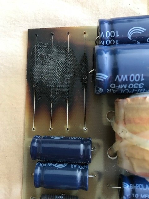

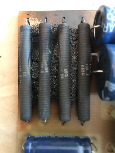

Hello Rbg, after my inquiry on my tweeters I open my Kef to look a little closer, I made a nice discovery. Both head assembly Xover have partially melted from overheating of the parallel 15ohm resistors. It dated before theses boards were recap. Now I’m in the process of restoring the Xover with new resistors farther away from the board and putting caps value to specs. Again your pictures saved my life and I would like to use 2 of them to put in my Kef 107 HF crossover thread if you give me the permission ?
I can image the lack of oumph and music imaging is due to the Xovers with values not enough close to the original specs, some of them higher than 10% different.
Even if the seller said that everything is was to its original specs, you can have some surprises, still I don’t regret it but I should have open them of before buying them for a more adequate price.

Hello Rbg, after my inquiry on my tweeters I open my Kef to look a little closer, I made a nice discovery. Both head assembly Xover have partially melted from overheating of the parallel 15ohm resistors. It dated before theses boards were recap. Now I’m in the process of restoring the Xover with new resistors farther away from the board and putting caps value to specs. Again your pictures saved my life and I would like to use 2 of them to put in my Kef 107 HF crossover thread if you give me the permission ? YES USE THEM
I can image the lack of oumph and music imaging is due to the Xovers with values not enough close to the original specs, some of them higher than 10% different. KEEP ME POSTED ON HOW THEY SOUND AFTER THE REPAIRS
Yes it would be interesting to see how replacement with high quality modern components would change the sound .....maybe someone has else has done so.Just a thought I wonder what these speakers would sound like if you replace all the drivers with NEW Modern ones eg. SB Acoustics and with DSP xover? I think it would sound totally different these drivers will give you a more forward and dynamic sound with even greater clarity. The sound will give you a modern presentation of music.
