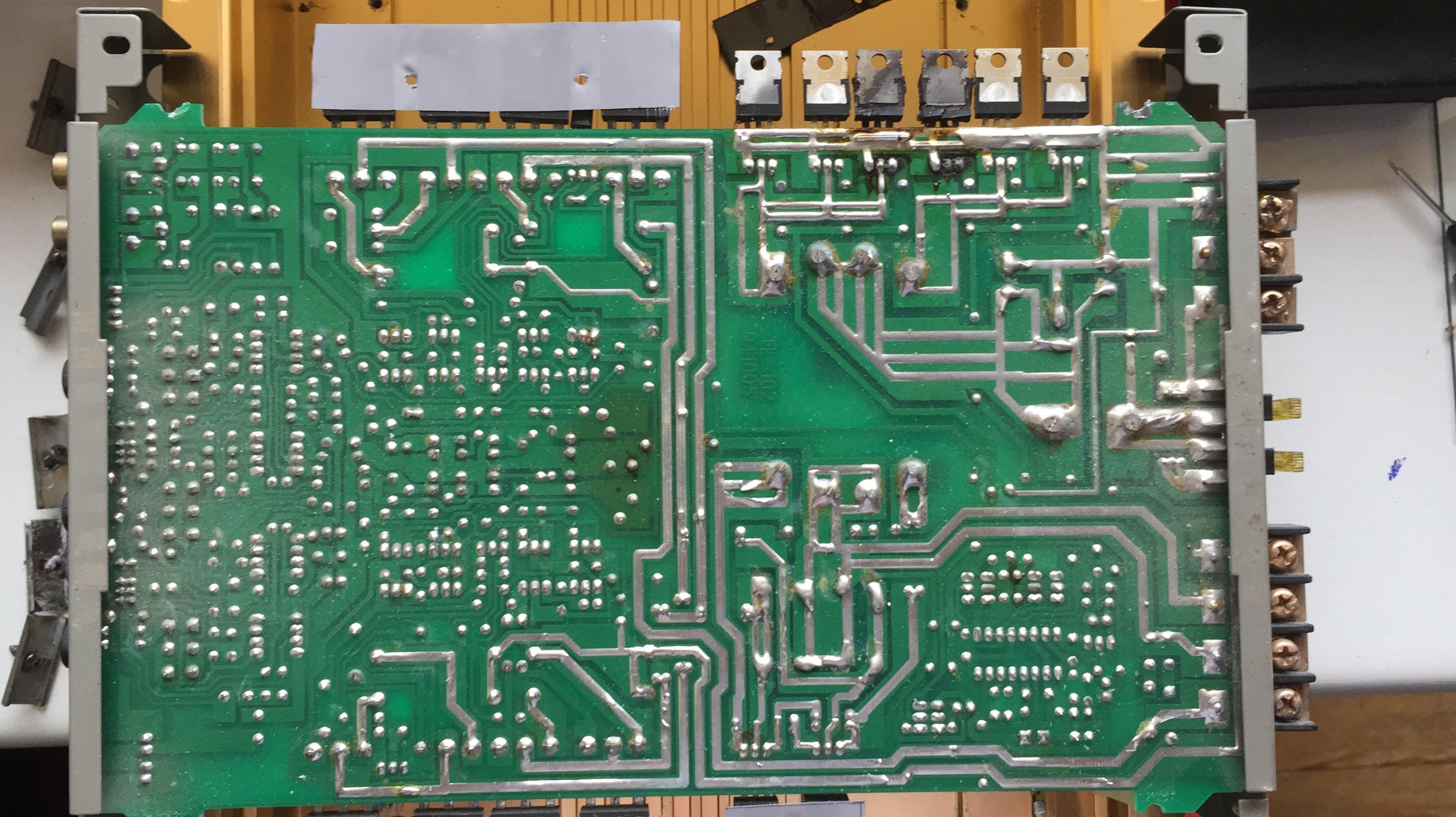

Hello. I found in garage an old amplifier. Opened it and saw that all of IRFZ44N transistors is blown up. I replaced them, was ready to test it. Connected amp to battery and after 1sec 3 of 6 IRFZ44 transistors blow up again. I dont know ehat is wrong. I tested others transistors and they seems to be good, if i test the them correctly. Thanks!
When i try to power amp with psu, the psu turns off immediately, it means that somewhere is short circuit?

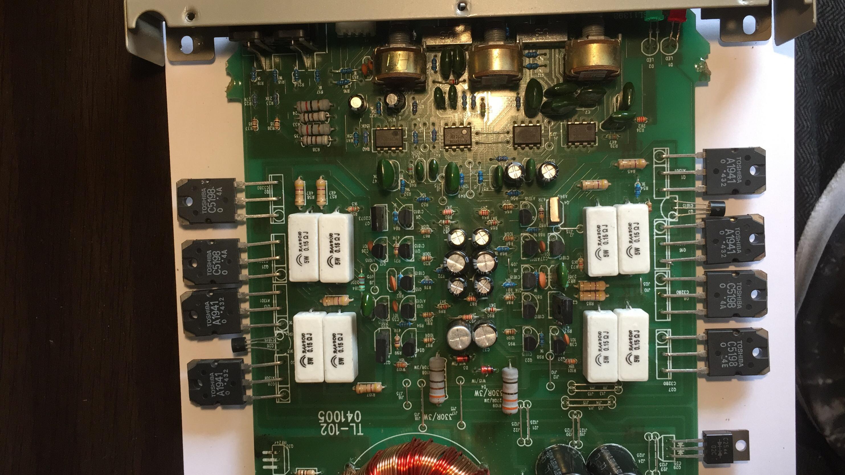

For the group of 4 transistors including Q37 and Q40, find the two that have their collector terminals connected to ground. Pull those two and check them (for shorts AND for open junctions). Do NOT apply power with those transistors out if the circuit.
Thanks! Q40 is faulty, there is short. Will need to replace it. Now my amp need to be working again? Thanks again.
Generally, a shorted PNP transistor won't blow FETs. It will, however cause the complementary NPN transistor to open. Check the other PNP for open junctions.
i tested Q38, its the same transistor (A1015) i think its faulty too because multimeter shows 0.99V when i tested it. So i found 2 faulty PNP transistors. In picture can see these 2 faulty transistors where is square. So they can or cant blow up that irfz44? Sorry if im wrong. Im 18 years old guy who want to repair and study new things.
I'd replace all 4 of those driver transistors unless you can be absolutely sure that the NPN drivers are 100% OK. All 4 drivers have to be in good working order. If any of the 4 are defective, it can cause the power supply to be unreliable or to fail shortly after power is applied.

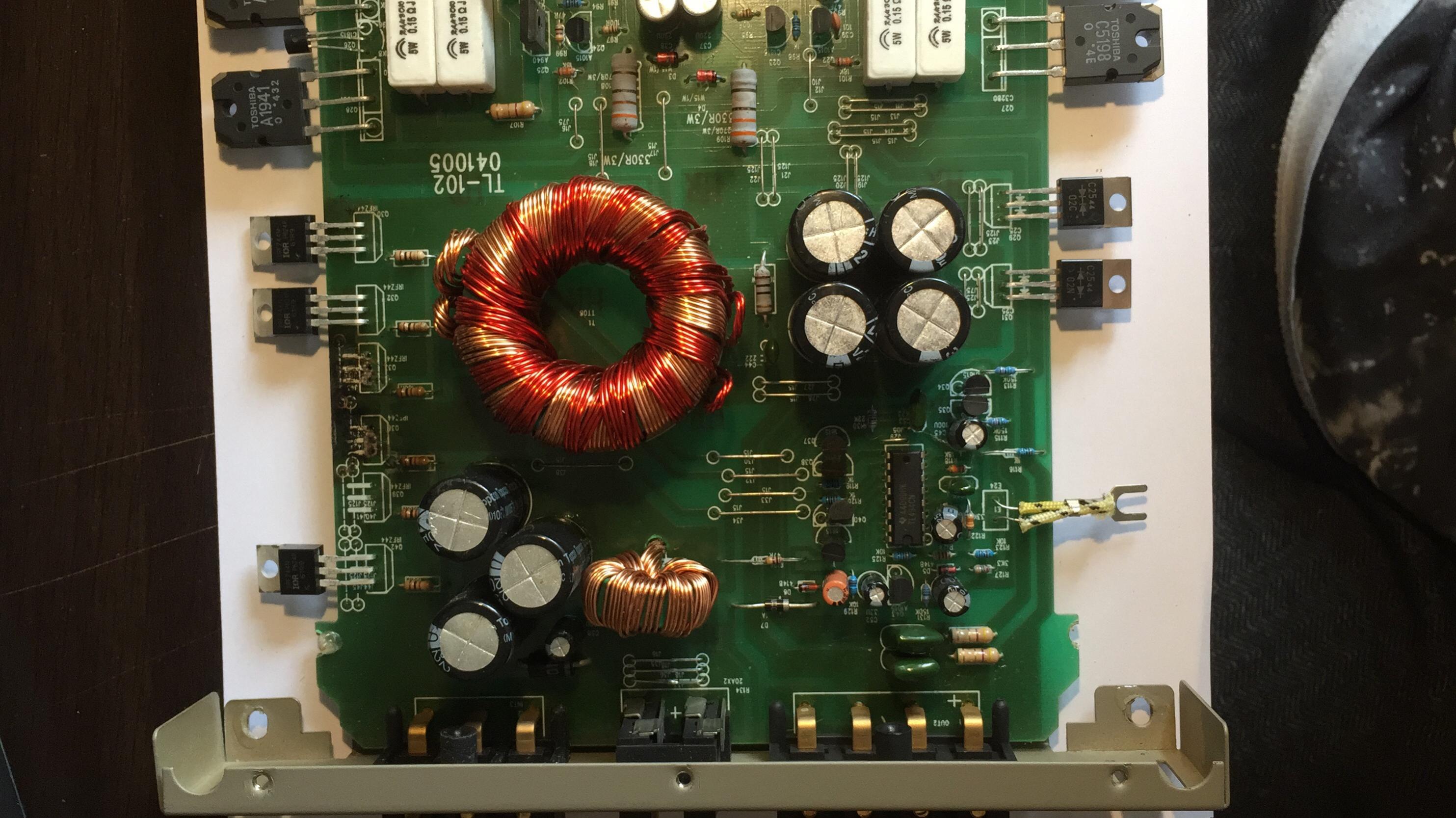

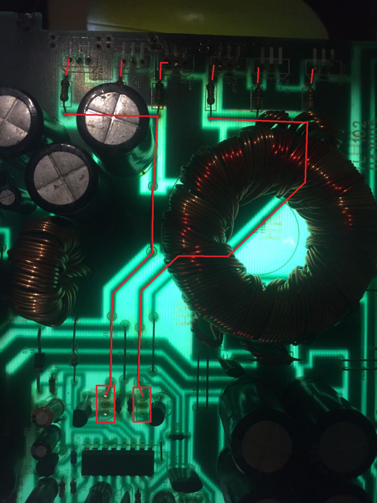

this is the cheapest amplifier i saw till now. when i looked deeply i saw that there is no gate voltage limit resistors. and the TL494 is connected directly to the mosfet drivers. i am pretty sure that the TL494 internally short

Most likely the main cause that at the beginning he did burn the old IRFZ44N, are definitely one or more output transistors which, in the short time, have put serious effort the internal power supply unit, doing warm up excessively IRFZ44N that eventually they have succumbed.
My advice is to do a real test:
Take note of the location of all of the output transistor; you will need to temporarily remove them all.
After removing all of the output transistors, turn on the amplifier.
If the amp turns on properly and the new IRFZ44N not heat up, it means that there is certainly some output transistor shorted (that may have also caused other types of damage, for example, the driver stage of the short-channel or the differential stage).
We have to go step by step, but this is already a great step, because it allows you to figure out if its power supply has a problem or not!
