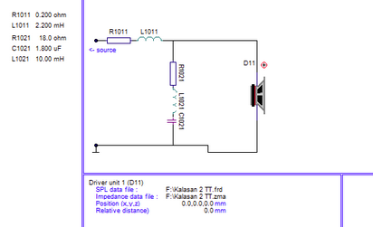

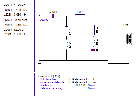

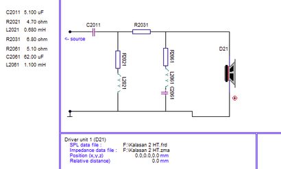

Interesting. Joachim redesigned for the 8 ohm bass and called it the Kalasan 2.

I think his final version was kalasan 5?
Well, the LATEST version!
http://www.diyaudio.com/forums/vendors-bazaar/220330-sb-acoustics-satori-monitor-70.html#post3854756

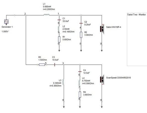

Gornir does the 4 ohm bass version here with a different tweeter
www.audioexcite.com Satori Two – Monitor. Last below.
Joachim gets excited about his 8 ohm Kalasan 5 bass version. Below with some midrange dip.
