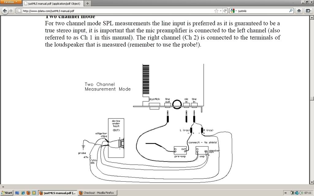

Could someone double check that I have my connections right ? Also does anyone know where the light blue cable is supposed to go ?
Guessing that it's CH 1 output on the mobile pre, but it's really whatever the software is set for. Whatever output gives you the test signal, use that one. 🙂
I was half asleep when I was drawing this out last night. Assuming all the connections are going to the right places - 2/R must be the output (CH 1 in an input)
I only wanted to know so I could order the correct cables. for some strange reason I was thinking 'Stereo line' could have been the output (both channels).
EDIT: Thinking about it some more - I'm still not sure 🙁
And here's the M-Audio Mobilepre connections:
