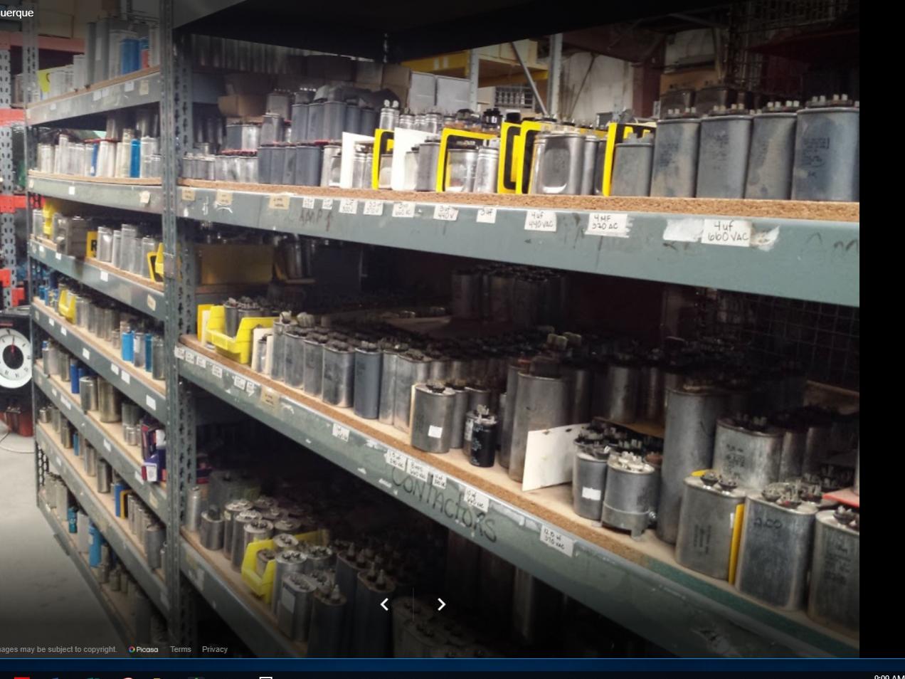

Hi All. I went to a surplus store yesterday and way in back they have rows upon rows of PIO caps (a couple as big as a trash cans). Do PIOs go bad? If so, how would I know? Cheers.
PCB based insulating oils are safe unless the capacitor is dismantled and if so then becomes hazardous.
They are perfectly safe in motor start/run metal cases.
....may contain PCB's

I use old PIO caps in my GM70 SET amp and I always assumed, like you said, they are fine unless leaking.
Just like asbestos/concrete blocks, if the contaminant is contained, sealed box for capacitor and paint for asbestos, there is no hazard.
I have lots of that type of capacitors.
But all of mine have the following printed on them: NO PCB'S
I have seen earlier caps like that, but I did not purchase them because they did not have that statement on the cap.
Just my preference.

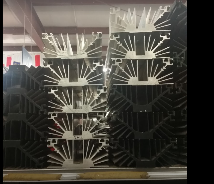

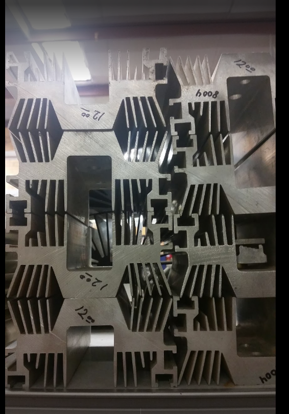

To bad that surplus place is so far from me - I'd like to get my hands on some of those heat sinks.
The heatsinks would really interest the builders at the Pass forum.
https://www.diyaudio.com/forums/pass-labs/

If I'm not mistaken, I think that modern PIO caps must state on the can that no PCB's are used in the capacitor.
I believe the Law is 2 parts:
No PCBs are allowed in caps manufactured today.
"No PCBs" must be stamped on the part.
Are there any law breakers?
Only the manufacturer knows.
The paper in PIO caps can break down over time. Most old PIO caps I've tested are defective to some degree and I'd never buy NOS PIO caps.
