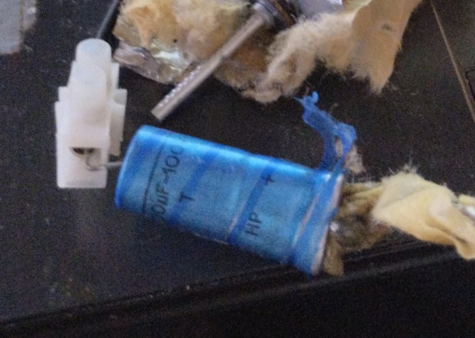

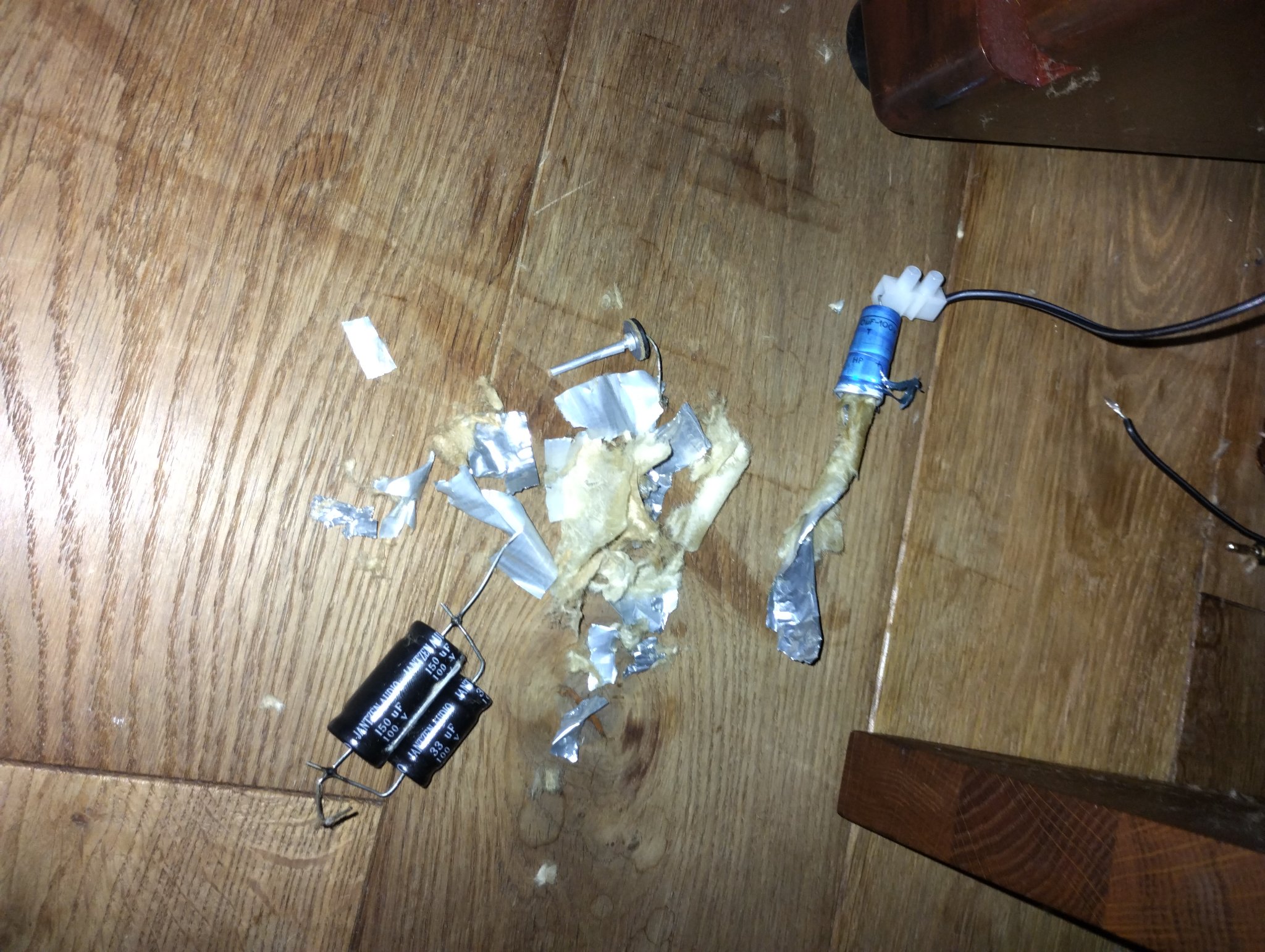

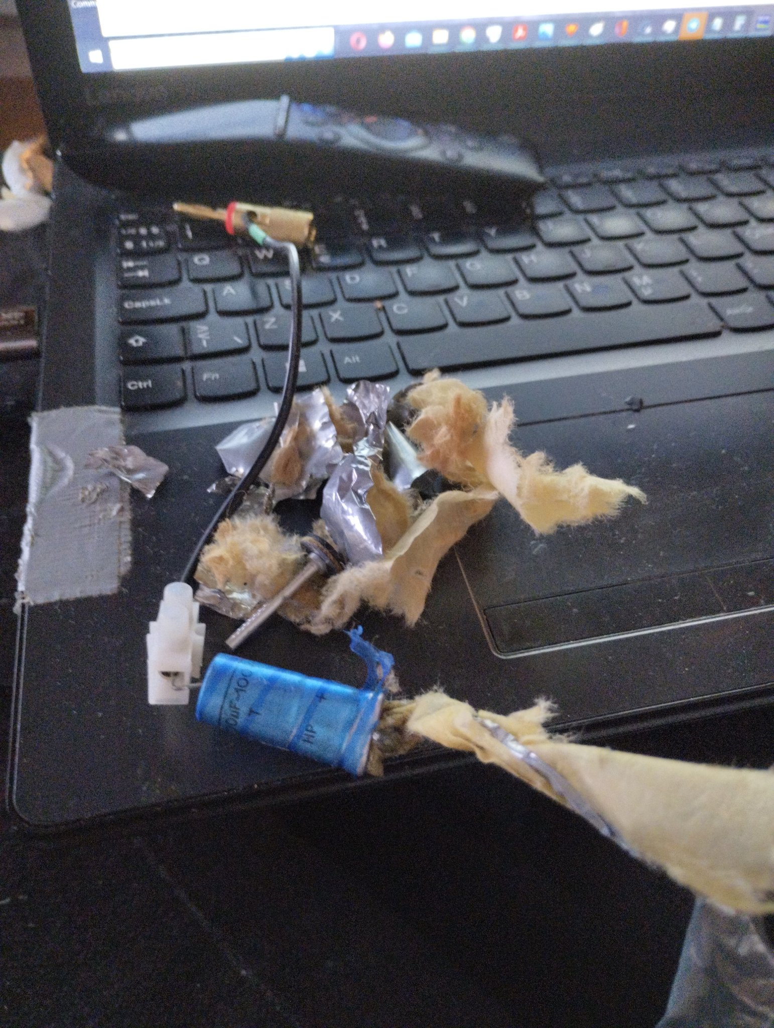

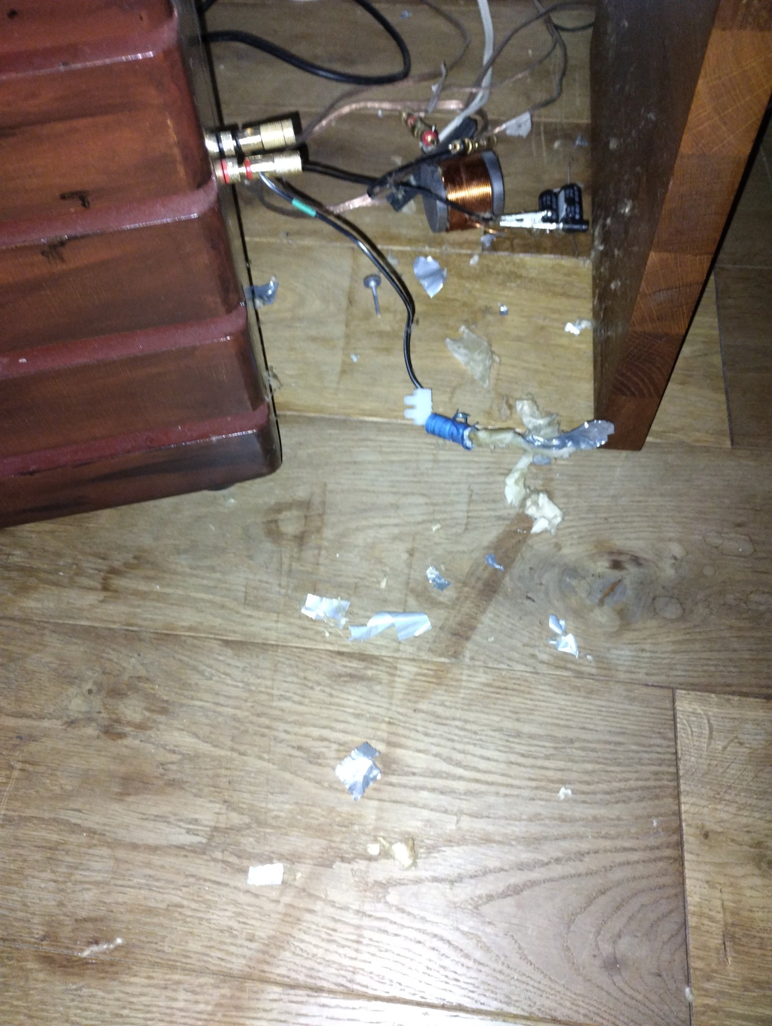

Used R.E.W to soften spiders in my Dayton 390ho.
All went fine first minute, then A BANG, and some caps explode!
To much power
What do you meen? by that?Sounds more like too much flop and back EMF...
Yeaa, was like a granade!... **** my paintsWhoa, went from "a cap" to "some caps"??
The easiest way to do that to a cap is with too much voltage. Best to burn in speakers raw in free air or smoke is easy to make
OK..... The Philips was a really old one, but you´re tempting/inviting "Murphy" to visit you,
when using polarised cap´s in a crossover. That´s why you have non-polar/bi-polar 😉
