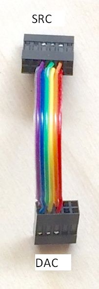

If you okay with dropping the connectors, then proceed with:
1. Solder a ribbon cable directly to the PCB pads
2. Scratch the PCB GND layer along the connector
3. Attach the copper foil tape to the cable, solder it into the PCB "pad" you've created in 2.
Something like this (on the right): http://s3t.it/data/uploads/dac_1541_v014_release02.png
It produces circa 90ohm line, so your resistors should be ~70R (taking into account some 10-20R output impedance of ICs).
Alternatively, do the same with a ribbon, but connect every odd wire to gnd _directly_ to the PCB GND layer (don't follow Eldam's pic, its kinda better than single GND wire, but much worse than proper GSGSGSGSG connection).

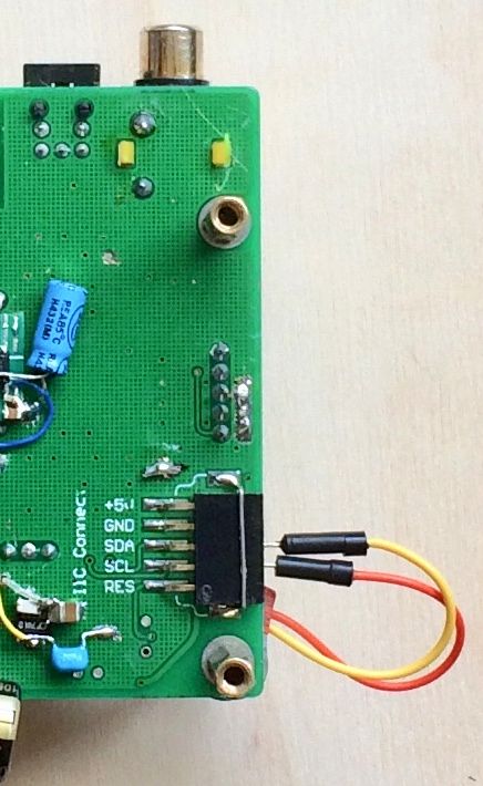

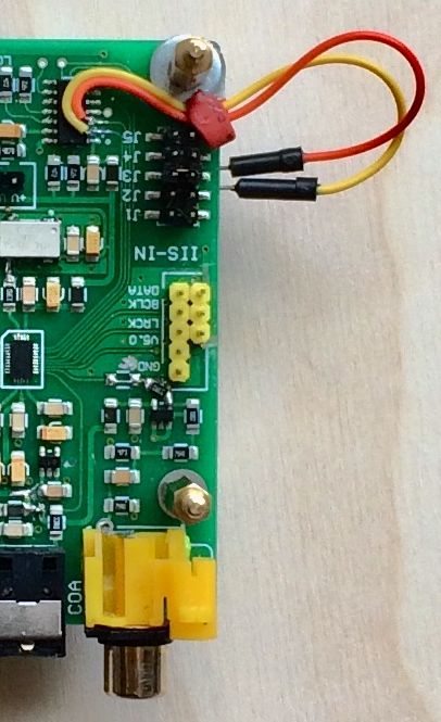

One way to do it can be seen in pics below.
