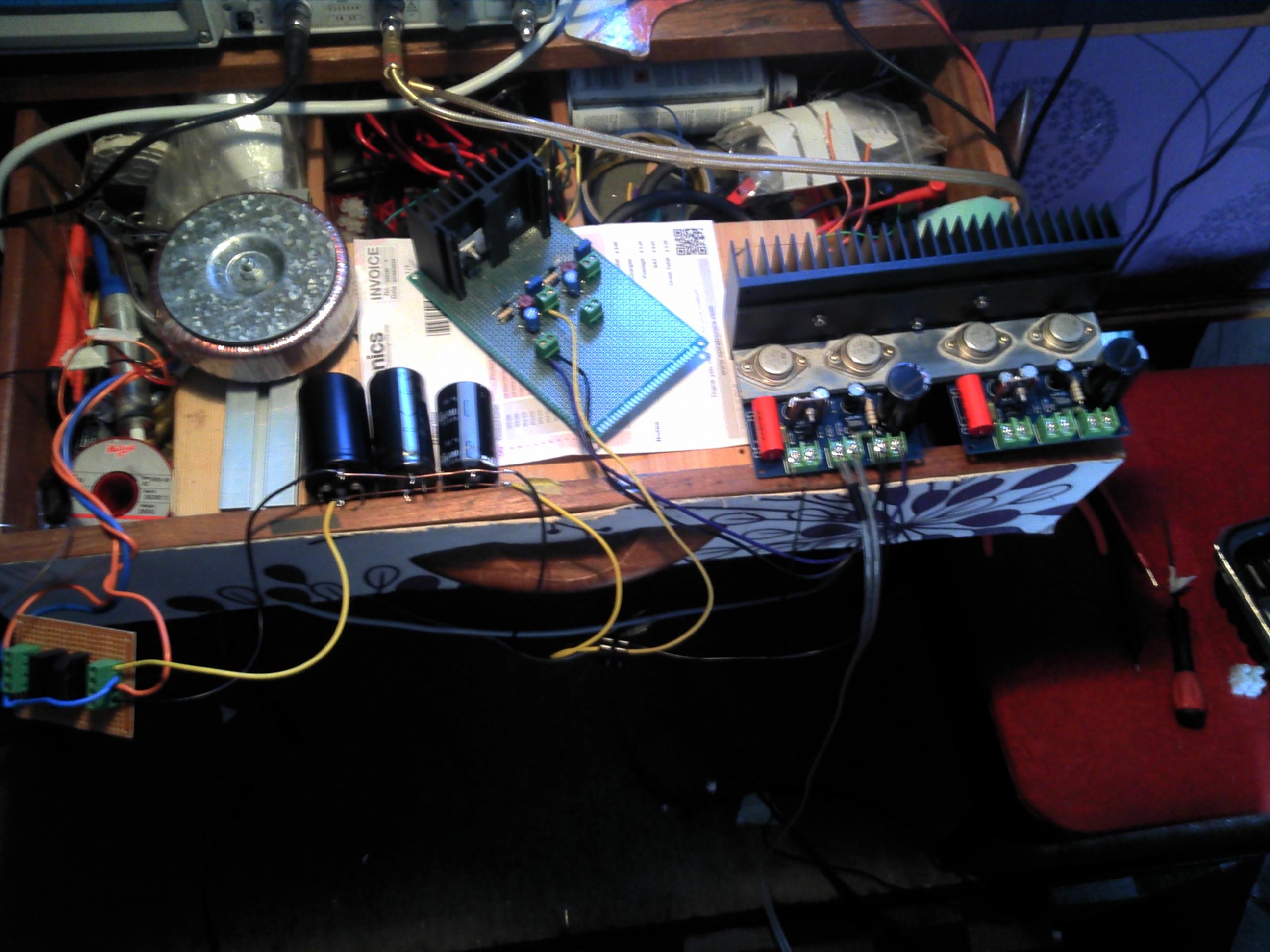

I have just built this jlh kit from ebay.
2pcs JLH 1969 A CLASS A amplifier kit sc | eBay
Its sounding ok its a great quality kit for price.

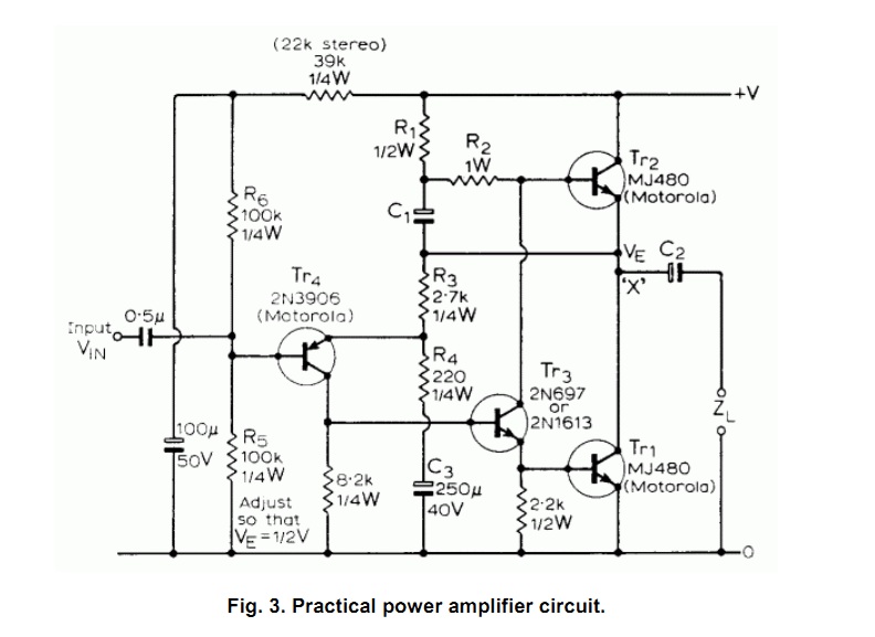

I have used the supplied 2n3055 ,but I have a pair of original motorolla 2n3055 and was thinking of using them .
I understand although it uses 2 per channel one is acts as load? and other is the one that amplifies.
If so which one amplifies as I am thinking of using the original ones I have.
I have 2 of these kits so I can see which sounds best.

I'm not sure if it's worth swapping the parts, but if you do it's recommended to use the one with the highest performance for TR1. The best performance might be the parts that came with the kit, I can't say. If you have an old milt-meter with an hfe test you could measure the devices and us the ones with highest hfs (or 'beta' = current gain) for TR1.

That is a good site. I am using an unregulated 30,000uf psu at moment as I have tried to build the one using lm338 on that class a site but I am having problems .
I have destroyed 2 lm338 !!with 2 different circuits.
I thought Tr1 was the one as its runs at 113c and tr2 78c

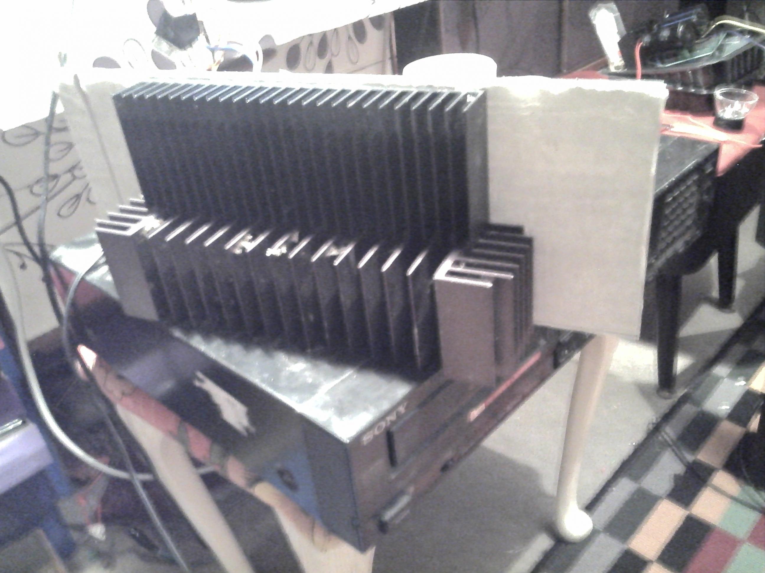

I am hoping my heat sink can handle it when I power up the second channel !
No chance - that heat sink must blister your fingers already with one amplifier running.

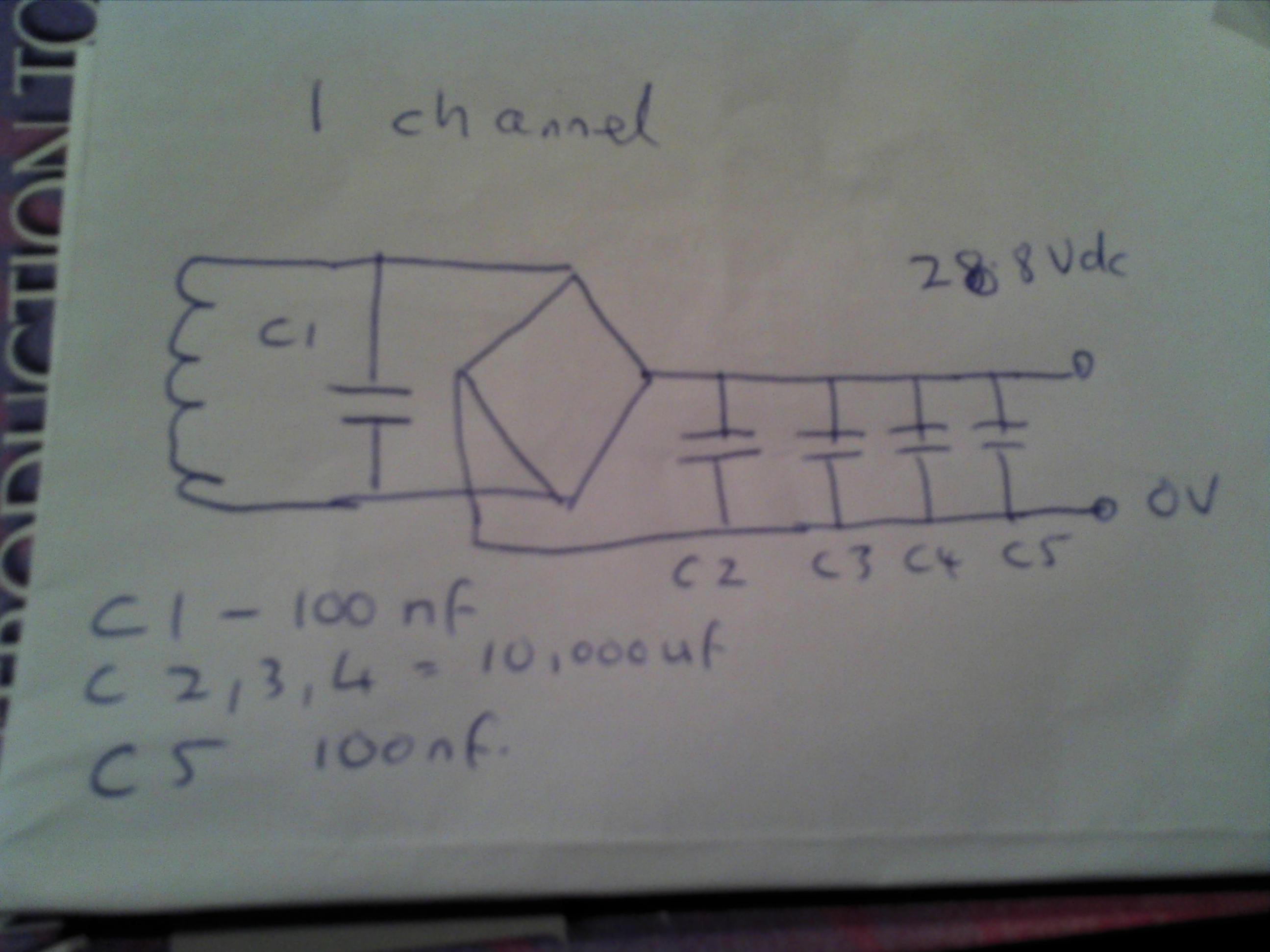

Andrew my unregulated psu is a single ended .
I have a 100nf across the ac going to bridge ,3 10,000uf in parallel then another 100nf after them then it feeds amp.
I am still wanting to quieten the hum though.
You could insert a low value resistor before the bridge rectifier.
That might attenuate hum a little.
You can also insert a low value resistor between cap1 and cap2 of the PSU.
Don't add a resistor after cap3, nor between cap2 and cap3.
A 1Vdrop across both resistor might be about right, i.e. for 1.4Adc passing to the amplifier a 0r33 + 0r33 would drop ~924mVdc
If that seems too much to lose, then you can substitute an air core inductor (for the Cap to Cap2 R) with a lower "r" try 100 Turns in 10layers 10Turns wide on a 15mm to 20mm diameter bobbin
1.2mm diameter enameled copper will give a resistance between 0r1 and 0r2

Sorry to say but I also have a suspicion that your heatsink is too small - however, that's just a guess from looking at it. You can significantly improve the thermal situation by arranging for good airflow over the heatsink. A couple of 'silent' computer fans could provide a low cost solution.

I have been out in the rain making a bigger heat sink.
I am recycling as much as I can,its 2 heat sinks bolted to 3m aluminum plate. The amps will be mounted either end horizontally

Looking better - the more heatsink you can use the better your chances it'll survive. You can still add a fan like the KRELL amplifiers people love.

Change C1 from a lonely capacitor to a snubber using a series pair of capacitor+resistor.Psu schematics
Delete C5
