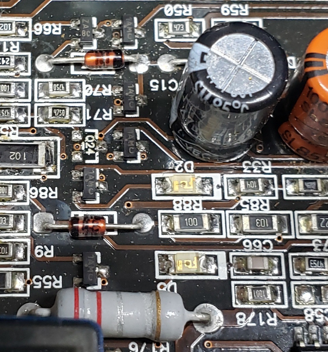

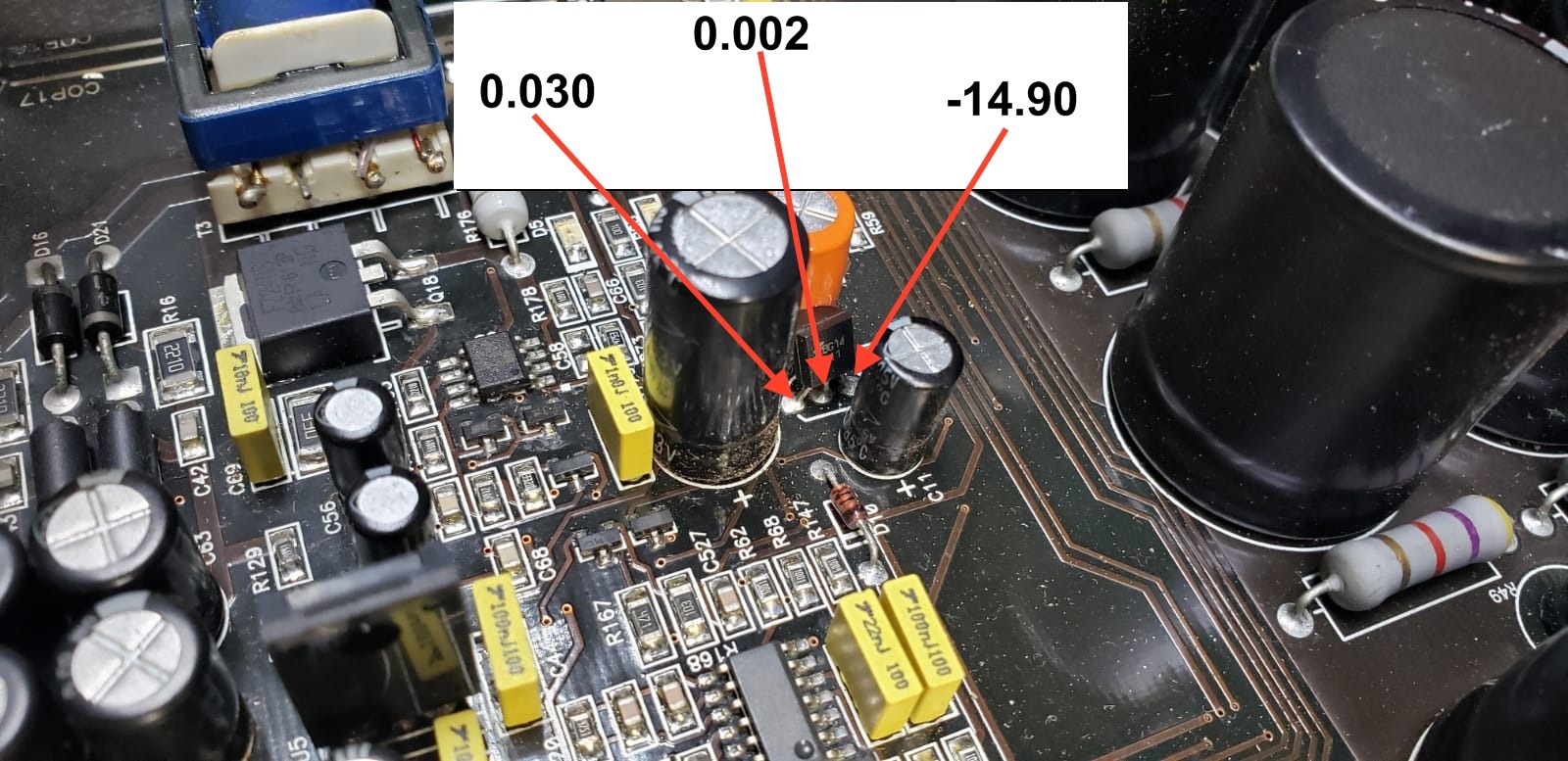

I have a jl A1800 amplifier. I had all the source fets and drivers damaged. I already changed the 3525 one new and one used.
The problem is that I do not have high voltage on the 63v 3300uf capacitors

IS it correct that you have the same symptoms with 2 different ICs?
The same symptom is repeated with the 2 ICs.
I only made measurements with the IC used
