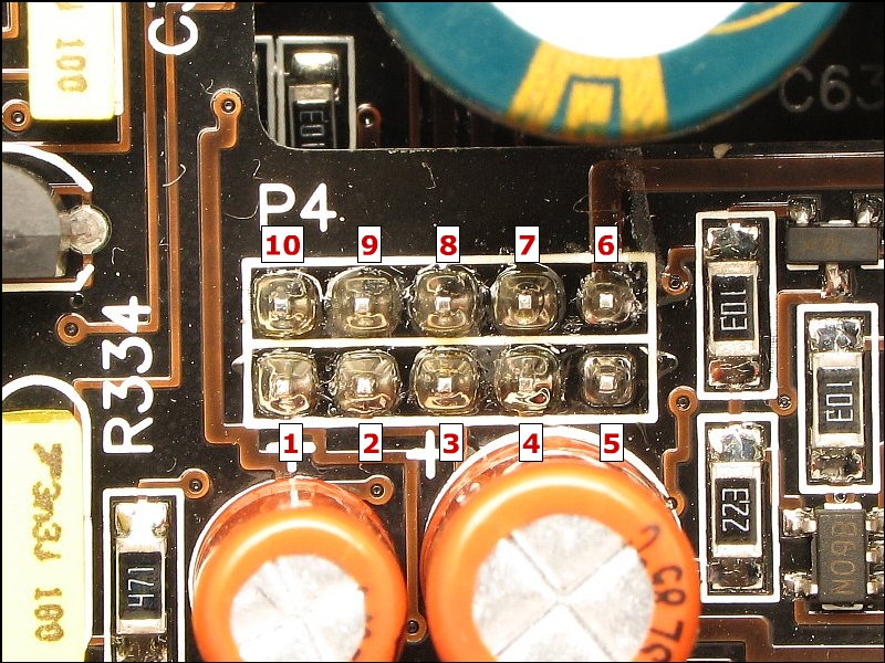

Post the DC voltage on the 10 pin connector after the power LED goes out. Use the pin numbering shown on the attached photo.
Pin 1:
Pin 2:
Pin 3:
Pin 4:
Pin 5:
Pin 6:
Pin 7:
Pin 8:
Pin 9:
Pin 10:

Normal idle current for this amp is 1.5A-1.7A but will draw as much as 3.5A before it settles down to 1.5-1.7A.
If you have the rear heatsink off check output MOSFETS Q504-Q507 IRF540's to see if any of them get warm or hot with no signal and no load. If any do check to see if shorted or leaky. If ok check Q500-Q503 and Q508-Q511. Now if you do have a problem with the output MOSFETS or the output circuit your power supply MOSFETS will get warm or hot but that does not always mean they are shorted or leaky as well.

With the output transistors out of the amp, connect a jumper from leg 2 to leg 3 for Q505 and Q506.
With the black probe on leg 3 and the red probe on leg 1, what is the DC voltage for all 4 output FETs?
