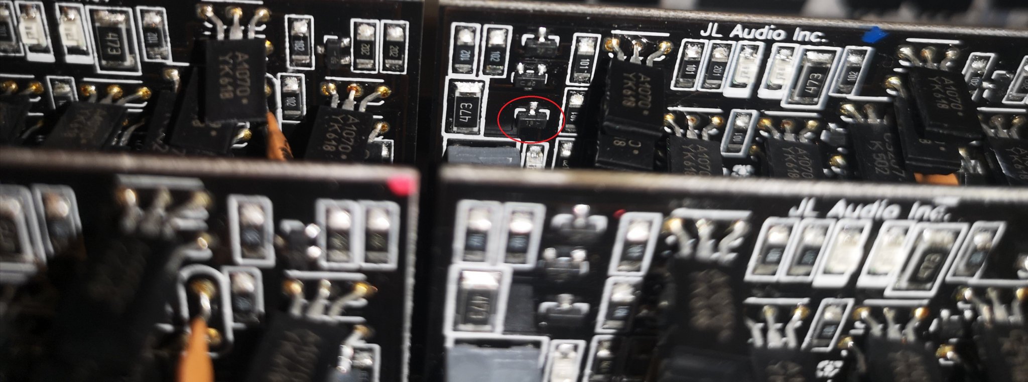

Hey, I have a JL 300/4 with a broken channel, that broke last week. It looks like what's in red is shorted , and have a couple of resistors to replace too that have gone with it.
But I can't find what's in red and can't find anything. I can find what the tops transistor are but this one I have no idea.
Does anyone have any clue?
Thanks in advance

It's look like the BC846B is obsolete and no longer sold at digikey, however, I found those at mouser witch look fine.
https://www.mouser.ca/ProductDetail/Diotec-Semiconductor/BC846B?qs=OlC7AqGiEDkE/6m7W8uUrg==
Is there any other way to know if it's the same on the board? What will happen if it's not the correct transistor that's going there ? Sorry if it's a stupid question, it's just a hobby for me. i'm still having a lot to learn and most of the time i can just know what parts it is with the marking on it.
Yeah I know that's what I've done. Everything is in my cart and waiting to be ordered.

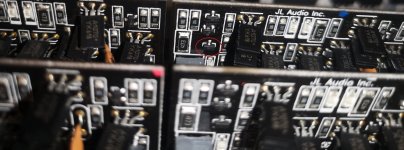

Anyway that's what I found to be defective.
Brown =Bad
Green Good but burned, will be replaced
Blue = Out of spec
If I can't save this board I will see what's less expensive to do.

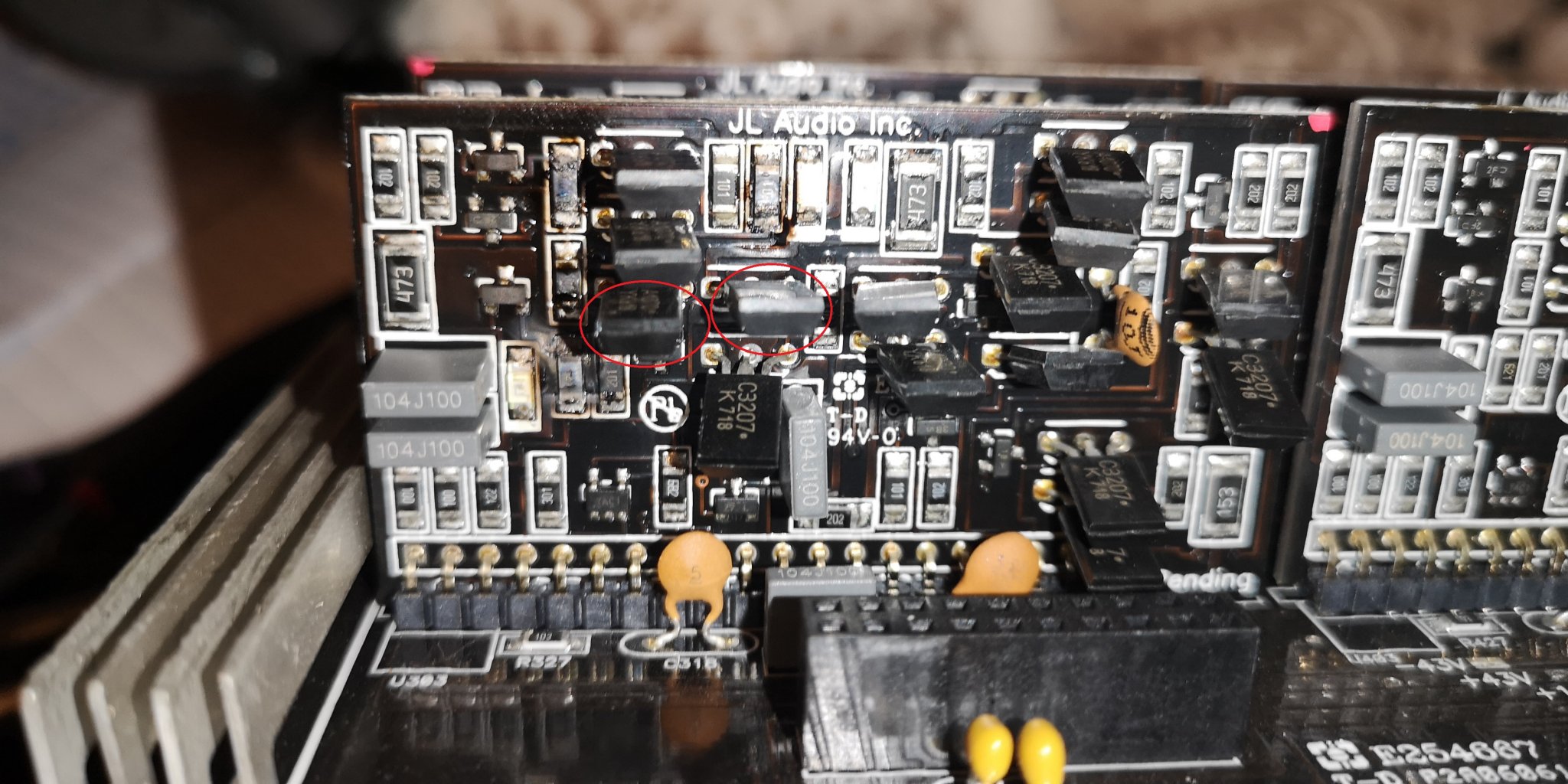

I wonder if it was the 47 k ohm resistor that had caused the other resistors to burn, because now it was O.L but when I tested it first it was like 10k ohm, which is too low and maybe has caused too much current to pass into the other resistors.
After replacing all the resistors and transistors I mentioned above,I realize that there still too much current passing through the same resistor so I looked what I missed, and it's look like the first transistor up left was dead shorted.
So I ordered some BC850B and hopefully this time it will be good.
After replacing all 3 transitsors up left, it still didn't work, but I found those 2 thing to become crazy hot. Do you think they are broken? With my multimeter they react the same as the other 3 board so, I'm not sure.
And in the broken channel with the amp on, it goes from 0 to 5 Dc volts and not stable and when i remove the remote wire it goes straight to 1.5V and slowly goes back to 0 volts in few minutes.
