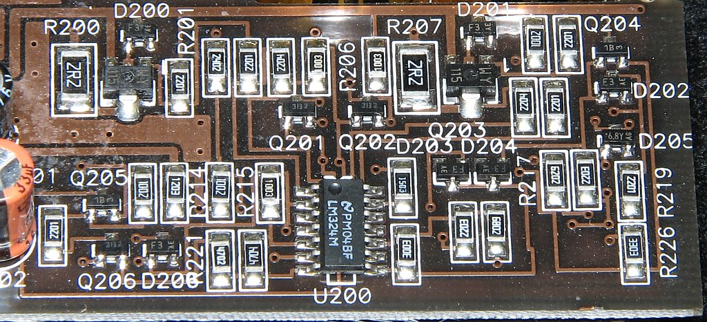

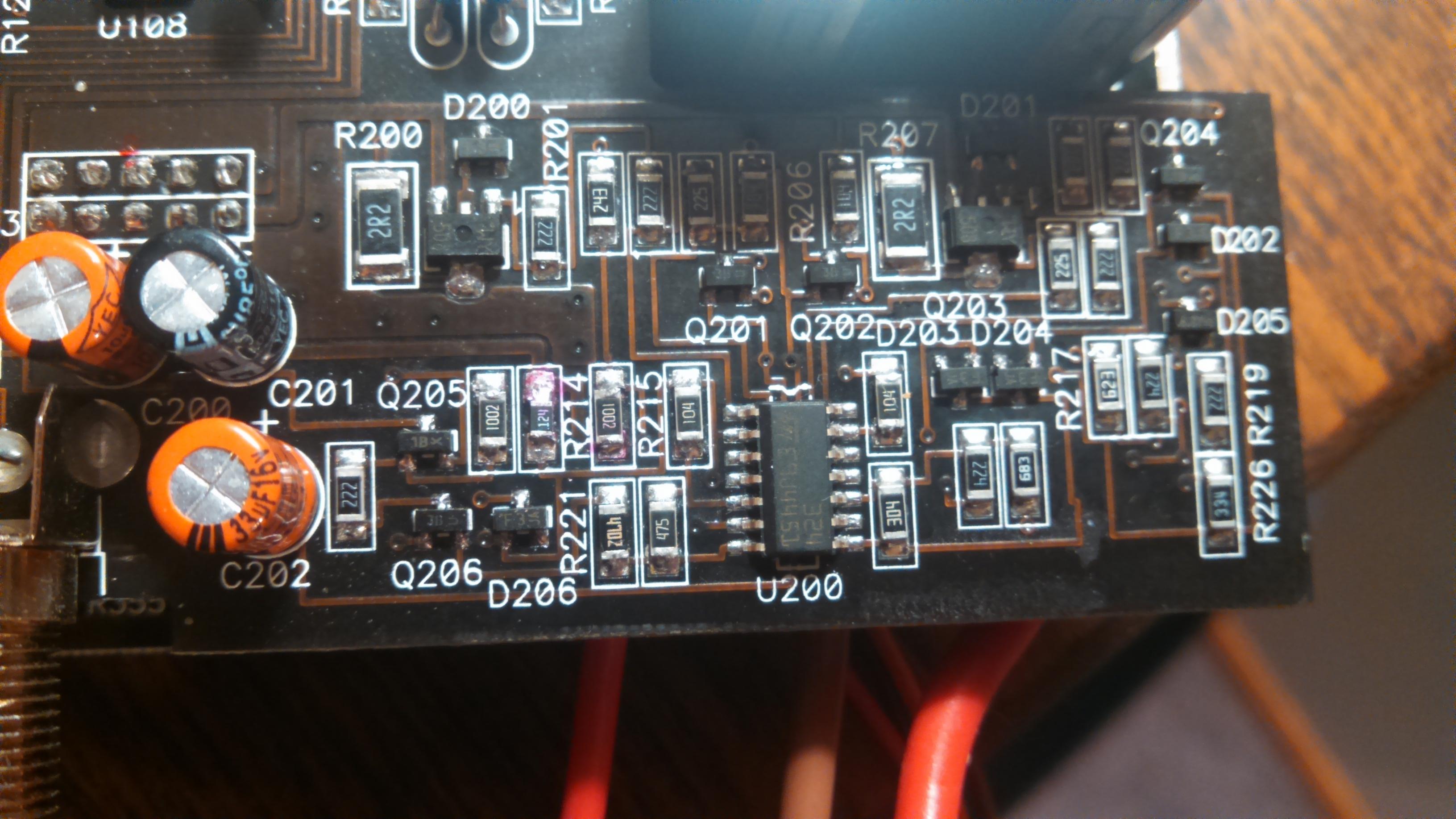

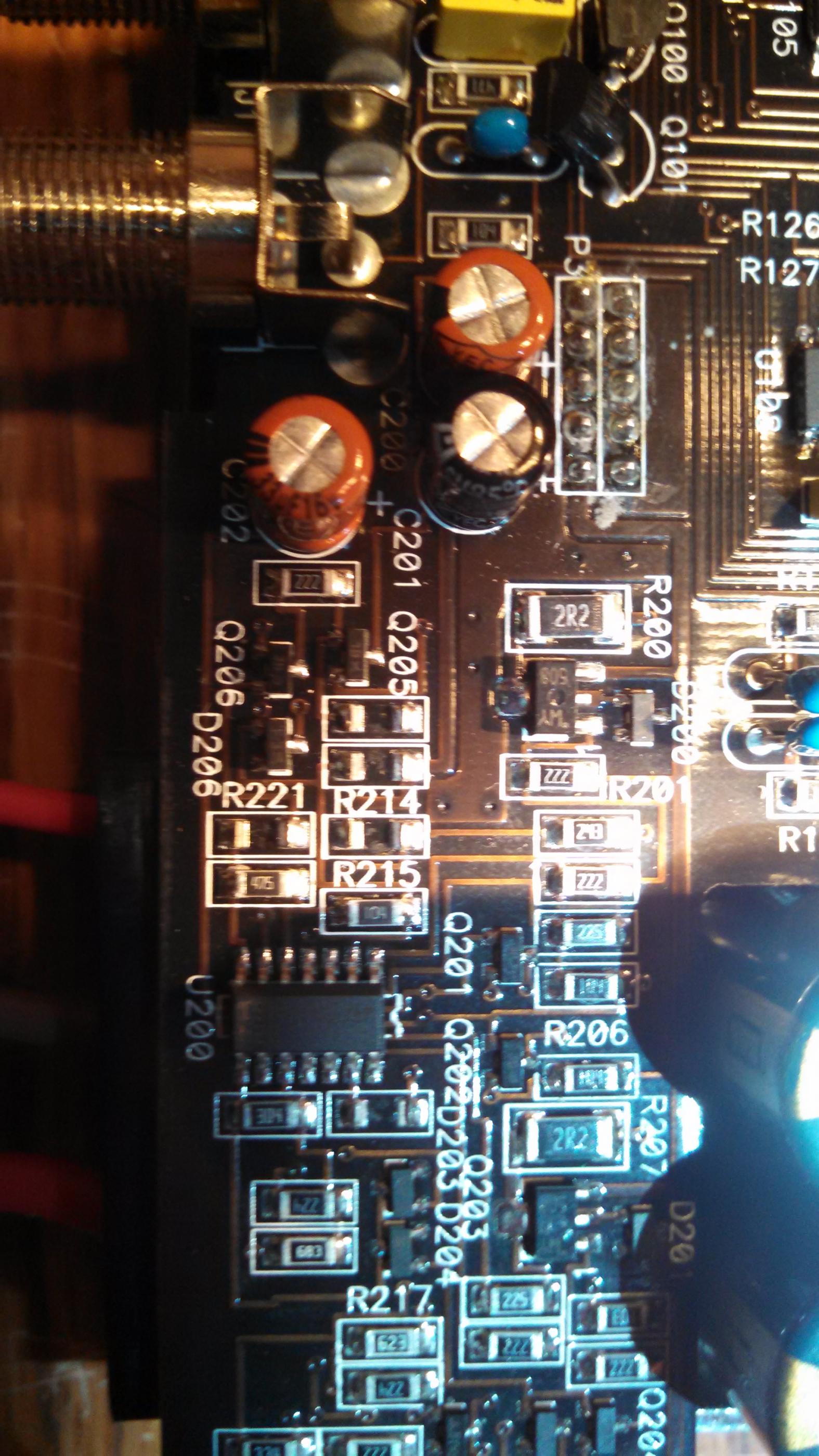

1.The preamp board came with missing resistors.I installed resistors based on photos and using my meter to determine where they go.There's pictures of before and after.Can anyone tell me if there right or post a photo of this area from a jl250/1?
The preamp board is very similar to a 500/1 but not identical(I think).
2.With just power and ground connected(no remote) the amp draws .5 amps of current and the green ON light flashes intermediately.There is also 50vdc across speaker terminals.
With remote,the amp has very low drive voltage to power supply FETs and again flashes the green light.
Switching the signal sense switch doesn't change anything.
I'm wondering if something on the preamp board is causing this due to several missing resistors initially.

I'm off by 50k on resistor at pin 13.Thanks

Are these things famous for bad solder joints on pre amp boards? I turned it over and a resistor fell off.I put it back on,now it won't start up at all.Looks like I'm going to have to go over every solder joint at this point.
Was it one of the lower resistors near the edge of the preamp board? Two of them appeared to have bad connections but I assumed that it was an illusion since you were working in that area?
I haven't known any JL amp to have bad solder connections other than the ones that sometimes overheat (large resistors and diodes).
It was a 220k right beside the 324.When I got this thing it had several missing resistors on pre amp board.They actually look like they just fell off.Nice square edges still in the existing solder.
I noticed when I would hit some of the resistors with my iron they would immediately lift up like the opposite joint wasn't connected.
