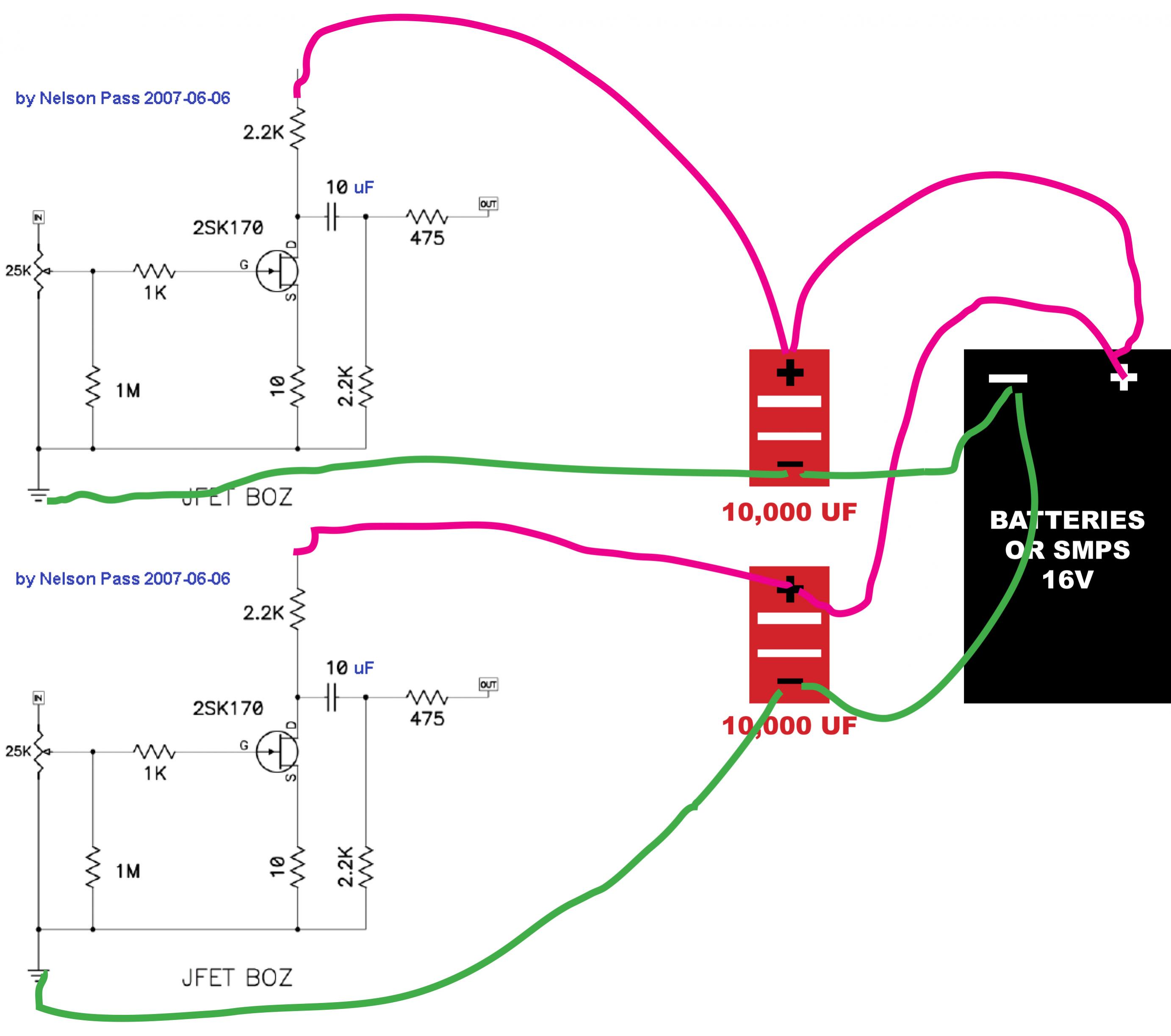

I am trying to wire up a Jfet BOZ point to point w/a SMPS or battery PS.
Does this look like a good way to do it? Do I need the PS caps?

That looks ok. I used 2x 9v batteries.

It would be wise to insert some resistance between the PS + terminal and the caps on each channel. Perhaps 100 ohms at 1W. The caps should be close to the circuitry for each channel. Some SMPS don't like big capacitors (>1000uF) on the output. They become unstable.
